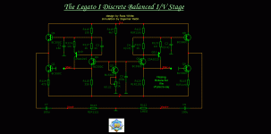

Next question. Since you used 2 Buffalo II modules, obviously the current doubled. What did you end up changing on the Legato module in order to get 1.5V to 2V rms at 0dBfs? It's important to find out what this current is as others who would like to implement a differential I/V stage, whether tubed or solid state or transformer, will need this info to make sure their favorite I/V stage can handle this level of current.

Well this is really good question how Legato is reflecting double current from Buffalo side. In theory this would be 2x16ma about 30-32ma and this is definitely few times more that other “I output DAC” I know. And I/U stage have to be designed to work on that high output current level.
At "Legato or IVY III" thread IngemarR did post simulation of Legato with some very nice results, I will try to ask him about possibility or running his simulation again with double current from Buffalo. Maybe he will find this subject interesting, and we could see how this works, at list on simulations.
As for higher output level at Legato this is of cause the case, output level is higher. If this is interesting for You I can check the real situation with the scope, this actually is interesting.
As for lowering Legato output level, there is very nice "Legato Tweekers" thread if I remember correctly, where this is explained by "the Legato maker" himself...😀 so this could be "the best source" if You wish to do this.
As for me I "like" the higher than standard output levels, but I mod my PowerAmp, I feed directly from Legato, to be able to work with this. And for me this is another advantage of this setup.

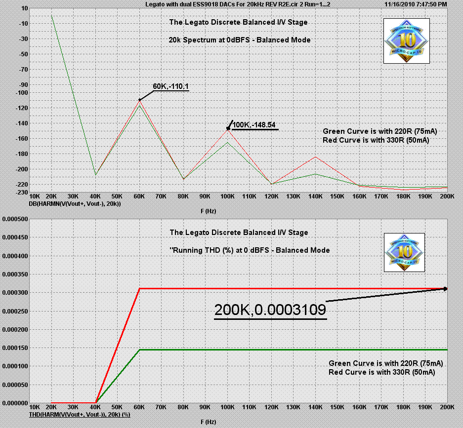

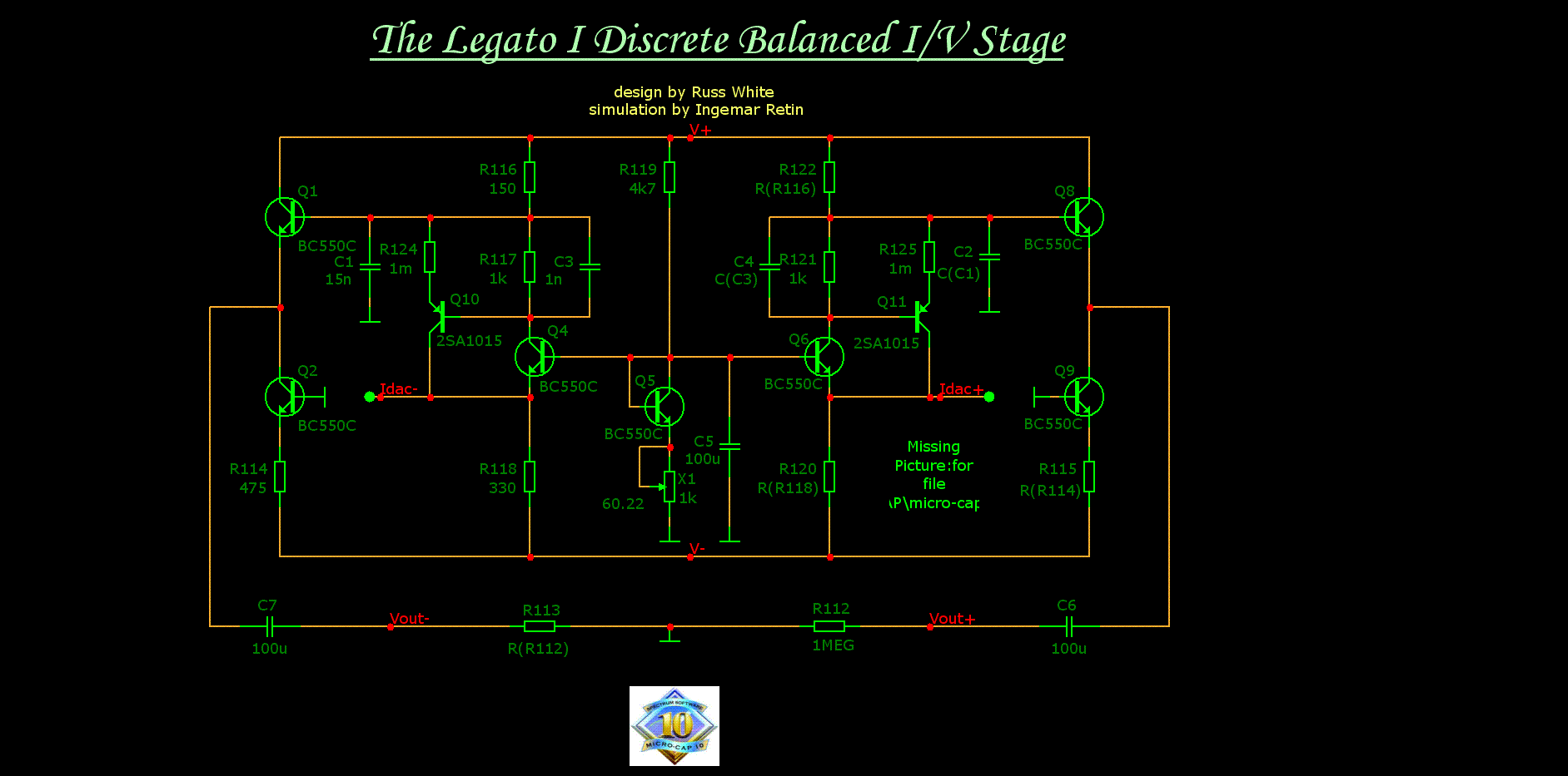

Legato copes quite well with the higher current, but you will want to reduce the I/V resistor.

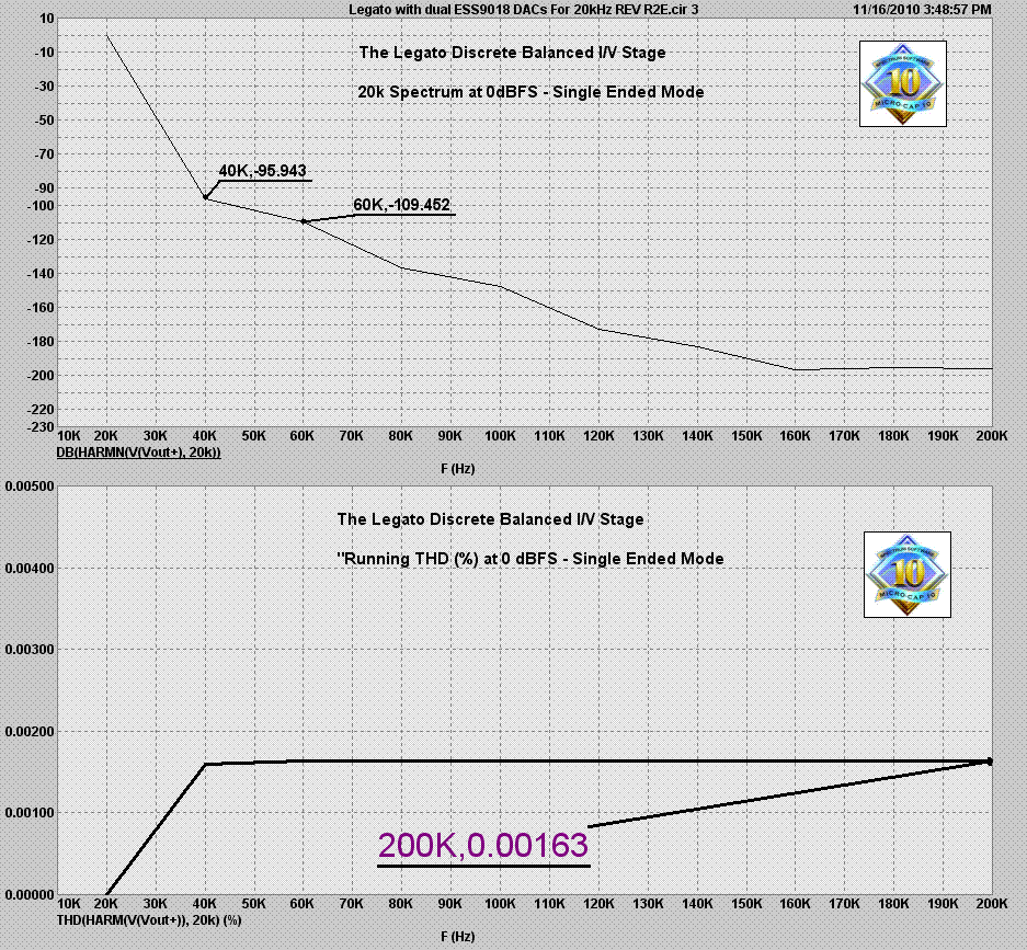

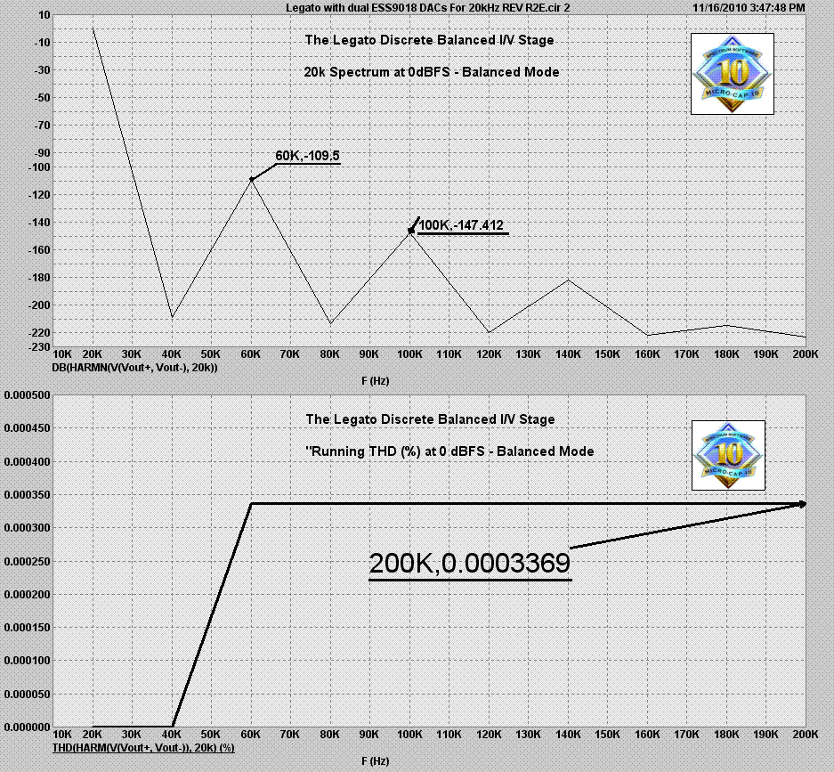

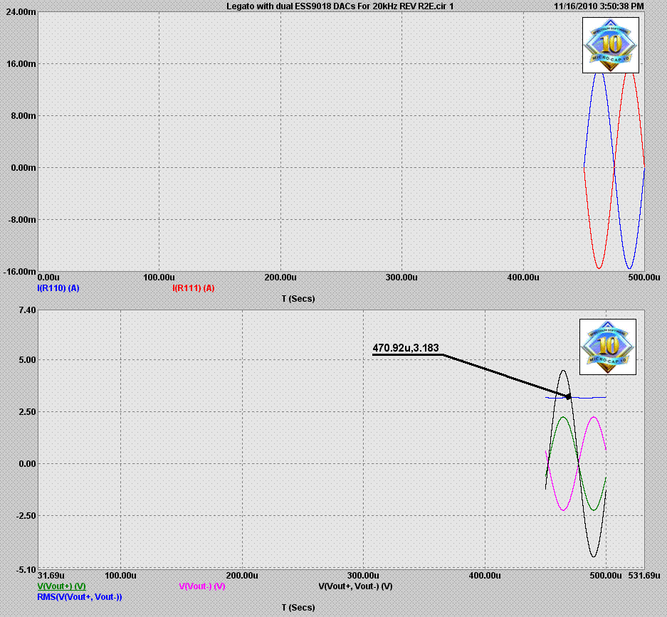

i did a simulation with a Legato driven by two ESS9018, ie the current into the Legato is 32mAp-p AC at 0 dBFS. Fequency is 20 kHz.
My sim of the Legoto with one ESS9018 is here
http://www.diyaudio.com/forums/twisted-pear/166975-legato-ivy-iii-outputs-buffalo-ii-11.html#post2309745
Do note that I did not change the IV resistor as per Russ recommendation. Thus, output voltage is 3.2Vrms.
/IR
Legato with dual ESS9018 DACs For 20kHz REV R2E RMS Bal.GIF41.1 KB · Views: 609
Legato with dual ESS9018 DACs For 20kHz REV R2E Balanced Mode.GIF56.7 KB · Views: 616
Legato with dual ESS9018 DACs For 20kHz REV R2E SE Mode.GIF52.4 KB · Views: 613
Russ,
what resistor value changes do you recommend for running the Legato from dual BuffaloII:s?
/IR
/IR
Cheers!
Russ
Hi IngemarR
Thanks for Your post ..!!
Your simulations are very interesting...
Please correct me if I'm wrong but it seems that for
lets call this: normal stereo mode with 16ma input current at Legato the simulations results are absolutely much better.
The 3-rd harmonics, 60Khz with normal stereo mode we get -125,6dB and at Dual mode with 32ma input current at Legato there is -109,5dB this is like 16,1 dB difference.
And THD at normal stereo mode 60kHz Up is 0,0000772% and with Dual mode 0,0003369%.
So it looks that we get signal level up, but we do loose pretty much on distortion..having higher signal level.

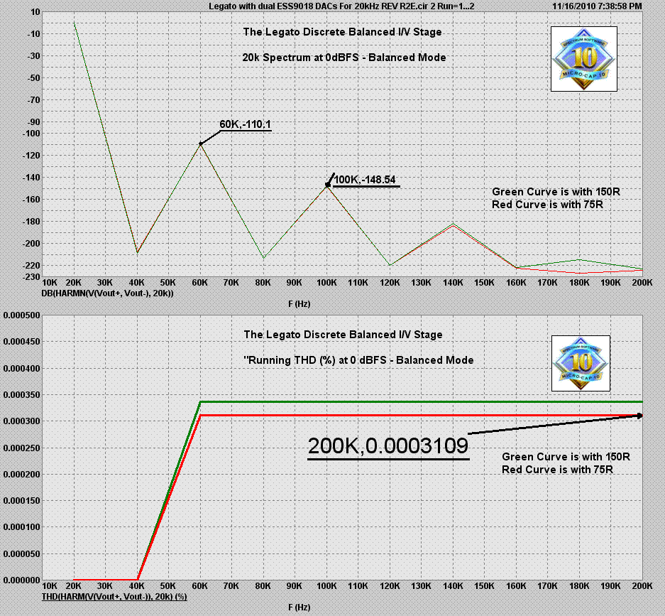

If you reduce the I/V resistor by half you will get much better performance.
The reason for the increase in THD is the much larger voltage swing at the output.
You could also increase the static current by reducing the 330R CCS resistors. But that may not be necessary or desirable.
Here is where using the parallel mosfets will get you the extra mile. 🙂
I do agree though that there is little if any benefit to running 32ma into Legato. It would be a bit better two run two Legatos much like the IVY-III.

Here's a comparison between 75R and 150R as IV resistors with dual Buffalo driving Legato 1. Hardly any difference in my sim.
This is at 20 kHz as earlier, and I think it is excellent performance.
/IR
Hi IngemarR
Could You make simulation for single ended output and if possible also output without the buffer, so we can see if this is making any difference.
60kHz 3-rd harmonics at -110dB is absolutely great resoult ...😎 but I'm bit puzzled why there is so big difference against normall stereo version @ -125,6dB, specially that it seems that this is not simply corelated with higher output level.
And any chances You could run Your simulation on "parallel mosfets" Legato 2 version....?
