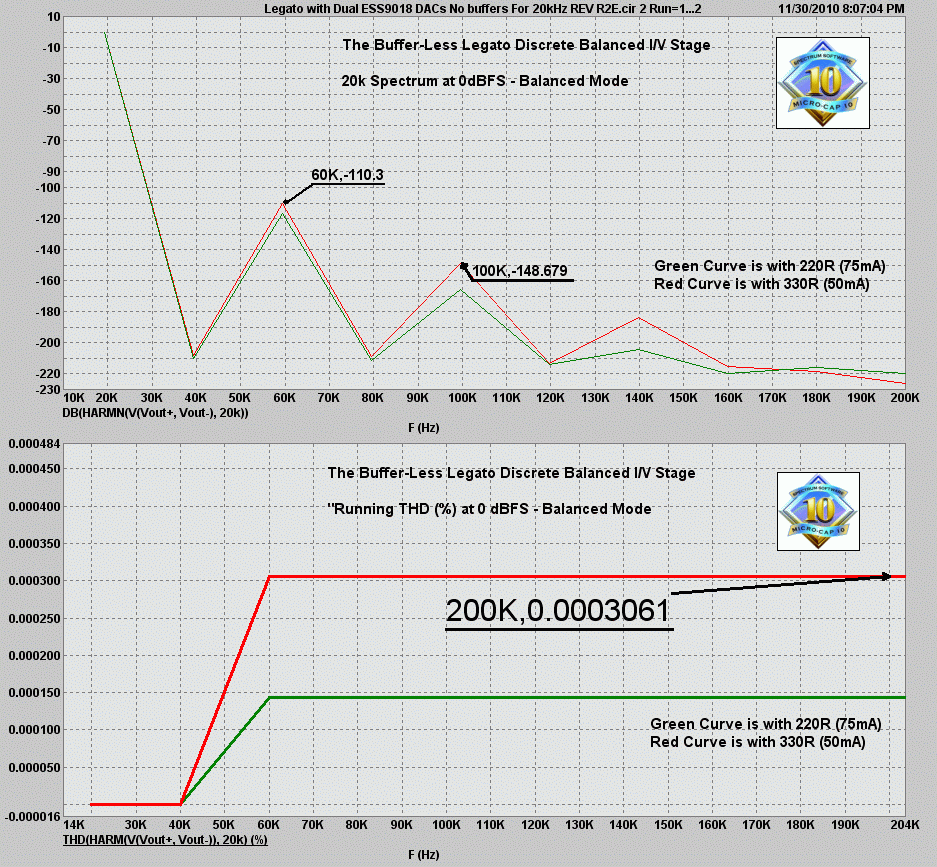

When I look at the spectrum of the MicroCap10 simulation I did on
the buffered and buffer-less Legato 1, I see that 3H (60k) is
about the same at -116dB for both the 75m and 50mA currents..
So, maybe you missed this?
/IR

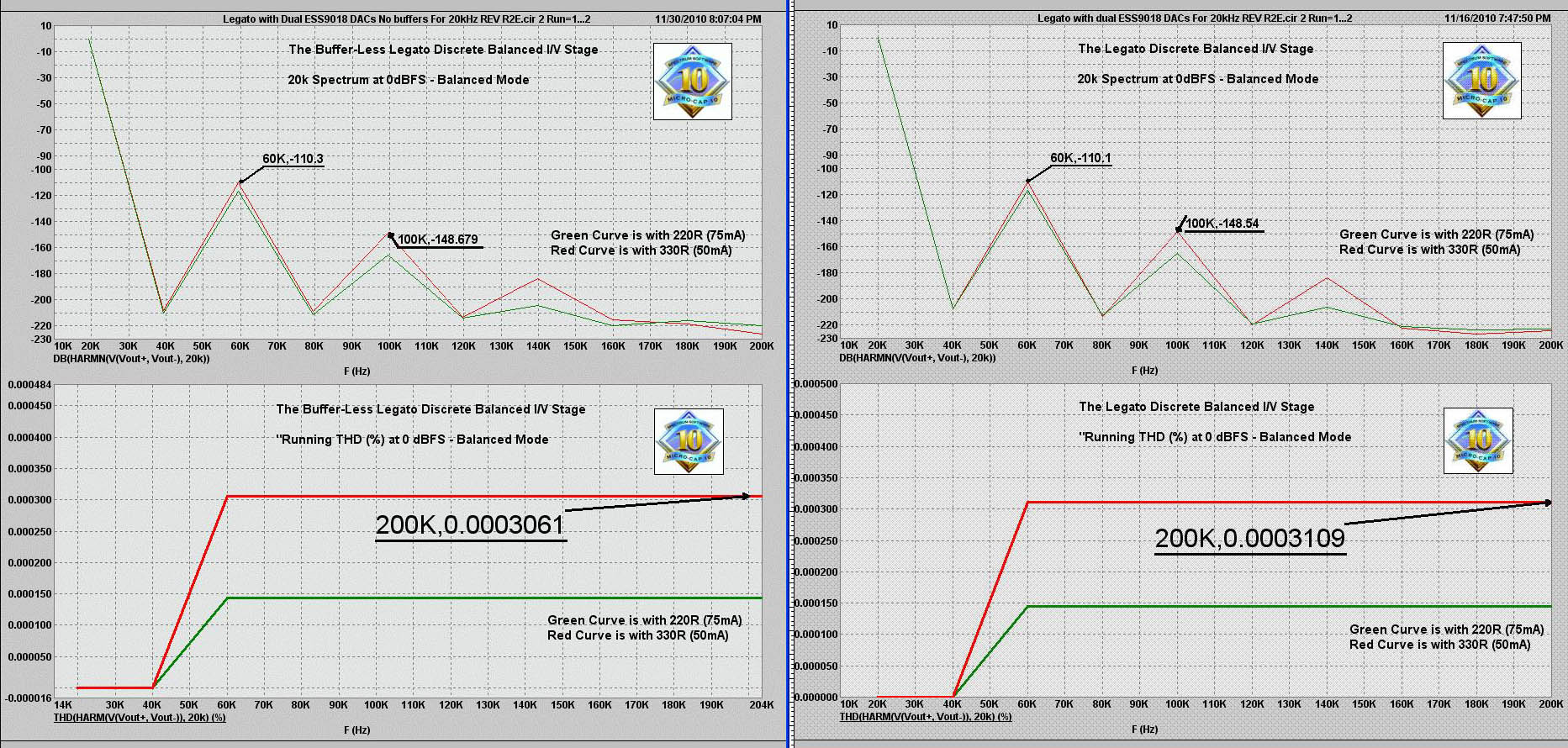

Hi IngemarR
First thanks for Your simulations...
I have to say that thanks to Your and Russ input this simple thread did turn into "new dimention"...definetely much more interesting...
Legato now has many incarnations .....
But I have been looking at Your Buffer Less Legato 1 simulation and comparing to Legato1 with Buffer and THD for 3H - at 60kHz changed from -110dB to -116,9 dB .. and totall THD from 0,0003109 to 0,0001432 and this could explain why Russ is telling that when not needed it is better to go without Buffer....
But why this change is only at 50mA CCS standing current, R=330 RED Line?? and almoust nothing or even worst resoults for 75mA, R=220 Green Line..?? . Any possible explanation ... Or do I miss something..?
For both sim I/V R is 75Ohm...

When I say that your measurements include BOTH distorsion from the ESS9018 (Buffalo 2) and the Legato 1, am I then correct?
Did you use the buffer on the Legato 1?
/IR
Hi IngemarR
Yes You are of cause right I even would say that my measurments include even more of distortion sources .. and I would say that probably Buffalo is not the main one.. that's why I was realy suprised that even with this far from beeing perfect measurment setup I could see the effect ....
And Yes the buffers have been used....
That's why I asked about symulations without the buffer...as I wonder if they play any sygnificant role in generating THD...

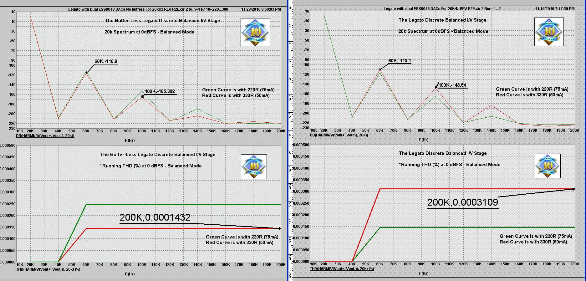

Well I'm confused....😕
Please have a look at attached screens from Your measurments, I'm refering to......
There is ...3H (60k)/ -110.1dB - Red line 330R 50mA @ Legato buffered ..
Rosendorfer

The result is not at all unexpected for me, it is likely the BAL/SE stage that you are really seeing. 🙂
You would need to omit the BAL/SE stage and measure the balanced output directly to see how the I/V stage itself is doing. That would be a better match for the simulation.
The THD with or without the buffer is pretty much identical as long as the load is > 2K or so.
Hi Russ
As for regular Stereo Mode Buffalo-Legato system, simulations shows THD -125dB And this is more than Perfect /Excellent results....😎
But FOR MY DUAL BUFFALO SETUP...with 32mA Legato Input current!!!
As far as IngemerR simulations go The THD with or without the buffer are different .....Exactly as -110,1dB and -116dB
for CCS 50mA/R330, I/VR=75 !!
So this is just some learning process in here with my "special case" involved...
Rosendorfer
I know understand what Rosendorfer is asking, and after redoing the simulation, I see that I have reversed the colours for 75mA and 50mA for the Buffer-Less Legato 1 fed by dual ESS9018:s.
My apologies.
The attached image is a correct one.
My apologies.
OK then I have to say this:...
Russ knows what he is saying...
Now this is what we can call "prety much identical".........
Rosendorfer

I used 1MEG as load.

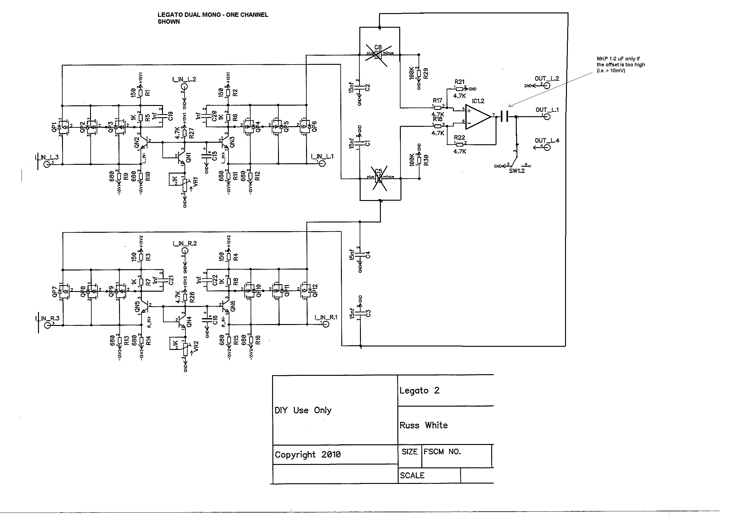

Dear Russ,
when you say what below you intend to connect after the 100uF caps or before?
I mean: do you intend to use the 4 caps or not?
The reason I ask is because I want to use BAL/SE without caps and put a small cap only on the SE out.
SO parallel 2 and 2 output without caps --> go into BAL/SE --> put 1-2uF cap (if the offset is not high --> PRE
Thanks in advance!

Not sure I follow what would be scary. 🙂 Perhaps I did not explain well?
You would connect the same phase from one side of the legato to the other. You just have to keep in mind that they are inverted so the + on one side would connect to the - on the other.
I will try to draw a picture when I get a chance.
One benefit is you get half the output impedance. 🙂
Hi Giani
I can say that I did the same with My set-up and it works beautiffuly.
As "THE Consequence" I like it much better..... 🙂..
Actually I always wonder why Russ did not made "this mod" optionall for SE output.
