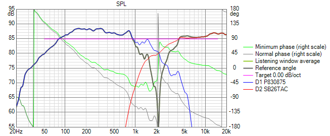

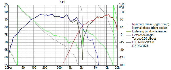

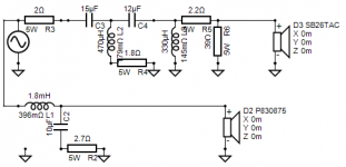

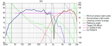

Here are 2 xovers > I'm still on learning process
1. Peerless 830875 and SB26STAC
2. Peerless 830875 and D2608-91300
Note: FRD/ZMA worked from 2 Pi specs chart using spltrace in vituixcad
Don't know how to convert to 4Pi. Want some explanation how to proceed.
I had less trouble working with the scanspeak tw.
There is still a peak with the P830875 spl at around 875 hz.
Your comments how to smooth the overall spl and get a better xover.
Lastly what should be your ultimate choice if you had to choose. tks
p.s left images with SB26STAC and right Scan D2608-91300

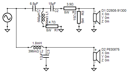

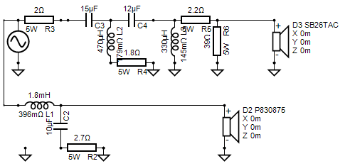

Sorry forgot to inchude the xovers . Here they are. Welcome improvementsHere are 2 xovers > I'm still on learning process

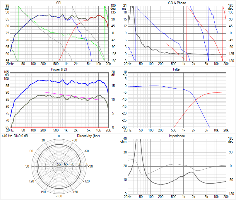

In VCad, you use the Diffraction module found in the tools menu.
Create your baffle using the dimension controls, then import your traced FRD in the field described "Half Space Response", play with driver positioning to get the smoothest result within practical constraints (make sure you don't move the driver outside the baffle for example!) then export - it'll save a set of multiple FRD's, one for each off axis angle.
It is these FRD's you use in the main crossover designer instead of your original trace.
You will end up completely re-doing your crossovers, but at least your first attempts give you useful practice.
HTH,
David.
You're right. Things aren't so easy after diffraction.

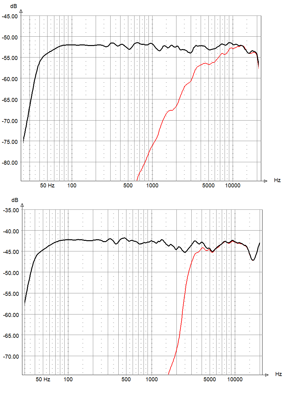

If you like recessed at 3.5kHz, go for STAC. Here is an example of a three way with same drivers, same cabinet and different tweeter crossover. At upper the crossover is electrical 12dB/o and on lower it is 24dB/o. Both measure nice and linear but the sound is quite different.
No one can tell you how complicated the crossover might be for a particular driver. It is all in the hands of the one who designs the loudspeaker.
