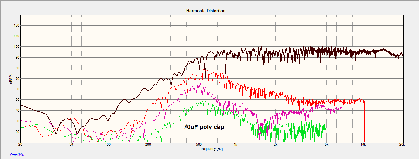

95dB at 1 meter, with a 70uF cap attached, in the cabs I used them in is attached here. The thing is, you are supposed to measure with little xover influence from driver to driver, or there is no comparison. I only attached the 70uF cap to protect it, and that filters well below the applicable passband. What I see is -40dB on 2nd order sets in about 2.5kHz, because 55dB is -40dB from reference, and the -40dB point is the same as 1% HD. Of course with the proper xover, the HD will be lower, hence using a xover above 2.5kHz if at all possible. 22mm tweeters do not have much Xmax, and this 22mm dome already has a waveguide to help it get where it can. The numbers you suggest do not jive with my personal measurements.
Best regards,
Wolf

Yes, if you want to compare drivers. However, I still think it's useless when implementation tells a different story.
With all due respect, regarding measurements, I rather trust a publication like HobbyHifi than random measurements on the net.
Do you call that a waveguide, hmm...?😉
Btw, what are the dimensions of the baffle you have on that measurement, response look way to flat?

His measurements look absolutely fine and exactly what you'd expect for the tweeter under measurement.
With tweeters like this it's always a trade off. Heck the same is true of the wide surround scan speak drivers too at price = ridiculous. That is, generally, high second order distortion Vs narrower surround designs. They usually have very low distortion in other areas though, as is shown here.
The motors are linear down fairly low as is shown by the low higher order products but the wide surround seems to introduce nonlinearities due to its geometry. You don't usually hear 2nd order distortion until it's at much higher amounts than the tweeter above though so it can be argued that is largely irrelevant. That tweeter would be absolutely fine down to 2kHz with a 4th order acoustic slope. Then take it higher or lower depending on how loud you want it to play.
