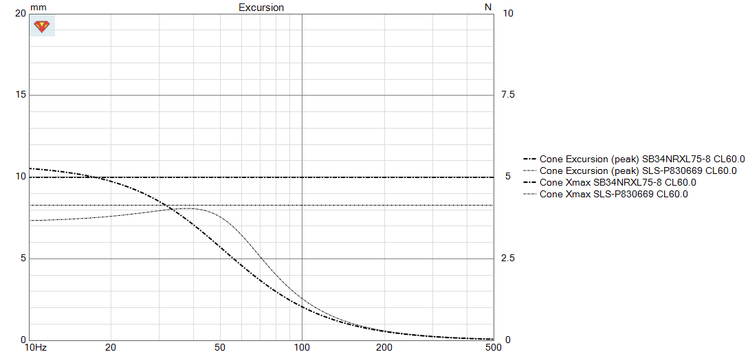

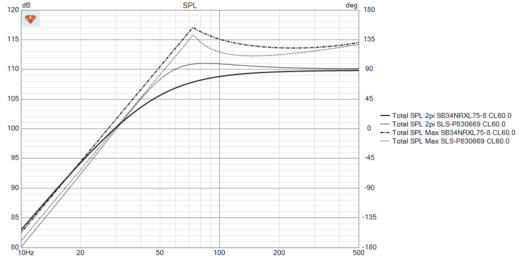

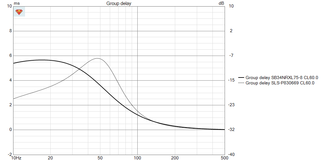

Here's a simulation of a SLS12 12" in a 60L box vs the SB34NRXL-8 in a 60L box:
For the application of 60L closed box, the differences are less than what the price or appearance might lead us to believe.
The real benefits would be observable in a different application eg. smaller ported enclosure...

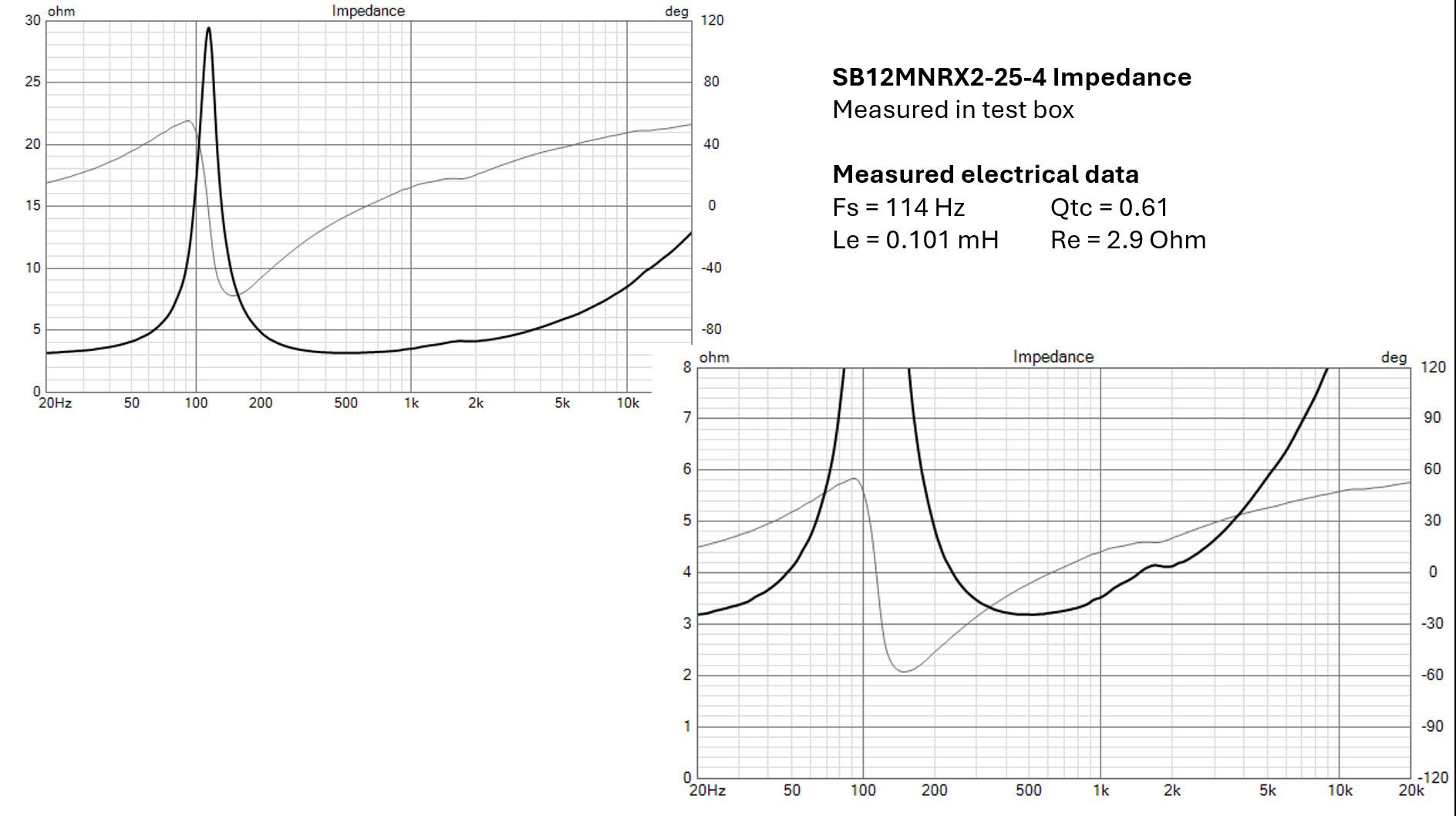

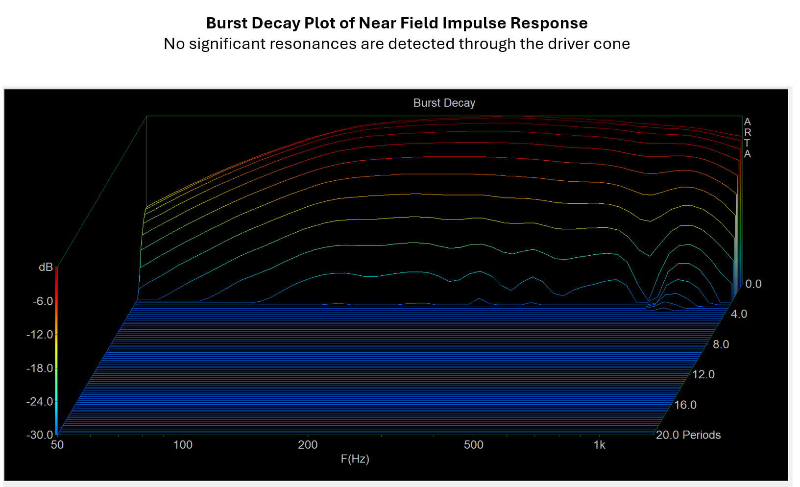

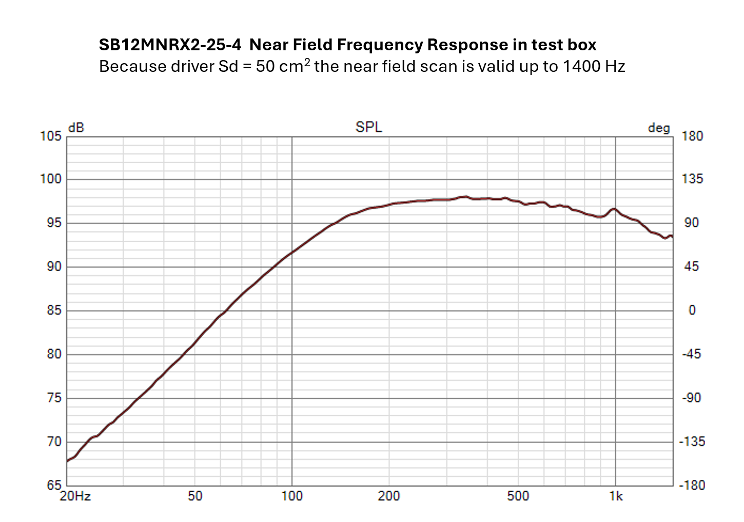

Here is the evaluation of the SB12MNRX2-25-4 that I had on hand.
First I will describe the test box I built.
I matched the baffle dimensions provided by @A4eaudio. The driver was loaded with a 2.9 l sealed box with internal dimensions of 2.25" x 7.5" x 10.25". The mid driver was centered horizontally, and 9" down from the top edge. The plywood test baffle was available from another project, so I incorporated it here. When I made the test baffle, I cut the recess slightly large. I used modelling clay to fill/smooth the gap between the driver and the recess.
Below is the near field scan of the driver in the test box. Because the driver is so small, with an Sd of only 50 cm^2, the NF data is valid up to 1400 Hz. The data looks nice and smooth, and no resonances were detected.
Below is the impedance data. Again, no box resonances (either structural or acoustic) were detected, so I concluded that the test box was functional and suitable for evaluating this driver.
There is a small burble in the impedance curve between 1.5k and 2.1k.
The above burst decay plot was processed from the near field impulse, so again I only show it up to 1.4k. Nothing going on below 1k, but at about 1.2k we start to see some stored energy. Whatever is there is very well damped, so I suspect it is the rubber surround. Regardless, it is very minor.
