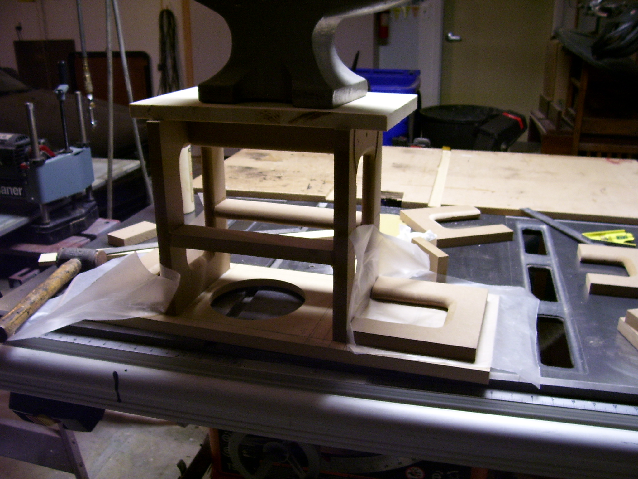

Cut out larger cabinets. Doing the full matrix internal cross-bracing as it is cheaper than panel bracing with oak strips. Boxes are about 9 x 24 x 13. EDGE simulation wanted the woofer more centered that I would have guessed. Doing it his way to see. In theory, I can miss-match the ripple from baffle-step with the natural dip in the SilverFlute and smooth the 1K reagion just a tad. In theory.
Been a bit side-tracked on this. Mostly researching glue. Over in the woodworking world I got lots of conformation about PVA shrinkage. I am not waiting a year for the results, so I will be using WEST epoxy. I also got side-tracked in designing a solution to Delta planer snipe. ( I'll write it up over in in the techniques forum)
Just glueing up the internal matrix. I am trying an inside-out build process this time rather than fitting bracing inside a box. Sides are cut about 1/64 proud, so I will see if it glues square and can sand to fit.
