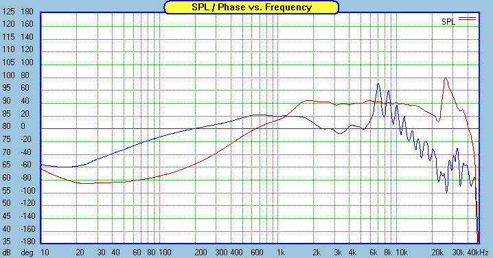

I was prompted to report on a little budget build I just completed. I had several goals:
1: Gain further practical real vs. model experience with PSD Lite and HOLM
2: Show how well you can do with cheap best-in-class components keeping a simple (cheap) crossover
3: Prove why I build more expensive speakers
I believe I succeeded in all three.

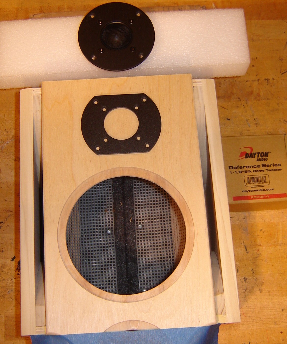

First driver selected was the SilverFLute W19RC36-8. At under $40, this is a wool-paper cone and is much better than the price suggests. No, it is not a Iluminator beater. It has terrible break-up issues between 4 and 5K so top prevent a very complex (expensive) crossover, it should be used with a very low crossover.It has pretty smooth response and will go quite deep for a 6 inch driver. I set 1.5K, 3rd acoustic as a max. Ouch. Find a 1.5K tweeter cheap? Again, picking best in class, not the best I can find, I selected the Dayton DC28F-8. 1/18 soft dome. Highly respected for a $20 tweeter and is known to not be too terrible crossed over low. Things like the SB29 or a Morel were way out of the budget.
Box was done by odougbo. It is one of his curved sid-port jobs he has posted several times. I don't know how he can do this so well without measurement, but the alignment is dead on. F3 is in the low 60's measured. Like I said, the SF is a budget class leader.

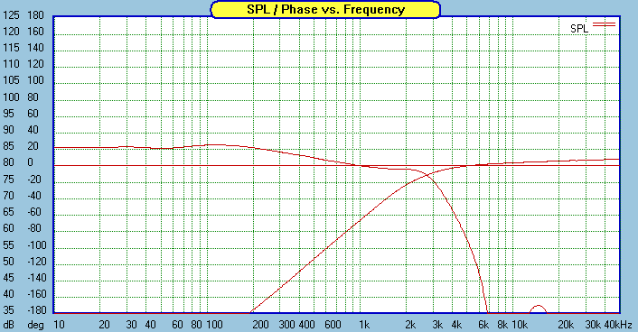

The crossover I ended up with is a second order electrical. Not quite symmetrical. Woofer is a 3.3mH and 12uF. Q is about 1. Tweeter 15uF, .75mH with a 1 & 8 Ohm L Pad. Q came out about .78. I used the Jensen P-core for the big 3.3. Caps are standard Dayton poly. For a strict budget build, I see no reason not to use electro's. I happen to have the films. The films raised the price by over $20. Pick your budget. I doubt you could hear the difference in this application.
One meter on axis, MLS measurements are within a couple dB 100 through 15K. The cabinet does not have the large radius edges I prefer so it sounded a tad bright. I added felt doughnuts around the tweeters to tame them a tad.
Sound.
Well, for me they are a bit disappointing. BUT these are built for under $200 the pair. For the budget, they are actually pretty darn good. The produce REAL bass into the low 50's. The response is surprisingly flat. Imaging is very good. The distortion is just too high for me. Yes Virginia, there is a difference between a $20 tweeter and a $100 one.
Red is the tuned speaker before adding the felt ring. I did not measure after. I did not do any polar measurements. Blue was a test trace I happen to have saved in this jpg. I was not planning to post this, so excuse the graphic.
Conclusion:
Through the crossover region, HOLM is a super tool and it correlates well with listening. I think it correlates better than fast-chirp on TrueRTA. It matches ARTA, but I prefer it now. Of course, the bass response is best done outside with noise, not MLS. Not going to bother, sorry. I use my WooferTester to get the impedance plots.
Using PSD, one can very accurately model repeatable results that correlate with measurements. Great little tool. I still rely on ISD for my box design.
The best budget drivers are pretty good. Only that. No amount of fancy crossover or tuning can overcome the lack of copper pole shunts and basic motor shortcomings. For $200, not a bad build. I would do a conventional rear-ported MDF box with 3/4 inch roundovers on all 12 corners. I may still do that. It may still be a tad bright for some if played stand-alone. With a sub, the balance is not bad. You can always pad the tweeter some, but I found that messed up the crossover region too much. So that means adding a LR parallel filter. More money which puts it outside the project scope.
What else could be done? I have another woofer I got by mistake. I may try doping the cone to see if the breakup can be tamed enough to slide the crossover up over 2K. That would greatly reduce the tweeter distortion and allow a cheaper woofer coil. Maybe I'll play with that while my test blocks for how to hide MDF seams cure.
They will stay in my garage playing the FM until I cycle something else through there. I have not run out of nieces and nephews to overload with prototype speakers yet so they will find a home.

Did you try using an elliptical LP filter instead of crossing so low? Care to upload your project files?
Trying to make an elliptical filter hit dead on a resonance peak would be quite a trick. It would have to be tuned to each speaker. I think the Q of the notch is much higher than the Q of the breakup and I have no experience with the phase. I have never explored this with a passive filter.
I played with a wide variety of Q's. PSD lets you do that. I have no doubt higher-steeper filters and a notch would reduce the tweeter distortion. Making the very best crossover possible with these two drivers was not the goal. Simple and cheap was. We already learned this is a great cheap woofer IF you deal with the notch. The Dayton has a pretty solid rep for $20. I have used several other $20 tweeters in the past. The Dayton is way up there in the pack and the only one I know anything about that can be at all civil at 1500Hz.

Electrical transfer functions of Zaph's crossover
Note the BSC and bump in the roll off around 15KHz.
It is used in Zaphs design to approximate 4th order
L/R acoustic around the x/o point and then null the
drivers peak. The acoustic result is quasi 4th L/R*,
away from the x/o point the roll off is not 4th L/R.

It is pretty effective, raw drivers in the box :
Adding the crossover (ignore sub 200Hz both graphs) :
Impressive stuff with just 3 components on a difficult to use bass/mid.

Now, back to a budget build. I would not build a baffle the way these were. The side ports preclude the large edge radius I favor and I have concluded offset tweeters are more trouble than they are worth on small baffles. I prefer regular polygon cabinets with rear ports and I like to cut the flange of the tweeters to get them closer to the woofer to improve horizontal off-axis. Things can be gained with irregular shapes, but they are not really relevant at this end of the scale.

OK, now you are going to make me put them in a box with my style of large radius baffle and see if I can tweak the top end a tad more. My budget won't hold up to a set of the Santori drivers just yet, so I'll play here a little. Do note, we have two designs now using the Santori's. Both by very experienced designers. (see the vendor section). It took over a year for them. It is going to take me quite a bit if time just to absorb all the info in the thread. Very good reading. This build was a few days. Budget in both time and cost.
I will mount the drivers on a baffle intended to manage diffraction better.
I will measure acoustic offset. I use an old Old Colony Lab "pulser" for this but it can be done with a PC and Zelscope.
I will provide new 1M plots in a quieter environment with consistent gate times.
I normally would not splice in the LF responce. It is too room sensitive anyway. Maybe I will try. SoundEasy allows doing a Hilbert Transform to generate the phase of a spliced plot. I understand it is a comfort factor for beginners to see something on the bottom end that looks normal rather than the artifacts of a gated MLS plot. It does not matter to crossover design.
I will set a measurement reference level that can be reproduced instead of "about a WATT"
Doping the cone to see if I can get a higher crossover by controlling the breakup is not a beginners technique but it is cheap. I will only include it if I can get stupid-lucky first time out. ( I have one extra woofer) You can trash a lot of speakers learning how, so budget it is not. Mess up only one pair, and you could have bought a much better drivers in the first place! ( like the Seas woven poly cones with no breakup problems, copper pole shunts etc. )

Oh I don't know, I thought they sounded like the King's Trumpets when I heard them, wish I could have kept them for a few days.
What about the next Dayton up the chain? I'm thinking they have more of the $100 tweeter sound. They supply them with truncated rings.
Have two of everything here, woofers, boxes, tweeters, let me know if there are any suggestions for designs.
Next Dayton is the same tweeter for $1 more to get a truncated frame. Next REAL step is $54 each vs. $19.45. Clearly out of scope for this game. Thread comments suggest it is a good tweeter. I am a Seas fan at that price.
To tame the top end just a little, Radius the top edge 3/4 inch and add a felt doughnut around the tweeter. You can't do much to the sides. In your room, move all the other speakers away so they don't give as many reflections. Rule of thumb is 1 meter in all directions. Of course, all our thumbs are different.
Maybe change the L-Pad to drop the tweeter a dB. I thought it started to suppress the mids a bit which is why I left it hot. Adding a counour filter is upping the cost. Not allowed unless it is recovered elsewhere.
Tweeter offset/horn loading. Nothing helps a tweeter like efficiency. Carving a horn is not easy. 3/4 roundover if it can line up with the surround having no gap may be an approach. Let me look at that. Of course, it will take some crossover tweaks that could imply cost. After the conventional rear ported box, that would be my next trick. I wasn't going to let that one out, but whatever.
