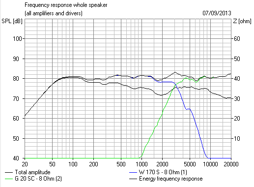

If you look at the FRD, you can see the boost in the lower treble from the waveguide. It does not seem hard to deal with, but I have not built the crossover and have not listened or measured off axis. This was really easy.

As luck would have it, the bump did not cause too big of a problem, that is compared to the basic shortcomings of cheap speakers in the first thumbnail design. I have not studied it carefully and have not built it. Darn 9 to 5 job gets into my way but I do like to eat. I could be totally off base, tweeter hump and not curing the breakup. Or I could be stupid lucky and it is great. Only building the crossover will tell.

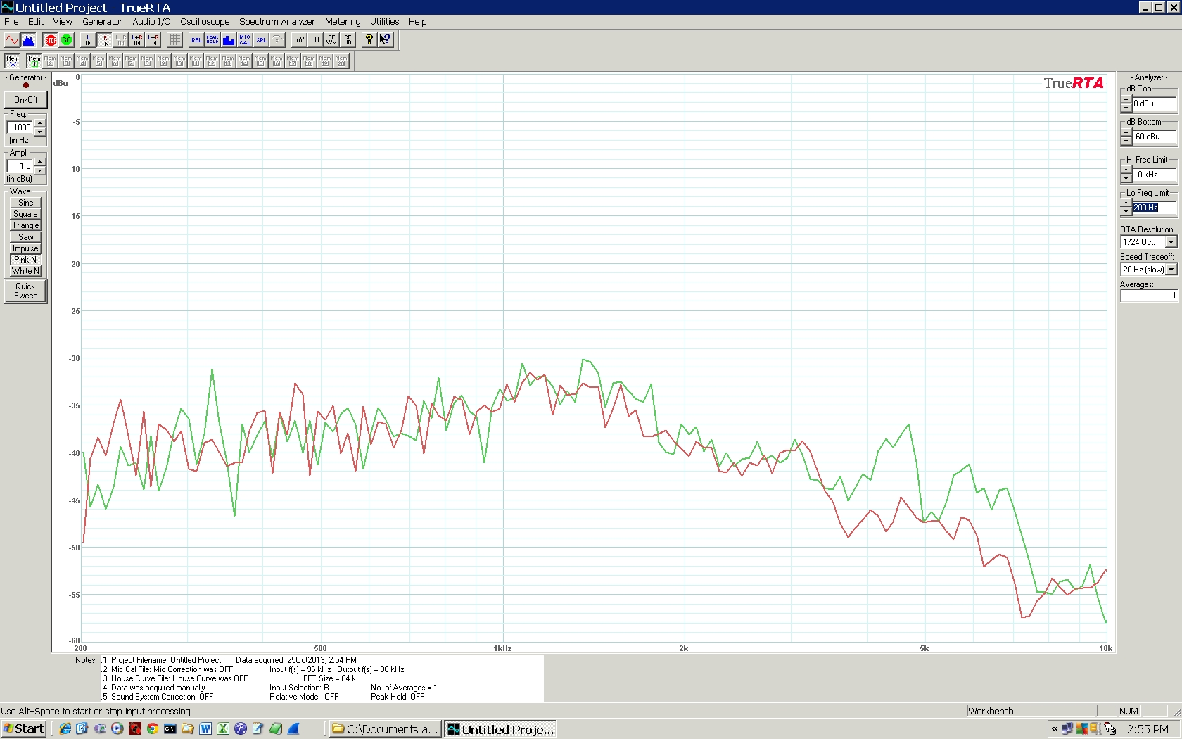

Aftermarket caps? If I had a the measurement equipment ( laser inferometry or holographic comparisons) and I wanted to build several thousand drivers, sure I might try to design a cap that does not have the same issues. Check the detail Fostex has worked on to reduce breakup in their caps. Then note that Planet10 still applies his doping pattern to it! I see only one advantage to a dust cap. Keeping dust out of the voice coil. I have to think if a sealed box is a different case causing a higher loss factor due to spyder flex from box pressure as it becomes stressed, rather than the dust cap. A possibility, but not germane to this project.
It is the dustcap!!!
Cut 6 slits and then doped only the dustcap with RTV. Much better behaved. No need to remove the cap and make a phase plug. Cheapest yet.

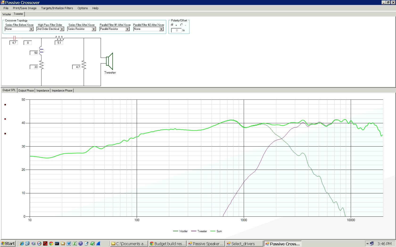

I am going to model a few other crossovers this afternoon. Can I make a first order at 2500 work? Not having the Q to play with, my hunch is no, but that is what this is about, finding the cheapest solution.
Not at all worried about the tweeter resonance. With the modified woofer, I shifted the crossover up to 2 to 2.5K range. Of course, 5K is more like where I would normally look to do a first order. But in the concept of CHEAP, worth a try. Terrible results. All it cost me was my time.
I also played with best I could do. For about three times the cost, I could model (based on in-box real measurements) within a dB 100 to 10K. 13 parts and reduced the efficiency a couple of dB. Totally out of scope for budget. It can be done.

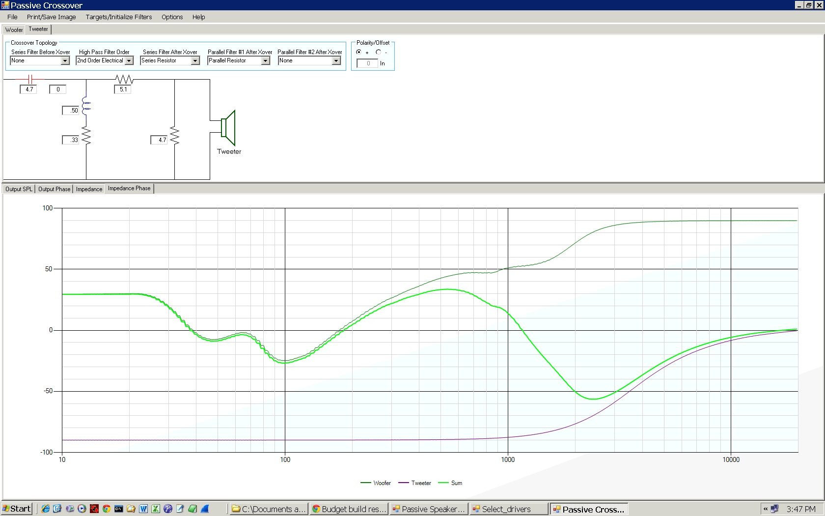

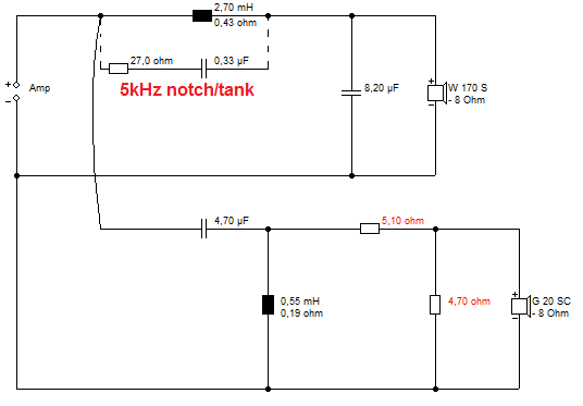

Parts I decided on are 2.7mH and 8.2uF on the woofer, 4.7uF and .55 mH on the tweet with a 5.1/4.7 pad. A little of the 3.3 breakup still shows, and a little of the diffraction hump is still there, but for a CHEAP build, I hope it will be pretty good. This is based on the slit/doped woofer. Bottom end was stronger, box smaller. Almost as good as the phase plug. Easier by a lot. Parts will take about a week to get here, so don't wait up on the results.
Woofer mod: I cut 6 radial slits from the edge of the cap to about a quarter inch from the center, Then applied a pretty heavy coat of silicone to just the cap. Resonances moved up with the slits, and back down to 3.3K with the silicone, but lower in amplitude by a lot. T/S for the entire driver did not change much.
I make that about 2.6kHz crossover, which is OK. It all looks OK on frequency response too. My modelling is rough and ready, of course. 😎

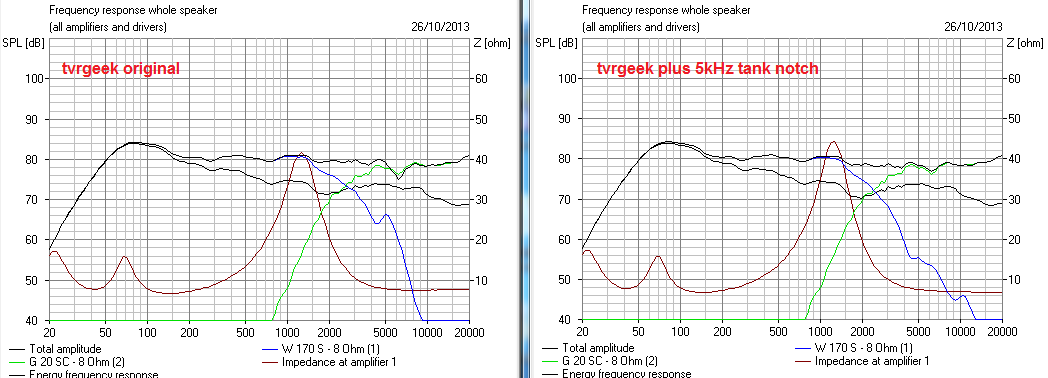

I still like my 5kHz tank on the woofer, and I think you should try it. Phase isn't IMPORTANT...it is EVERYTHING! 😀

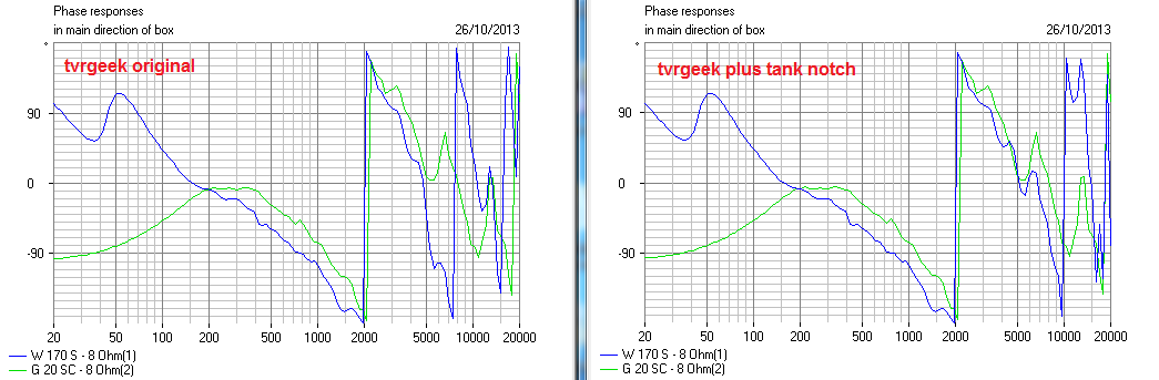

Ah, you are using the unimproved OEM woofer plots. My phase plug or slit/doped version does not have the breakup at 4.4K. (it has a much smaller one at 3.3 I am going to ignore for now) By the model, a notch is not needed there.
Now on to phase, I am not really sure what I am looking at. I'll gladly take whatever help you can provide.

Hard to say what your dustcap mods are doing. They may add a certain amount of rolloff and damping to the AAL3 resonance. You'll have to model it to see what combination of electrical and mechanical damping works best.
Phase is easy, once you get it. Keep the drivers phase aligned throughout the overlap region. I can't explain it more simply. Just occasionally, drivers play beautifully together, as below:
