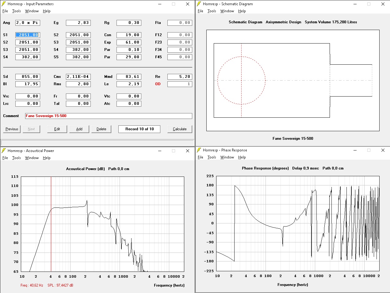

To anyone who might be interested in the Sovereign 15-500, see picture. Outer dimensions ca 95,5 x 55,7 x 43,7cm If using 18mm material, and accounting for 2 pieces of 1,8*2cm strips on all 4 sides of the enclosure. lower port is 10cm tall with 1 piece of 1,8 x 10cm material accounted for in the middle, should have some thick felt on sides for damping.
The tweeter or compression driver + horn can live on top of the enclosure, maybe on a tiny 1" thick oak baffle?

I've never abandoned this subject, just been trying a lot of simulations with lots of different drivers. After much thought and consideration, I've come to the conclusion that I will not go this route at this time of life, maybe in another 10-15 years. But nevertheless, I t was always my intention to follow up on the thread and try as best as possible to get close to the original goal, it has been interesting.
The hard part, subs:
The closest I managed to get at 4ohm is 99,9950db/36,75hz with 2 subs in paralell, simulation volume is 139,405 liters each. If using 2 ohms then well... I just cant keep moving the goal so the cheapest winner is Dayton Audio PA380-8 15" Pro Woofer.

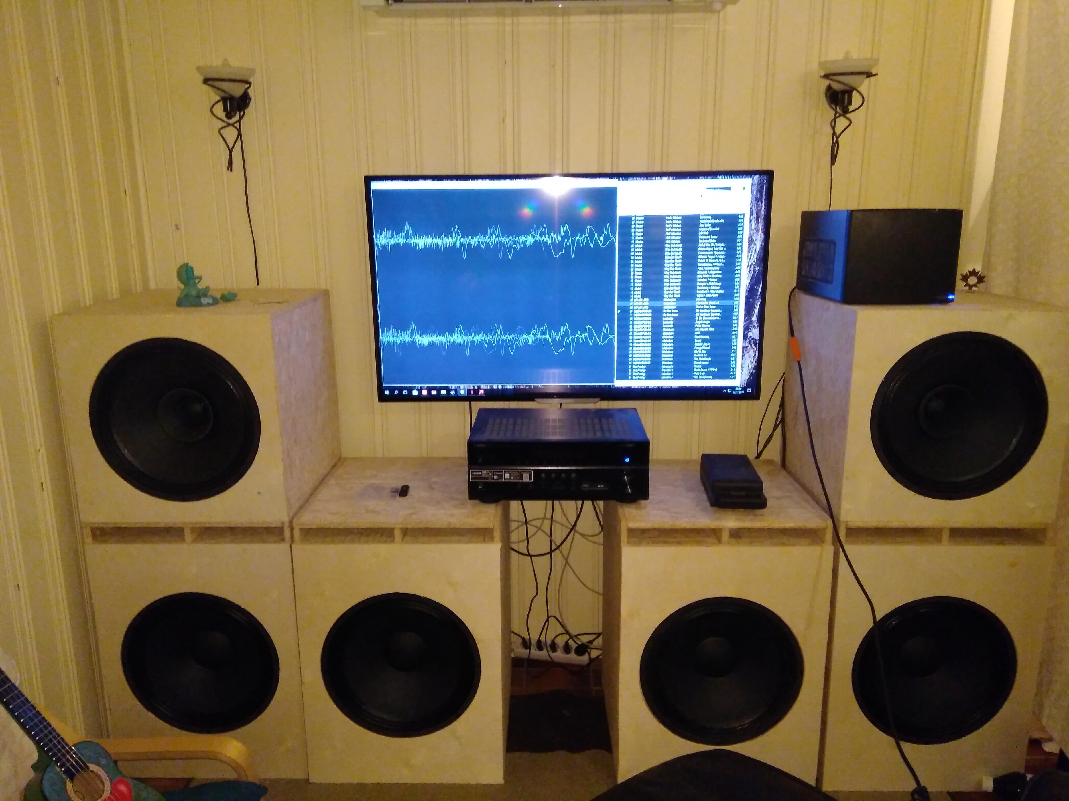

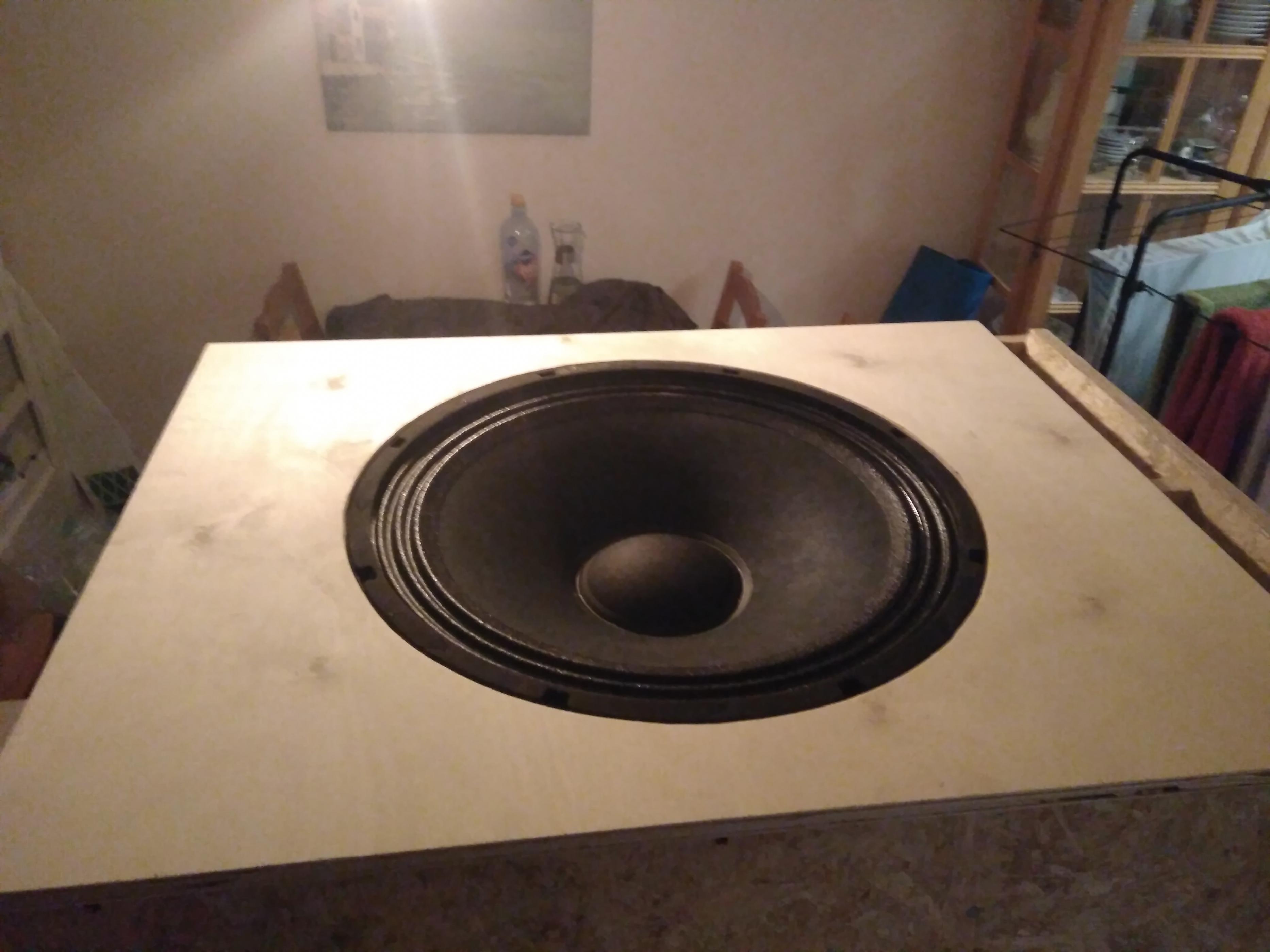

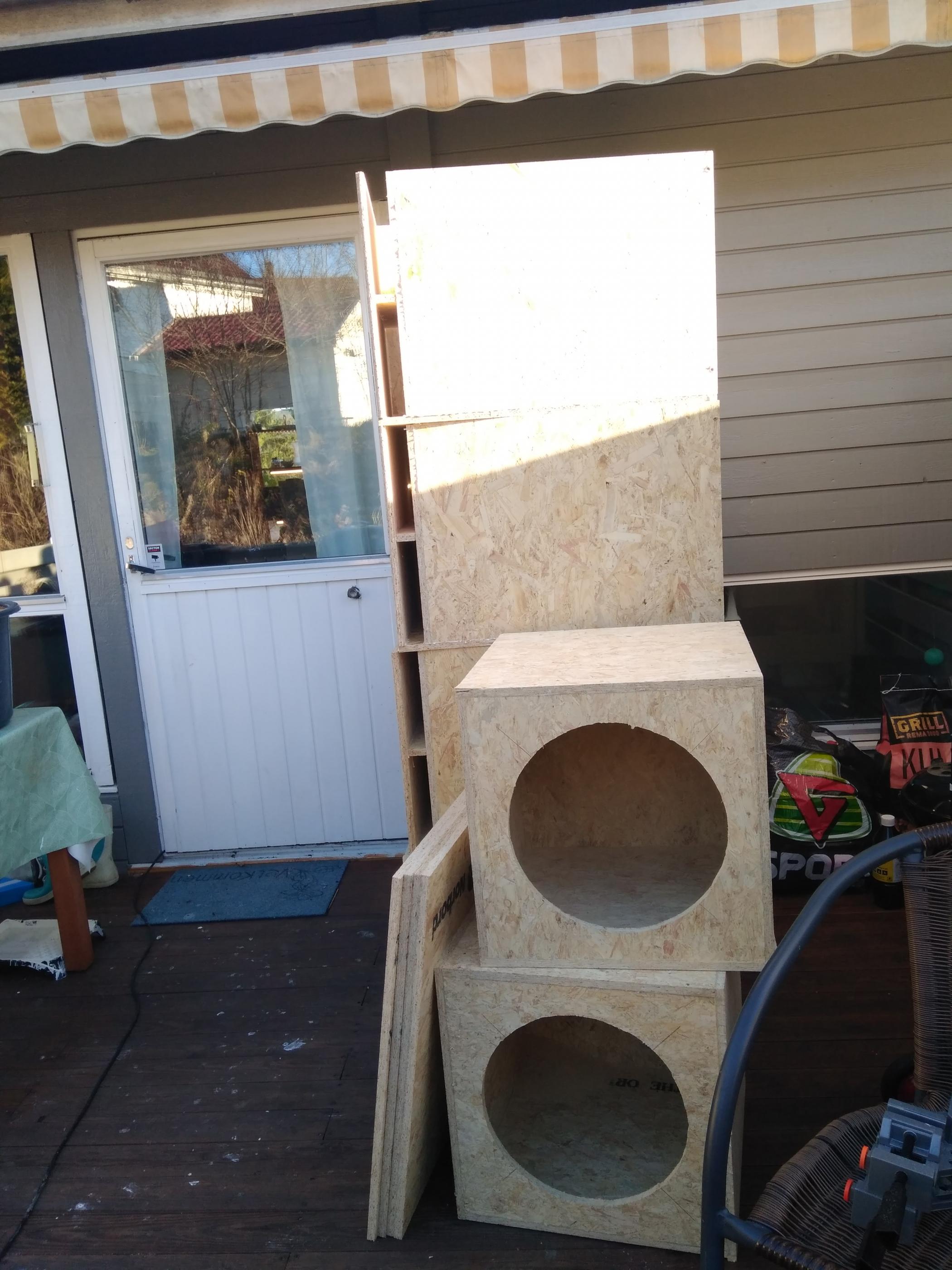

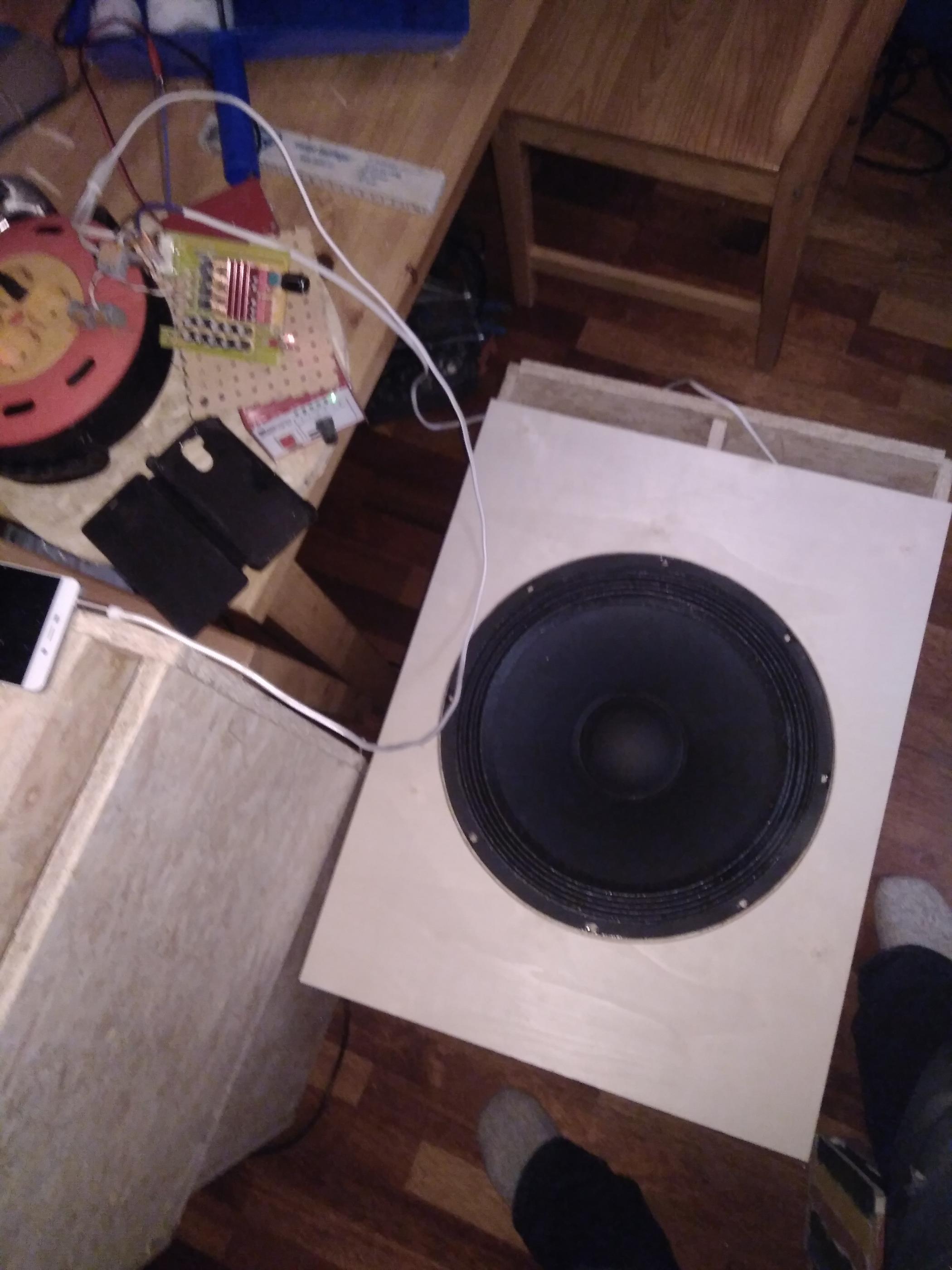

Here we go. Nearing completion of the boxes. All the Fane Sovereign 15-400 and FC152 are in house.
Have to finish bracing and glue on the sides of the bass boxes and get the sheets of 12mm ply on all the fronts. The subs or what you call it are at ca 128 liters each. The boxes for the FC152's are ca 80 liters each (sealed).

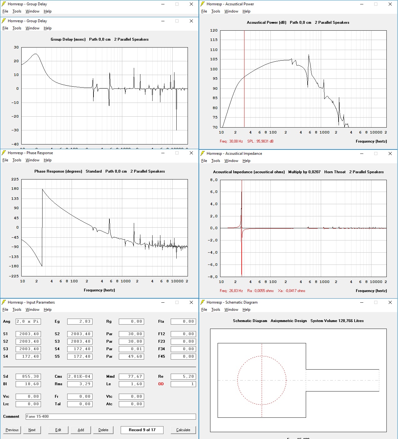

Here is the sim for the Fane 15-400's, two for each channel, hence the 2/parallel. The boxes are made within 0 to +2mm tolerance. It's completely dark outside now after work, so if I am going to get them done at all I have to get some flood lights. Hoping to do the surface treatment in the weekend if everything goes according to plan. Surface treatment will be teak oil and silk matte clear coat. The fronts will be very good looking 12mm poplar ply for ease of bracing, so total thickness of front baffle will be 27mm, and the sides/rear will be showing the 15mm OSB with somewhat simple bracing on the inside.
Progress is slow but good.
Had a listen to the 15-400 box yesterday after the kids fell asleep, bass is very smooth and well defined, but the drivers need a flex workout. Build quality of the drivers is very good.
Aiming to get started with surface treatment before the weekend, but the weekend is packed with activity so it will probably be mid next week before finishing up, hoping for milder weather so I can take them outside and do measurements then.
We have liftoff. I had to give up, at least until spring. Will do the surface treatment then. Too cold and snow outside, and my trim router bit broke, need some more parts also to hide the ugly corners. But the speakers sound fantastic, even at low level there is a sensation of impact that is very engaging.

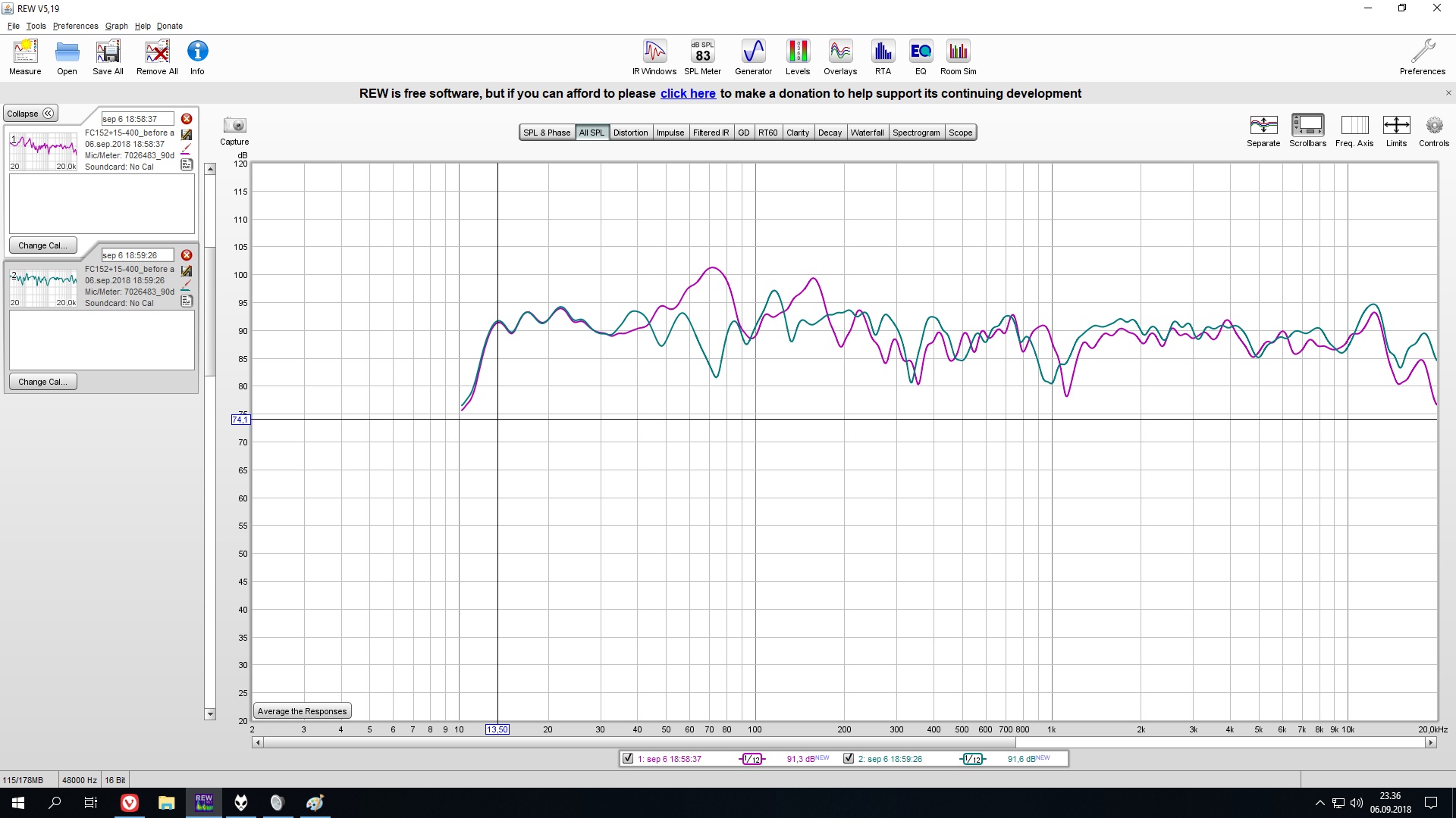

In the absence of proper measurement facilities, I have done some measurements at 42cm distance from the cone center of my right side speakers. There is hardly any room interaction on this distance.
In this picture the measurements (all 1/12th oct smoothing) are as follows:
Pink: FC152 only, no EQ or other settings.
Red: FC152 only, no EQ but a 3db LP filter at 5khz.
Yellow-ish: FC152 + dual 15-400, no EQ but a 3db LP filter at 5khz.
Green: And last, it's the listening position, with FC152, dual 15-400 and the same 3db LP filter at 5khz, nothing else.
Here is the Unsmoothed 42cm measurements:
Cyan: FC152 + dual 15-400 and nothing else. (Blends with the Blue over 1khz)
Green: FC152 only and 3db LP filter at 5khz.
Dark Blue: FC152 in it's natural state, ca 80 liter sealed box.
Overall I am very happy with the results, the 15-400's give me more frequency extension than I'd hope for in my listening position. The FC152's are toed in slightly to give a broader sweetspot, when toed in it sounds nearly the same in any seat, even if you are directly in front of one.
There would not be any problem at all to use further EQ and filters to flatten the response, but when comparing the different files I tend to prefer the slightly dampened top end over most heavy EQ settings.

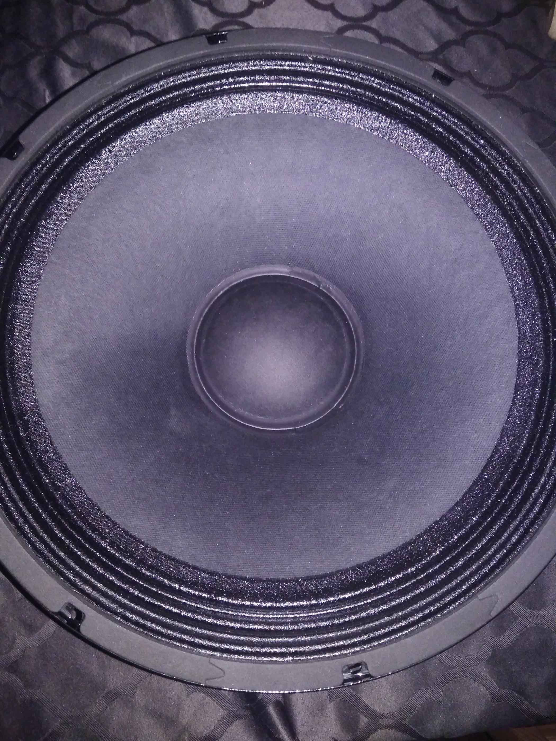

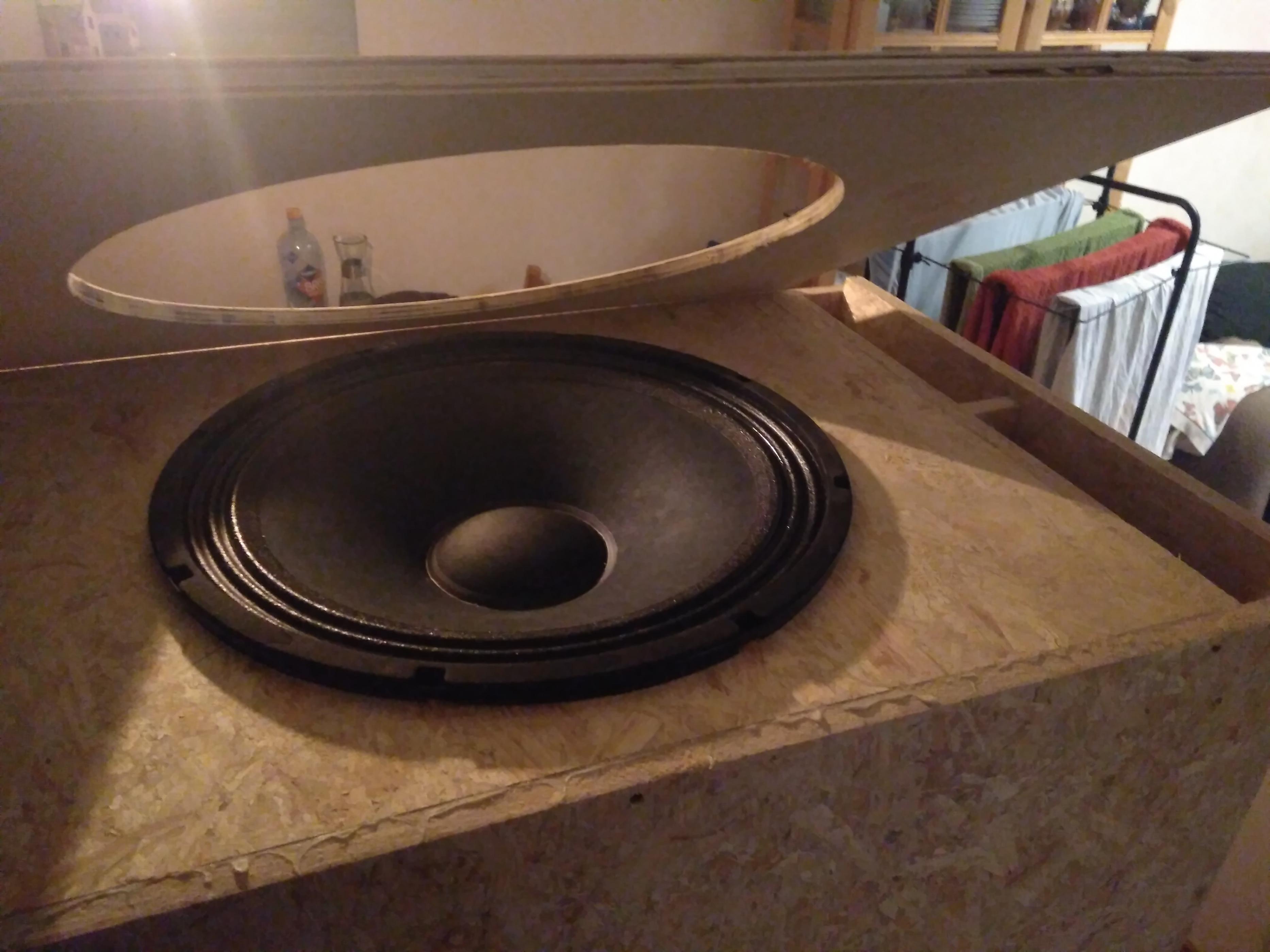

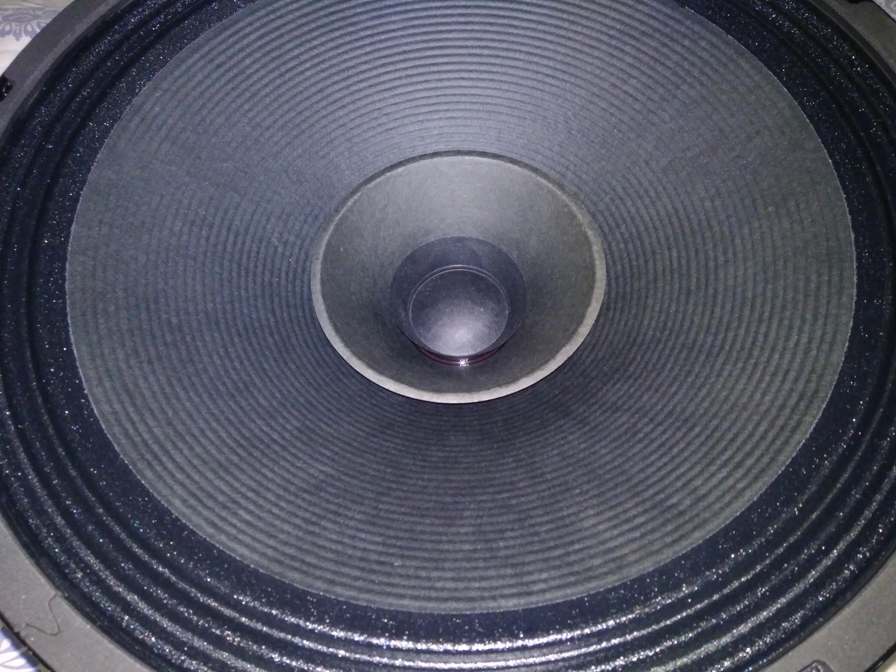

Felt the need to loosen up the Fane 15-400 drivers.
Put on 16hz sine wave to get a little bit of cone movement. Did not expect to hear the sound, it was a little bit uncomfortable. I decided to just let it stay on during dinner, we had an interesting discussion aboutlow frequency sound, heard the glasses and plates rattle in the kitchen shelves, then my 7 year old ran down the stairs, yelled "Now I know what sound you meant daddy!" and just turned it up much louder, there was still a lot of headroom on both drivers and amp so no problem, but I was concerned there for a moment, as this is below the calculated port tuning.

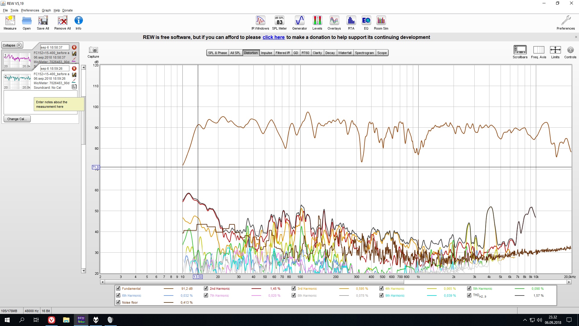

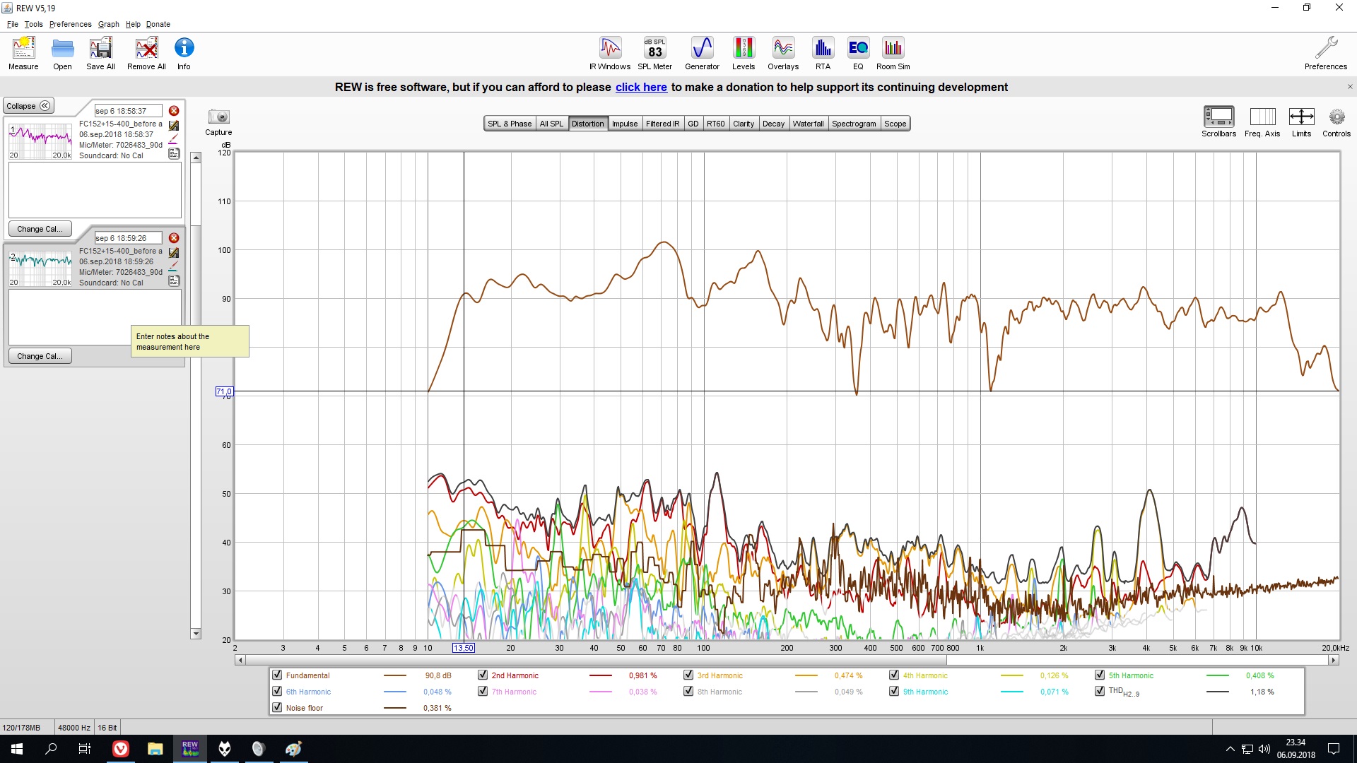

There has been some interest in harmonic distortion of the 150-300TC (previously FC152). Yesterday the kids watched some kids-show upstairs and played mario (IE not jumping around and screaming), and there where no meetings to attend etc.
So even if the noise floor is not optimal (not 100% quiet, a heat pump and computer fans closeby probably influence the measurements somewhat, in adittion to family noise sources being present), comparing the left and right channel in-room might give some indications.

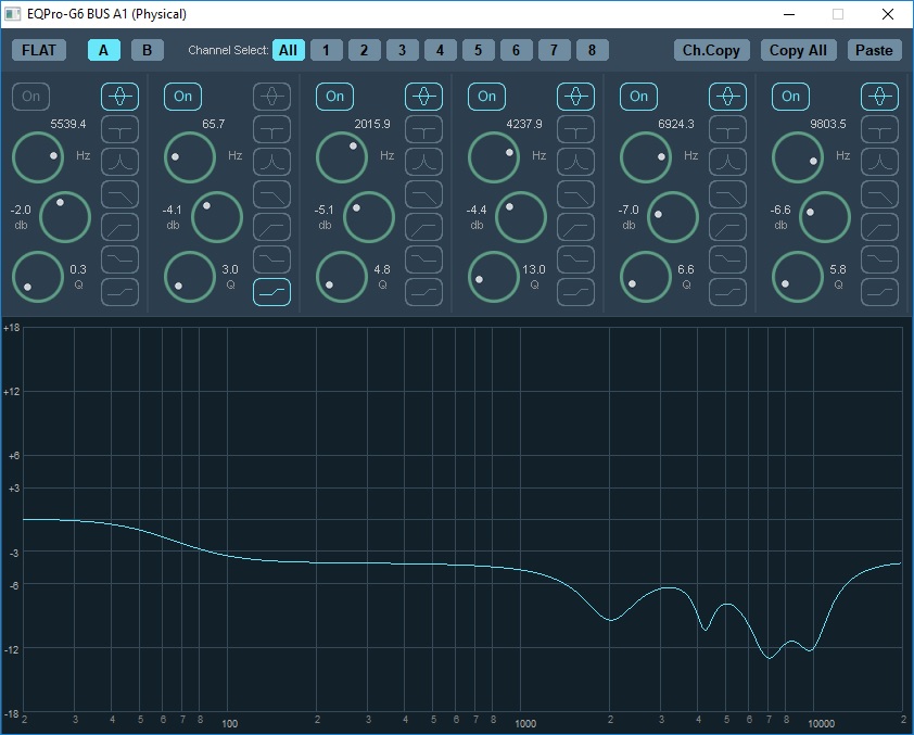

I am currently experimenting with: NOT using any form of xo between the "subs" and the 15" fullranger, there is only the EQ settings in Voicemeeter Banana, EQ settings are identical for each channel.
Remember the speakers are measured in-room and very close to side walls, measurements are ca 110cm from cone, so variations are expected.
Here's the EQ settings from VM Banana:
Here's the SPL + distortion for left channel:
Here's the SPL + distortion for right channel:
Here's L+R SPL measurements on top of each other:
Smoothing is 1/12th oct, but there is not a huge amount of deviation on unsmoothed graphs, it just looks more tidy with 1/12th oct.
(I am just ridiculously happy with the bass response, hardly any eq at all and that smooth. I have found that tilting a downwards slope from low to high frequency gives a very bass heavy response, it's way too much, so prefer more flat curves when the setups digs this low, on my other not quite as bass capable setups I like having that downwards tilt.)

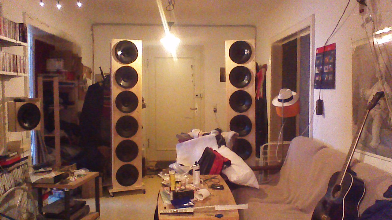

Short summary 2019.03.01
If there's any interest at all in my box design, the Fane 15-600 Pro (do not use the LF version!) is a better driver in most aspects except price. Many other drivers can be used, it is a reasonably flexible design.
