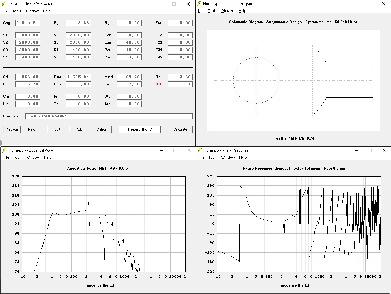

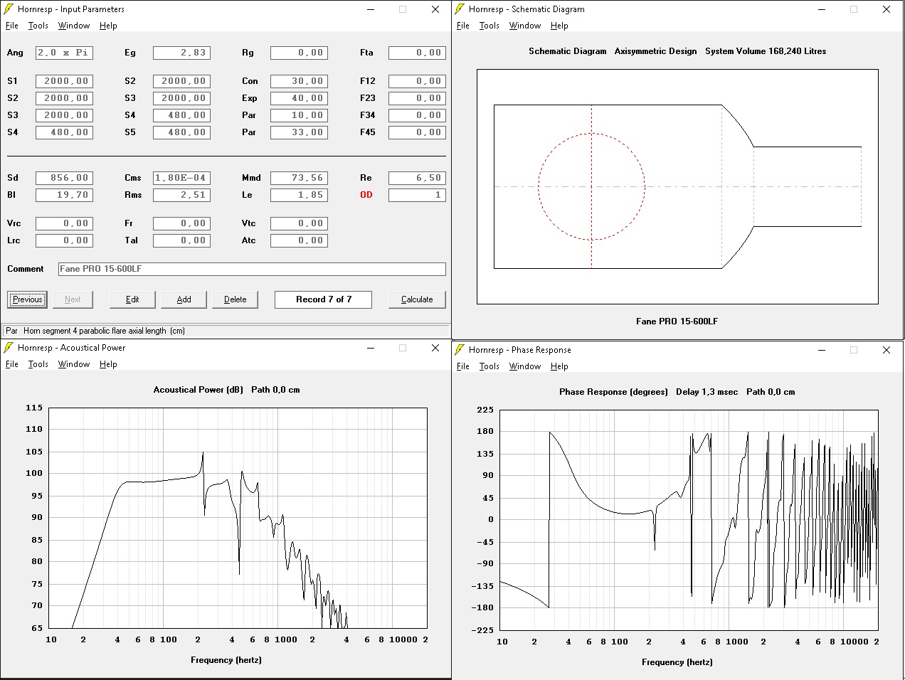

The kids are asleep and my wife is running about doing stuff, finally got a few minutes of simulation time in, first 7 hornresp minutes for months. Does not look half bad. Exact same box for both drivers. The 15LB075-UW4 can probably go a tiny bit lower almost flat, 15-600LF will probably have a smooth roll off if I aim lower. This looks almost like the golden size though.

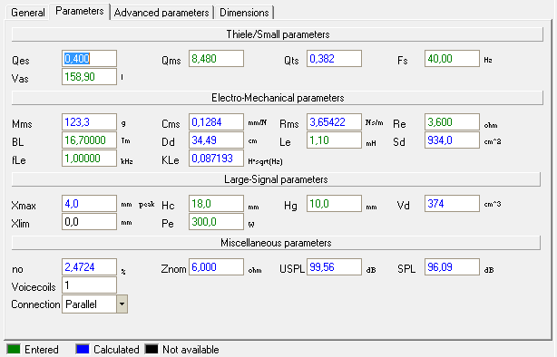

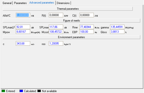

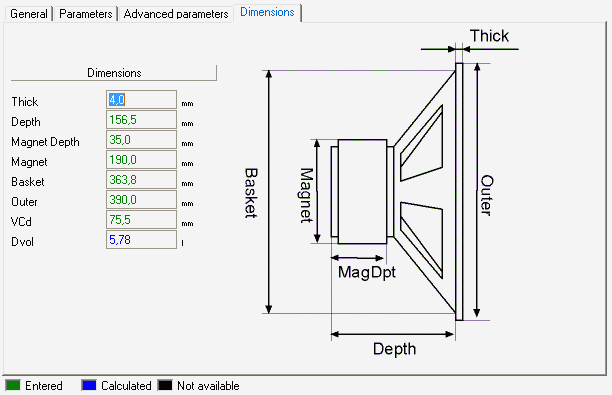

Did not find Le of the 15LB075-UW4 so just entered 2, not sure what to put there. Also, spec says 900 cm2, I wrote 856 cm2 like in the 15-600LF spec sheet. Mmd is calculated.
Edit:
It is my general assumption that the 15-600LF is more realistic, and will behave better, but the 15LB075-UW4 is just too cheap to ignore. Simulates that xmax will be reached at 20v (100w/4ohm) with 117.3566db/50hz which is not a problem for me. The Fane reaches xmax at about 41v (ca 210W/8ohm) with 121.3991db/50hz

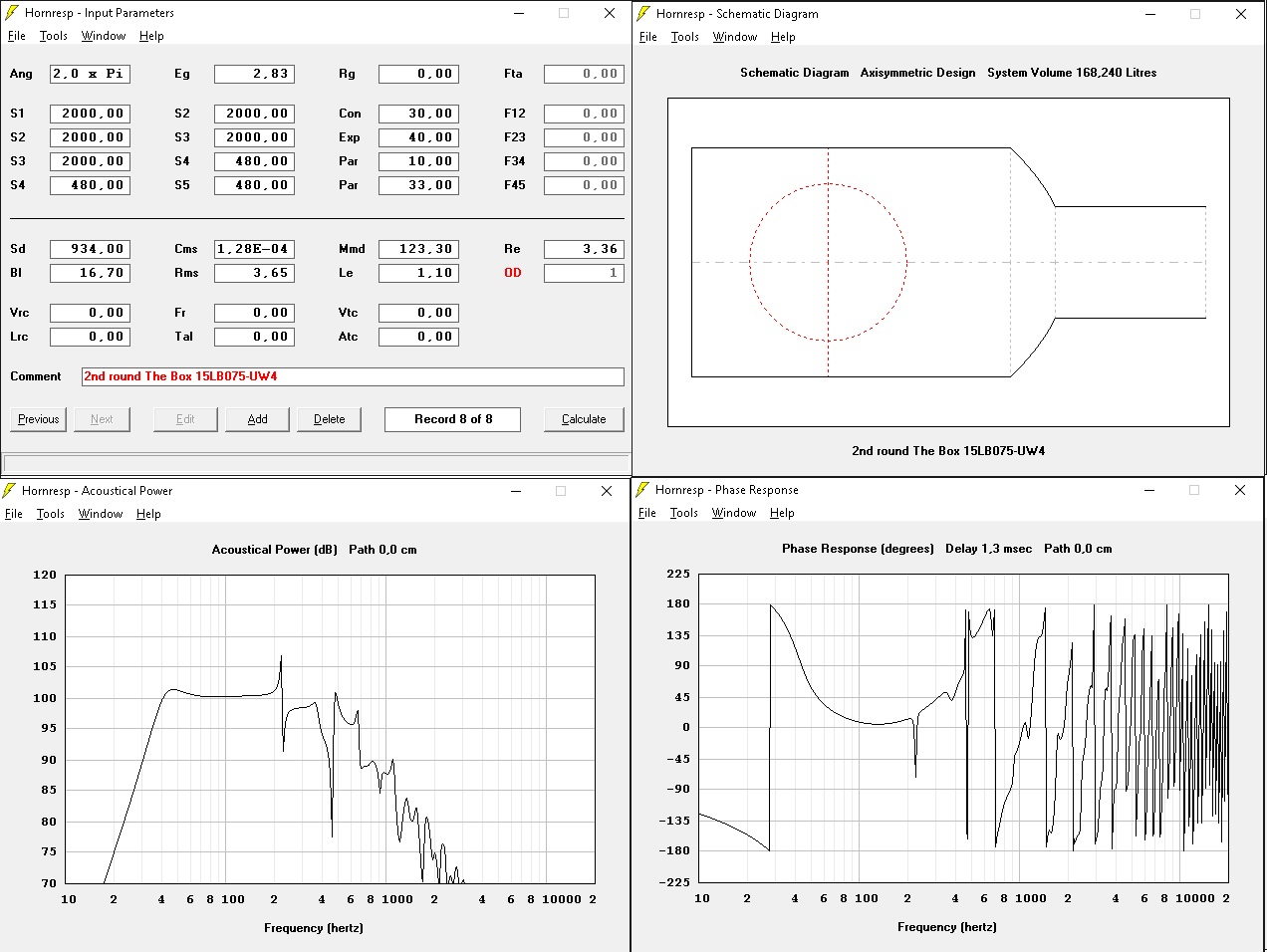

Looks very similar, only smoother
The reason I simulate the drivers in the same box without further optimization is to have a more direct comparison. Also, I am having some concerns regarding possible side effects a larger enclosure might have on this driver.

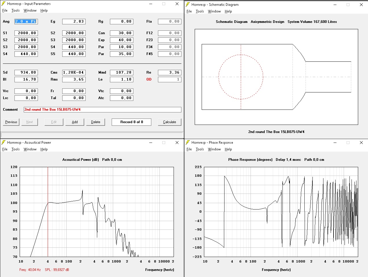

Minor tweaks only, also tried varying the values some to check for possible issues, looks solid. Possible to build finished box at ca 95cm*43cm*54cm outer dimensions provided 15mm OSB is used, minimal bracing is accounted for (some 1,5cm*2cm strips along the middle of panels, possibly diagonal with break in middle, 2 crosses from wooden broom handles 1 above/1 below driver, needs tight fit). Should be ok to 300hz?
Need to have a plan for mid and up...

You have to add the Rg, which consists of the amplifier internal resistance and the crossover parts because that affects the Qt and therefore the behaviour in the bass (may be neglected if the driver is only used above the fb, i.e. midrange or tweeter). A common value is 0,2-0,3 for an active setup (depending on the amp, you can calculate it via the dampening factor) or the internal resistance + the serial coil(s) resistance. That would be typical 0,5-0,8 for a normal amp and a 6 or 12dB passive crossover, depending on which parts (coil) you use, for 18dB etc. you have to add all serial resistances. With steeper xo orders that quickly adds up.

The 1 or 1,5dB might not be the worst on it, it changes the response, it might lead to a hunch. I'd suggest, if you go for a passive crossover, don't leave it out, add at least the serial resistance of the coil(s).

You are correct, but this is not news to me at least, I am merely having trouble finding good alternatives to choose from. As far as I can tell, the only solution available to get 100db/2.83v is with 4 x faital 3fe25 at such a low cost. 8" are too expensive and you'd also need 2, 6.5" does not give the required sensitivity and several of them to make up for it is also too pricey. There are 12" about, but they either cost too much, or must be bought from a place with higher shipping costs, not to mention the extra checkup bill at ca 30 euro for each package.
