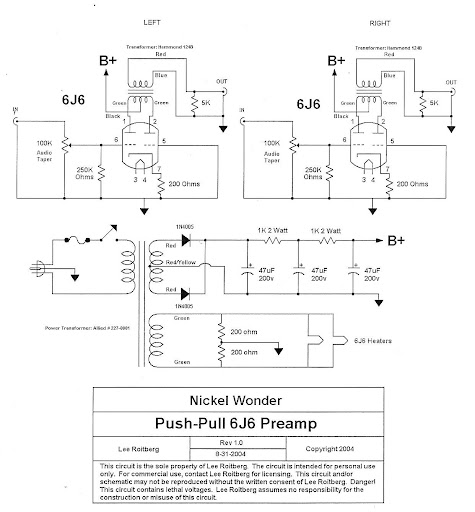

Not enough gain, surely? You need a mu of 30 upwards for a 2 stage 300b amp. That restricts your choice of drivers.
I guess it would depend on the source. A lot of folks seem afraid to turn the volume control past 12 o'clock, like it's "wrong" for some reason. A lot of sources have quite a bit of output.
Another option would be paralleled 6A6 (octal version 6N7)?
I've also been thinking about using the "Nickel Wonder" line stage design with a 6A6 to drive a power tube.

The Nickel Wonder with a 6N7 (or 6A6) is just an idea of mine to use that line stage circuit to directly drive a power tube. I've got the needed Hammond 124B nickel transformer, I'll give it a go one of these days. You could use the 6J6 in the original schematic as it has a mu of 38 and with the step down of the 124B it'd likely drive the 300B.
2.1VRMS from a typical CD player (full scale on the DAC),
gives 3.0V peak.
That is enough to drive some input grids into drawing grid current (there bias is less than 3V).
