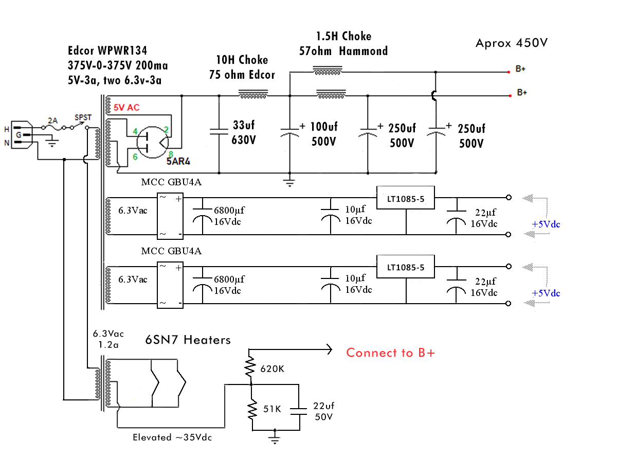

Hello Simon. I have several 300b amps, with OPTs by O-Netics (Wright Sound and Level 1), NP Acoustics amorphous, and Lundahl LL1664/70 (3K) and LL1682/50. I'm particularly fond of the LL1682/50mA. On paper this isn't the "correct" match for a 300b, but in reality it sounds extremely good and I would urge others to consider it as long as they don't need the full power of the 300b. Like you my speakers are 89db sensitive and I listen at around 2 metres in a medium/small room.
I use a triode driver with a large amorphous plate choke and Russian teflon FT-2 coupling caps. No doubt a pentode is another option. For the rest of the parts, Lundahl do a LL1668 plate choke and Hammond do PSU chokes and mains transformers. Suppliers in the UK are:
Hammond: KGA Transformers Price List - Hammond Manufacturing
Lundahl: Blore Edwards 01685 882 043, Brett
For the cathode bypass on the 300b I would recommend DC Link Kemet C4AQ capacitors from RS Online, 40uF.
C4AQLBW5400A3FK | KEMET 40μF Polypropylene Capacitor PP 500V dc +-10% Tolerance C4AQ Series | RS Components
A DC Link is also a good capacitor to use as last PSU cap, but 15uF is OK there.
You will need pair of regs from Rod Coleman for the 300b. Lyrima online. To feed these I use a 50VA 9+9 transformer, but Rod can give you some instruction with this. He supplies all the backup you need.
Good luck with the build. This - a SE 300b - is probably the best amp I can think of building.

As Chris noted, UK transformer manufacturers offer excellent products. I have used the Sowter SA08 for over 20 years, and never think about replacing it. I have developed many ways to improve 300B-Se, and the Sowter has always been able to show the difference. They are not cheap, but a cheap OT is a mistake, IMHO. Good OTs don't wear out, and can give a lifetime of pleasure.
All the power supplies are critical in 300b amplifiers - more important than the valve quality. The driver stage design has a major influence on the outcome too. Pentode drivers are easy to build, using low-cost valves, and they outperform 1990s 2-stage triode drivers.

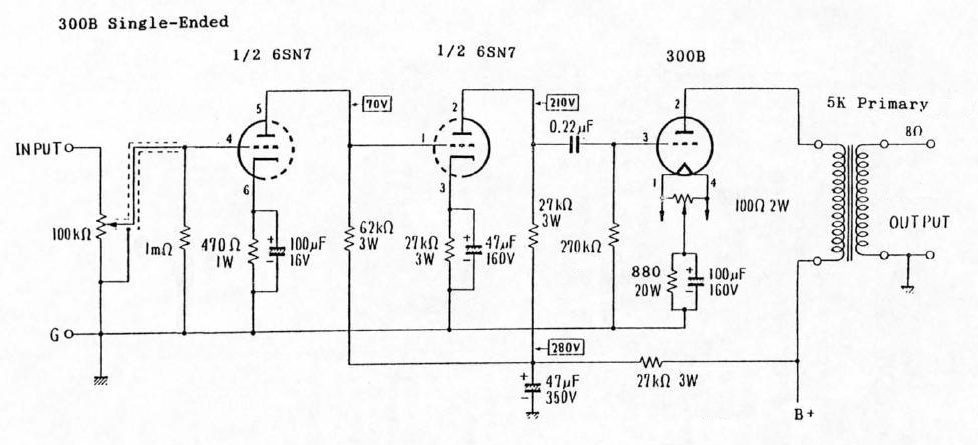

In case anyone is interested in building this, I uploaded a BOM and the final schematics.
I have no doubt there are other and likely better ways to build a 300B amp if you have the extra funds. But for someone on a tight budget I think you could do a lot worse than this one turned out. It sounds very pleasant to me 🙂

I have a question - could the 47K resistor on the top anode of the cascade be replaced by a plate choke? Reason would be if there was less HT available, e.g. if the outputs were 2a3s.
Has anybody tried a cascade with a plate choke on top?
I have a question - could the 47K resistor on the top anode of the cascade be replaced by a plate choke? Reason would be if there was less HT available, e.g. if the outputs were 2a3s. Has anybody tried a cascade with a plate choke on top?
This looks like a pretty unconventional idea and maybe not a very good one, but a pentode with a plate choke has been discussed here...
Pentodes and Choke Loading
With limited HT, I guess you just have to choose the input tube more carefully.
Patrick Turner loved doing that, there are a lot to pick up from his webpages...
afaik, the choke will have a series resistor also in order to speed it up and to establish idle dc conditions..
gain is gm x Rl, where gm is the gm of the lower triode, and Rl is the impedance provided by the choke is paralleled with the upper triode plate resistance and the next stage grid leak resistance...
