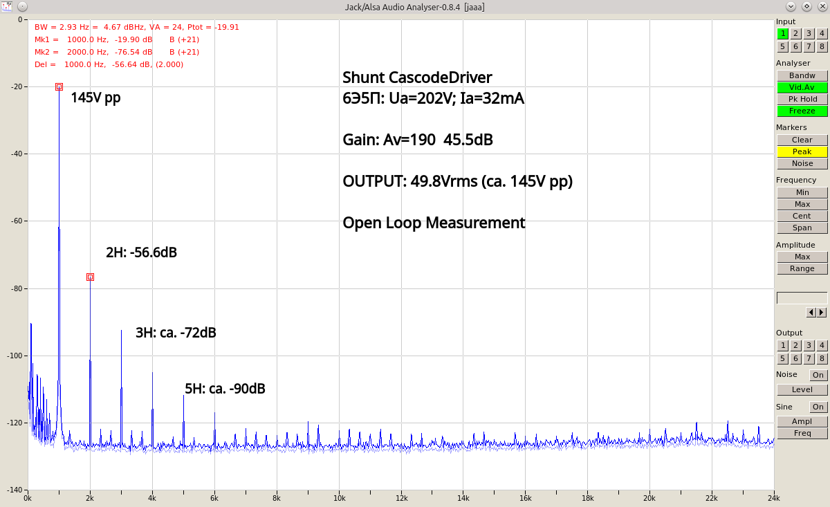

The 6Э5П (6E5P) in my Shunt Cascode design is the best sounding - and measuring - so far...
Can you elaborate more in this? I would be interested in trying the 6E5P in a driver stage that sounds more than adequate...

It's my Shunt Cascode design.
Here it is, with the open-loop measurements at 145V pp. see how the cadence of harmonics is gradual, and natural. It sounds as good as these readings suggest!
The gain is 190, so it runs as a single stage, directly from a DAC (the capacitance is very low too).
The high gain means it needs a carefully laid-out circuit board, but it need that for the regulated voltages, anyway.
It also needs a servo, unless you don't mind occasional readjusting.
I am working through the tests on a new PCB with all these features, and a few more, right now.

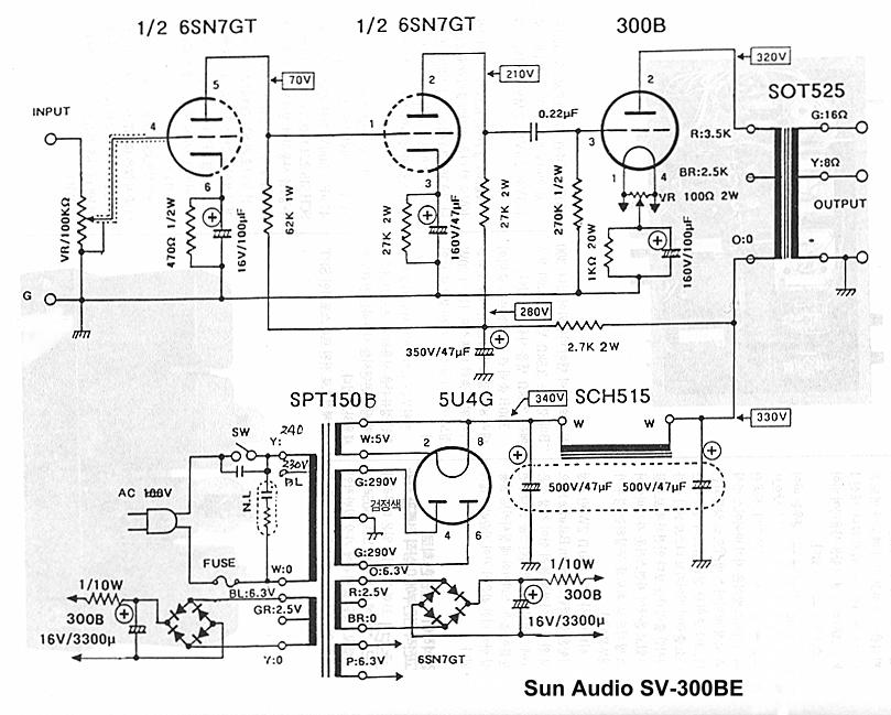

300B amp based on the classic JC Morrison 6SN7
JC published a small pamphlet of schematics back in the 1990s in a plastic folder. I don't know where my copy is at the moment, but as I recall it was a combination of a few USA domestic PP schematics along with several Japanese ones from the 1970s and 1980s. One of the schematics in that folder was the Sun Audio SV-300BE.

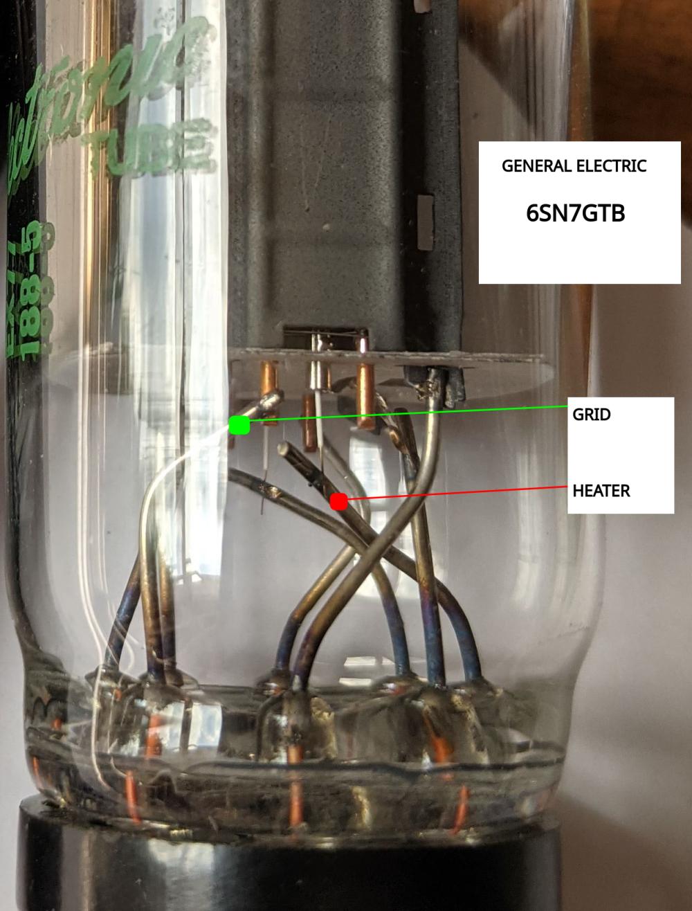

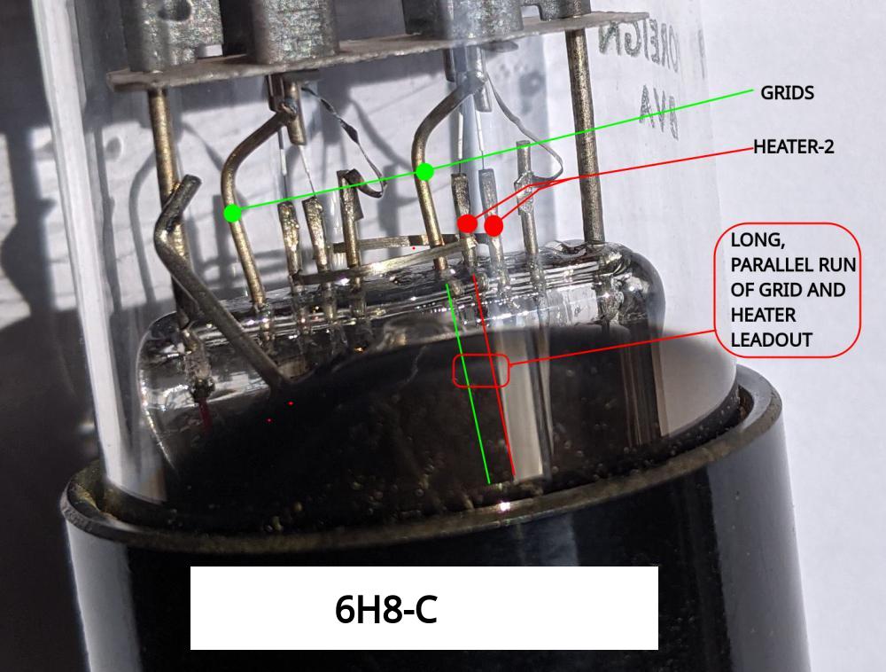

Bias voltage on the heaters addresses problems of thermionic leakage between heater and cathode. It has no effect on direct EM-coupling from heater-to-grid, which is the weakness I noted with the 6H8-C.
The flaw with the 6N8-C is the dress of the lead-outs internally, with the grid running close to the heater in their design.
The photos show a comparison of a couple of samples from my hoard.
On the left is the 6H8, showing in detail the questionable lead routing. Notice how the two sides have different routing, and different gaps from Grid to Heater. This is no surprise - they were hand-assembled. Some of them are OK, some of them are markedly worse.
The other pic is of the internals of a GE 6SN7 - no worries about Grid-Heater lead-out with these. Note also the GE's grid supports are copper - better grid-cooling, to avoid the risk of grid emission.
The Soviets produced some good valves later, especially the TFK-based designs, and their original-design frame-grid valves. But the 6H8-C was not in the same league as one of those.

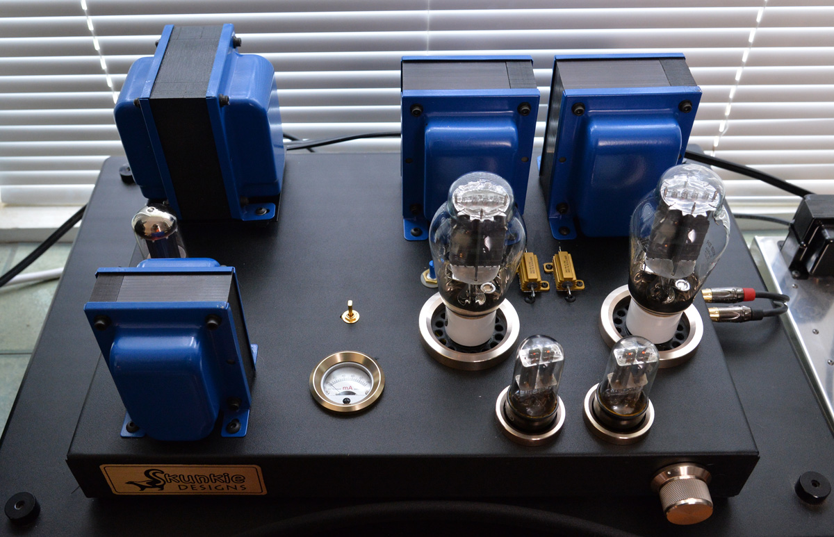

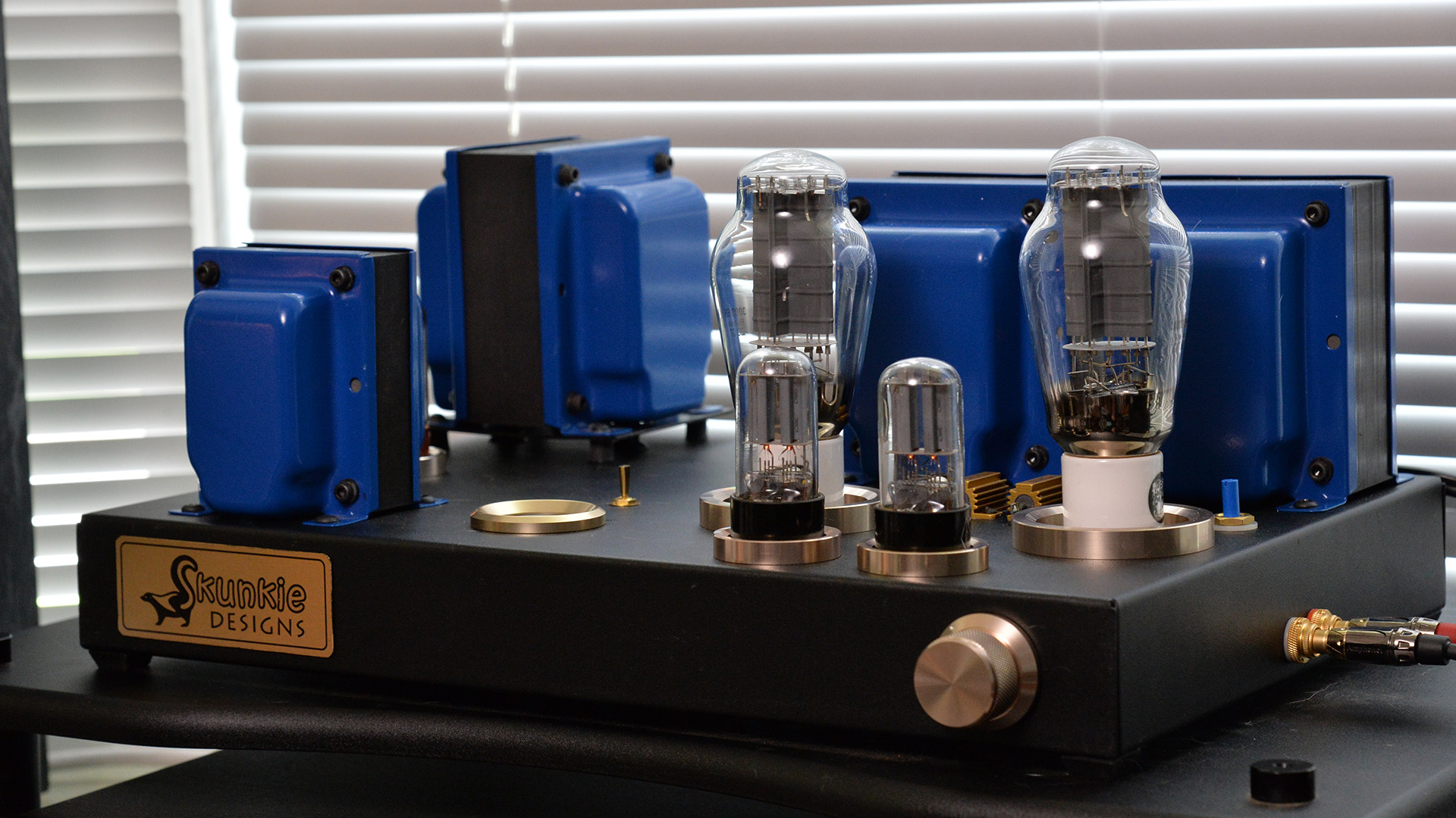

Final build pictures
I wanted to upload a couple of pictures of the finished amp. Right now I am letting it burn in, but it sounds really good just following the JC schematic + regulated heaters. I plan to play around with a variety of mods but wanted to let everything settle in for a week or so, plus do some tube rolling. The 300B is running at 360V across it at 80ma, which it should have a long life living there.
The total cost came in just under $900 all in, with all new parts including the tubes. The only way I can see to reduce the cost further would be to go with AC heaters or go for used parts. I already had this iron from a KT88 SE build I did, so I ended up with less than $500 including a new chassis.
Stephe -- Maybe I missed it the videos, but what are those rings around the tube sockets? Where did you get them? How are they attached to the chassis?
I like the look of them. Might help hide my less than perfectly circular vent holes.
cheers and thanks, Derek
I bought them from Tube Shield Ring Washer
They bolt in from underneath though small holes drilled in the chassis and also hold the tube socket in place. I think they look great and give the amp a clean look.
Awesome. many thanks. I'm going to get some.
I also buy my knobs from them, you can see the ones that match that gold color, and they also have silver in a variety of styles. I've bought tubes from them too, good service.
