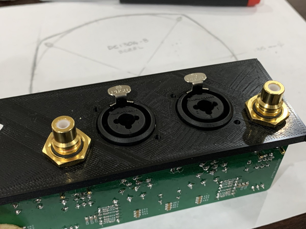

I am working on a verification build of an ultra compact BTSB with XLR/TRS and RCA panel mount jacks...

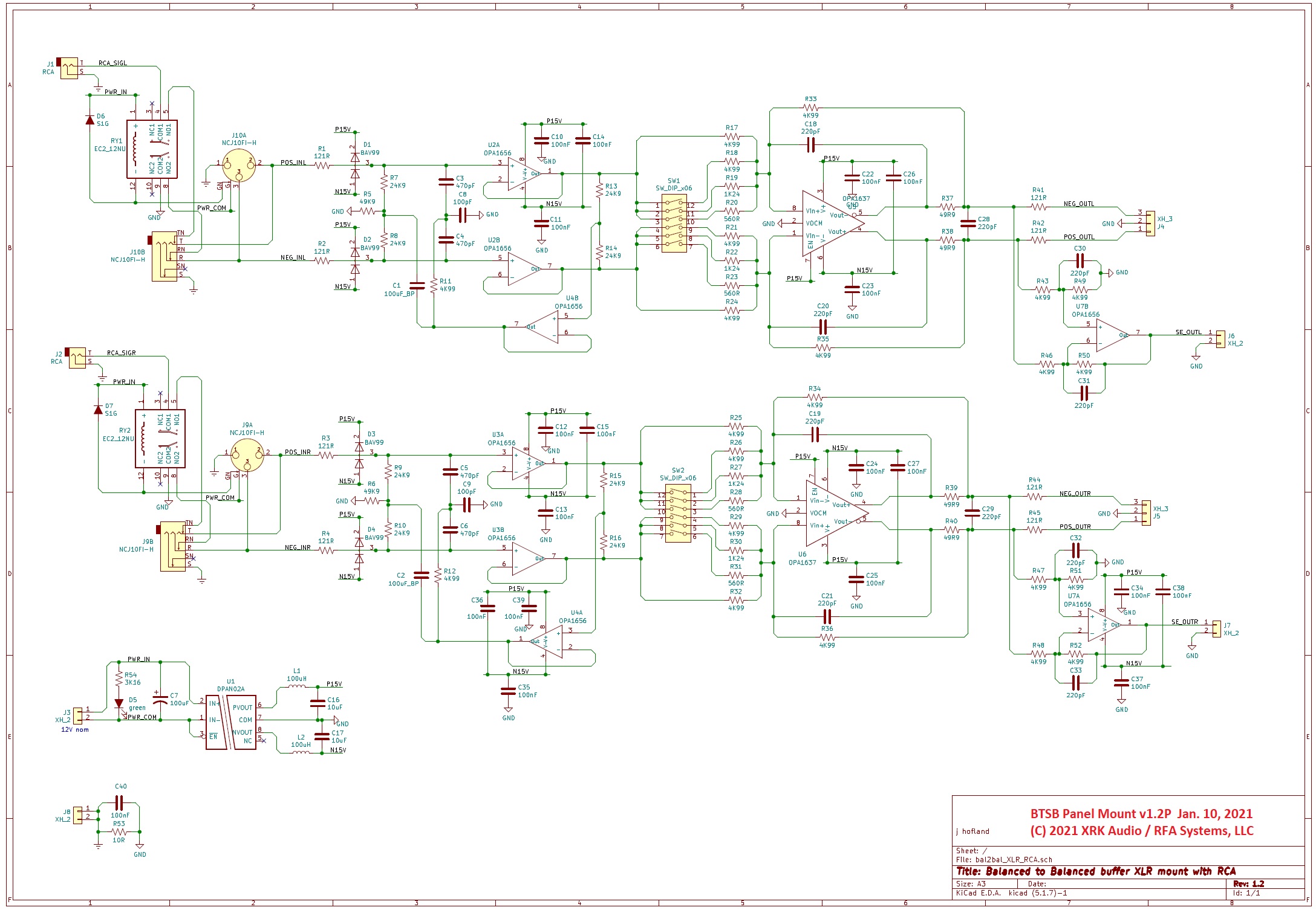

Here is the schematic and BOM for the new 90deg BTSB Panel Mount v1.2p board.
attachment.php
BOM is a zipped Excel file.

A minor correction X. The differential amplifier gain does not have the 1+ in it. so the 1X gain is (R29/R19). To get higher gain the appropriate resistor parallels R19. So for x5 R19 is connected in parallel with R18, which is 1/4*R19 in value.
XRK - just a quick question on this calculation. Reading literally this equation I may use your buffer as a attenuator (by setting R19 higher than R29). But is this a safe in terms of stability and other performance parameters?
I am looking for -9, -6, -3, 0, +3, +6, +6 dB buffer/attenuator/gain stage with BAL/SE/BAL functionality and wondering if such idea is actually a proper one.

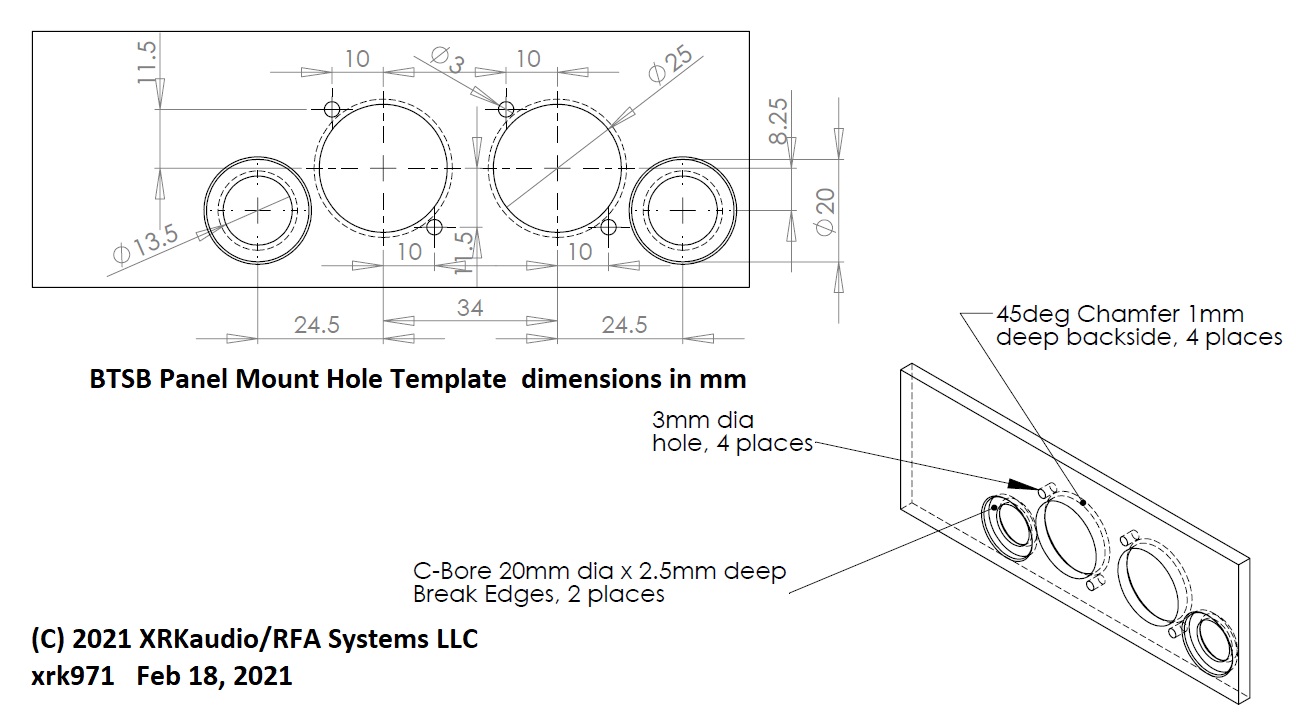

Here you go...
attachment.php
Fit has been checked with 3D print for a 4.7mm thick panel with chamfers to allow the jacks to swing into place. For thinner panels, you may not need the chamfers.
attachment.php
One of the folks asked if it is feasible to adapt the design from 4 switchable gains to 7. It is if you now use a 6 position dip switch for each positive and negative half into the differential amp and size the input resistor corresponding to all the switches open to the -9dB choice and calculate the remaining ones in parallel with that first resistor to get to the remaining gain choices. As an example, using the feedback resistor of 4K99 an input resistor of about 14K1 results in a gain of about -9dB. If you just want to use the design as it is with different resistor values paralleling the 4K99 input resistance you will onyl realize 4 or 5 practical choices of gain and not the nice spacing you are asking for.
