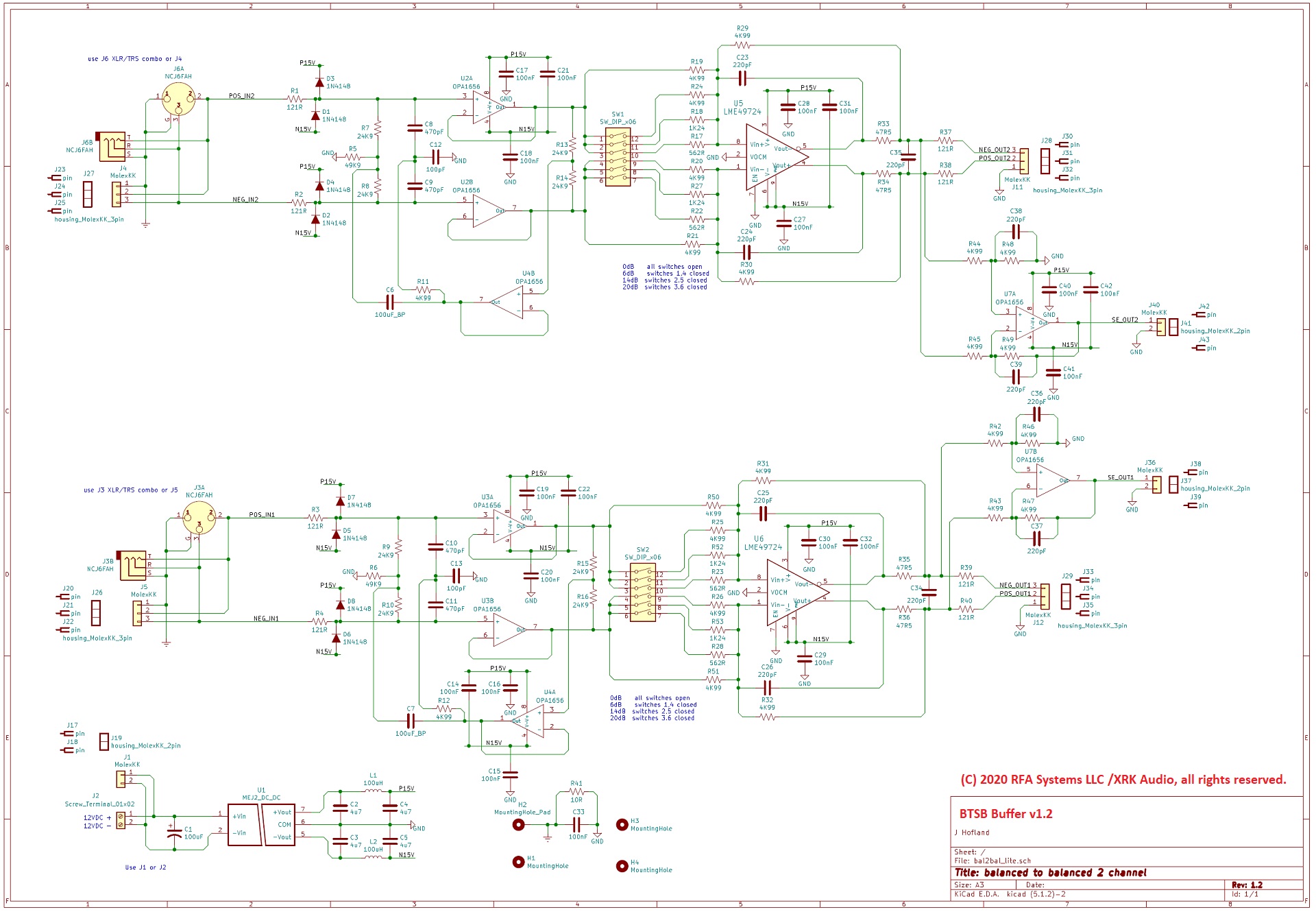

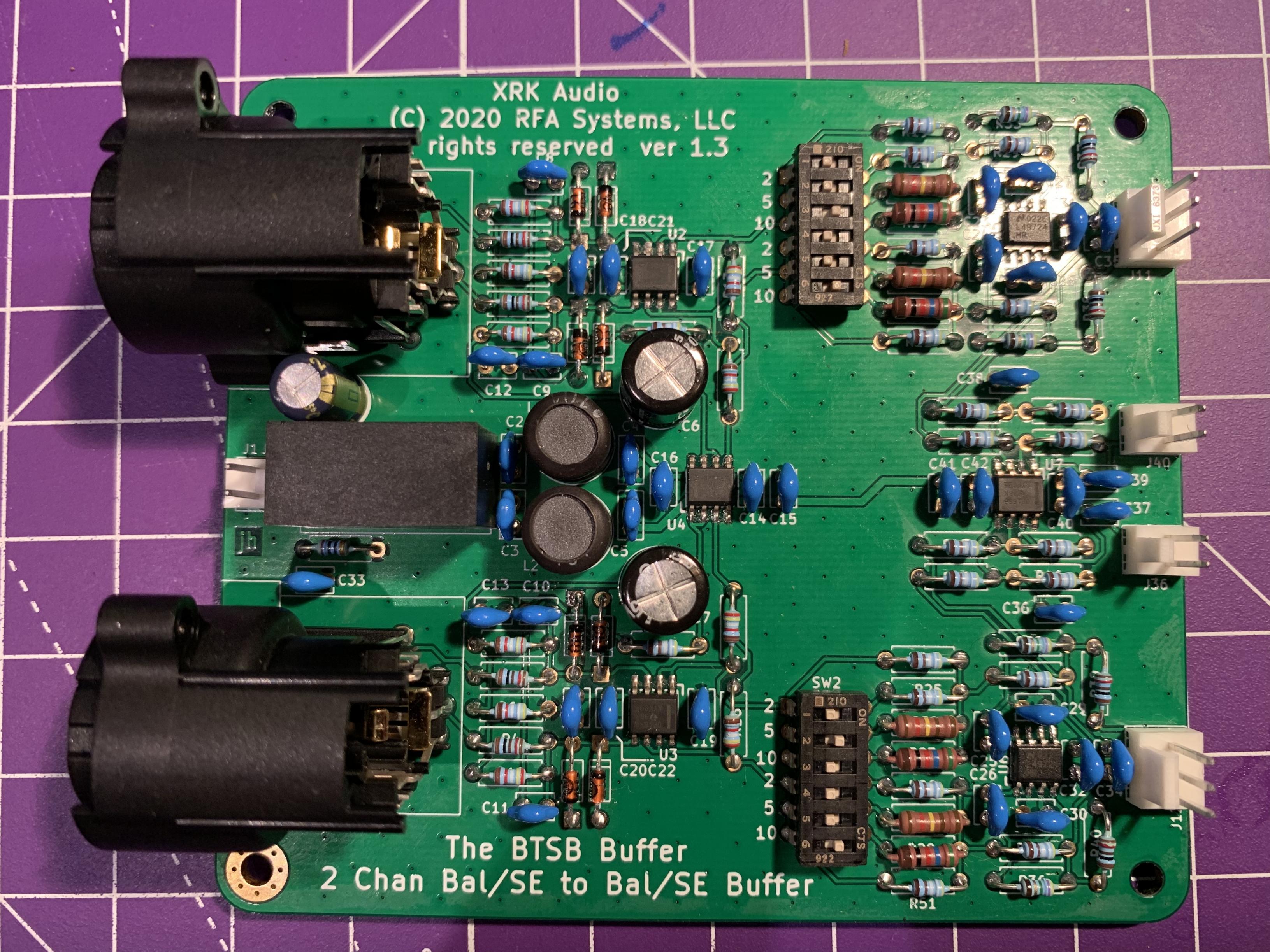

Does anyone know how to calculate resistor value different gain than stock buffer?
I am looking to get 14db gain
The gain is set by the input resistors (Ri) from the DIP switch and the feedback resistor Rf . For non inverted opamp, gain is (1+Rf/Ri). Default values for BTSB are for 0dB, 6dB, 14dB, and 20dB. Simply selecting the 14dB switch will get you what you need.
Note that for the 14dB setting, Ri is 1.24k and Rf is 4.99k. So G=(1+4.99/1.24)=5.0x or 14dB.
A minor correction X. The differential amplifier gain does not have the 1+ in it. so the 1X gain is (R29/R19). To get higher gain the appropriate resistor parallels R19. So for x5 R19 is connected in parallel with R18, which is 1/4*R19 in value.
Oh silly me, thanks for pointing that out. I missed the fact that there was an ‘always on’ 5k when I tested the math.

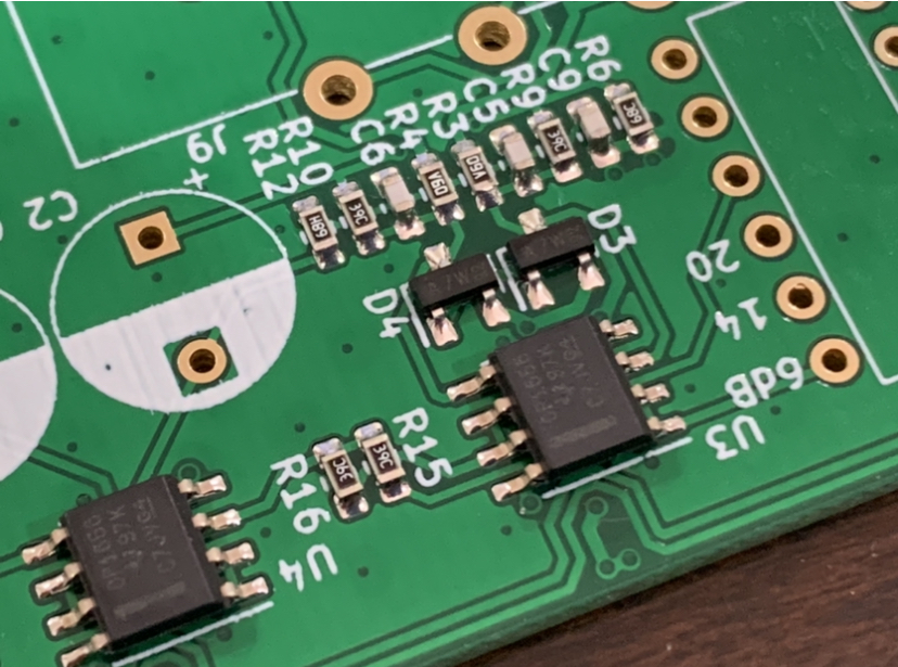

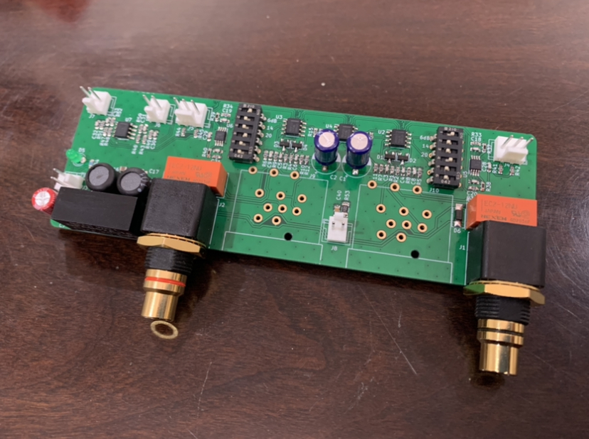

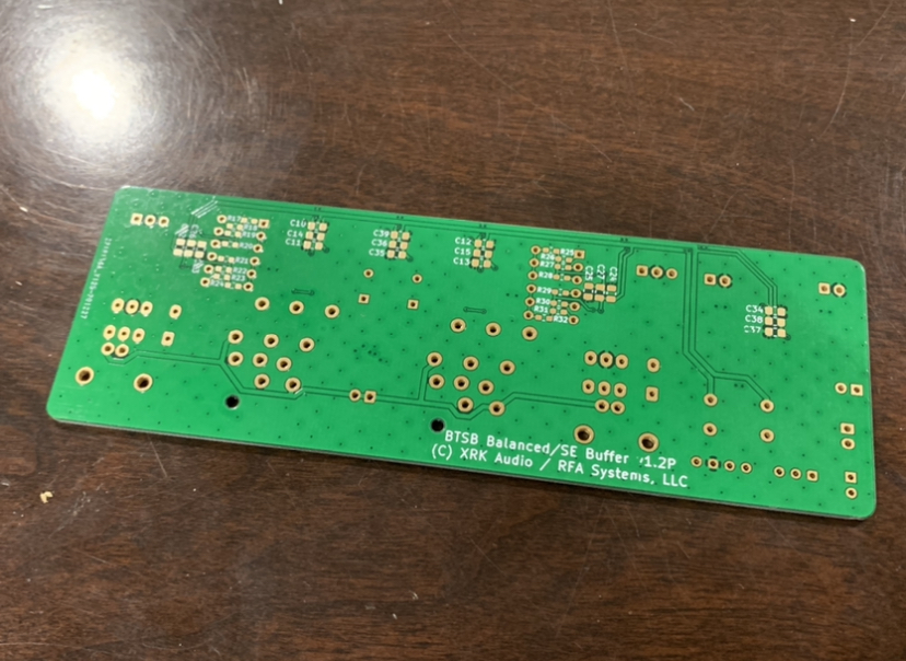

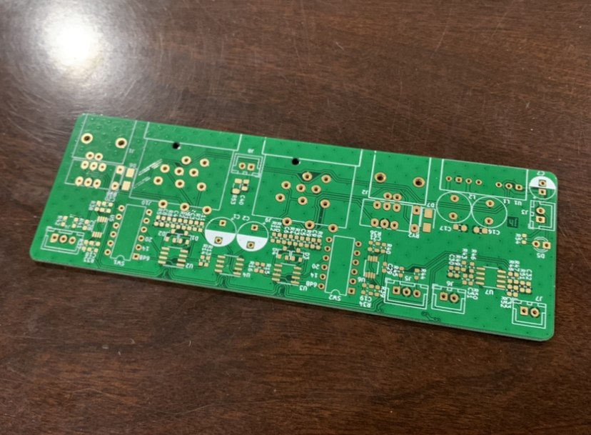

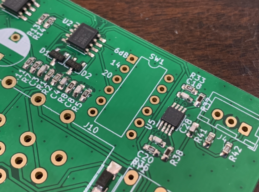

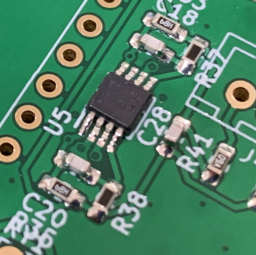

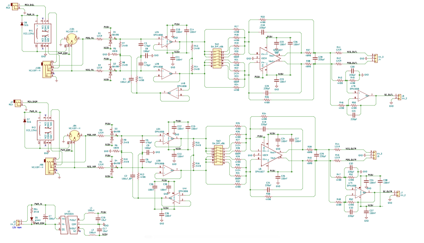

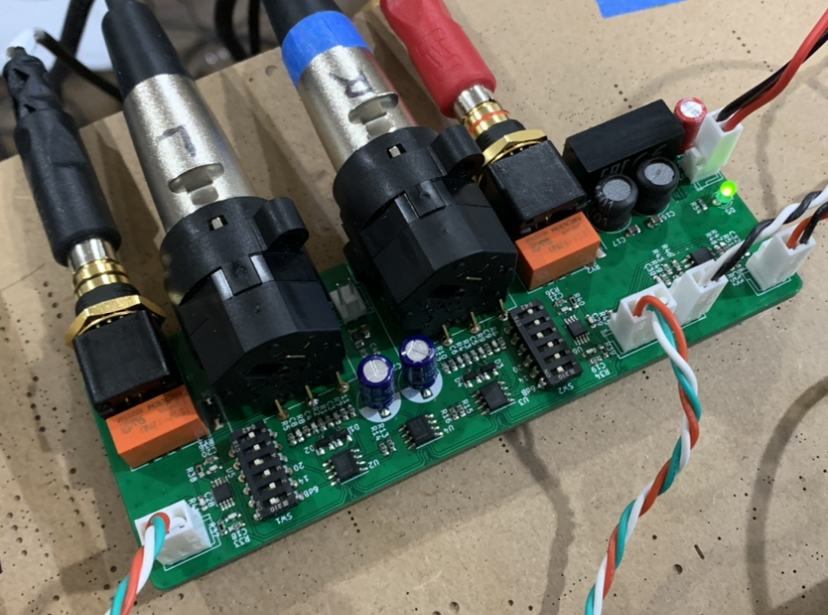

I am working on a verification build of an ultra compact BTSB with XLR/TRS and RCA panel mount jacks. It will be ideal as a universal front end input for a lot of projects. It’s going to be mostly 0603 SMT components for compactness. Jhofland is using an OPA1637 now for the balanced driver. One very cool feature is that this board has auto switching relays that control whether or not single ended RCA’s are being used and switches the RCA off when a TRS or XLR is inserted. Everything will be powered with a single 12v input as usual. I am not sure how many people want to attempt building an 0603 SMT project so I am exploring how much interest there would be in a RTR prebuilt and fully tested unit.
Panel jacks will be Neutrik XLR/TRS combo with lock. RCA jack will be premium Elecon (gold plated with Teflon insulators and high density thermoplastic body - same as on Yarra preamp). Board simply hangs off the panel jacks which are screwed in with own mounting screws and RCAs have main body nut.
Schematic:
Schematic:

Hanging from front jacks
I personally don't want to mount a board without support on rear corners. Please add rear standoff mounting holes.
Each XLR/TRS jack has 11 pins to secure the board to the jack which takes all the stress of insertion and removal. The RCA jacks have two mounting pin bosses and two conuctors for a total 30 soldered points of mechanical connection to support the relatively small PCB. Adding holes on the back edge of the PCB would require exact holes on two 90 deg surfaces to line up perfectly. I don't think screw support holes for extra standoffs are necessary.
Actually, the pcb has no stress at all and does not require additional standoffs. The XLR and RCA jacks are mechanically attached to the rear panel where the connections are made.

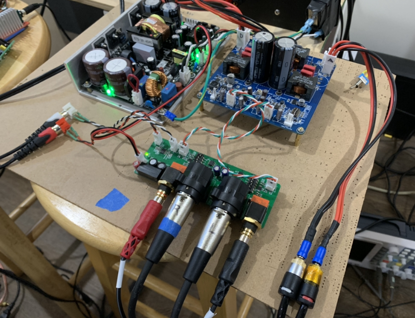

All assembled and waiting for the combo 90 deg Neutrik XLR/TRS jacks to arrive. A new Meanwell isolated DC/DC converter provides regulated +/-15v rails for some extra headroom to drive low gain power amps.
Detail of new OPA1637 balanced line driver:
Schematic:
Hi X, I am very interested in this last BTSB version and for example I personally don't have any problem with 0603 size. BTW is there any benefit from OPA1637 vs LME49724. And aproximetly with prices components in EU (mouser store) is a little advantage for me buy bare PCB with non populated components.
Let me make sure this board works and if you are interested I can certainly offer it as a bare board. Many people shy away from stuff smaller than 0805, and in some cases 1210 causes heart palpitations. 🙂 I think specs on OPA1637 are better from low idle current standpoint (~1.5mA). The THD is not as good as LME47924 (0.00003%) - but 0.0001% is fine for audio use. It doesn’t have a belly pad so technically could be soldered without using paste. Although the pin pitch is tiny.
The new BTSB Panel Mount edition checks out beautifully. Everything works as it should. The relays auto click and clack to disengage the RCAs when a balanced plug is inserted (XLR or TRS). Gains check. The polarity of the SE outputs check as well. Even mono in via the TRS with RCA adapter checks. The relays do indeed disconnect the RCAs as that was checked. Another super design from Jhofland!
