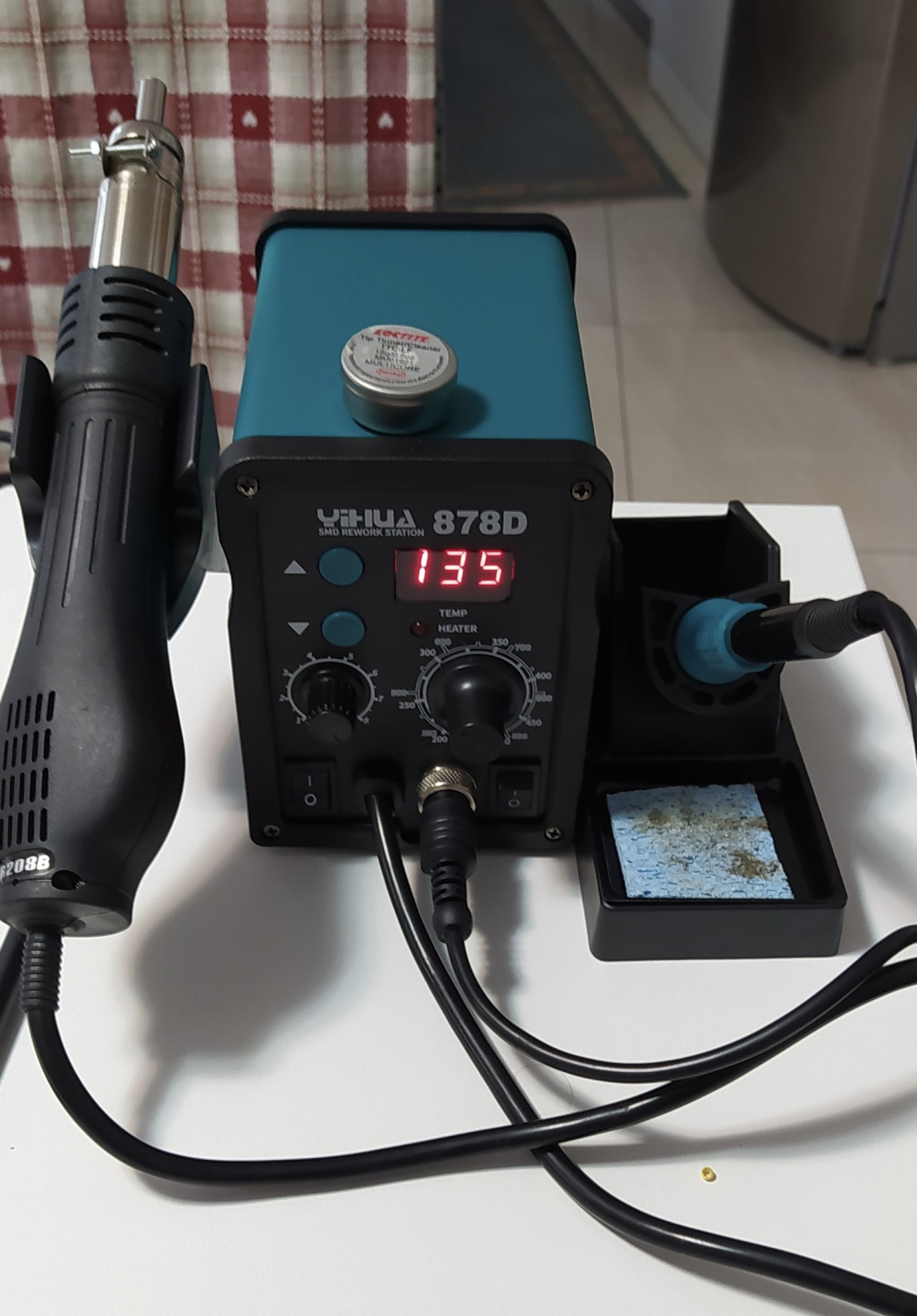

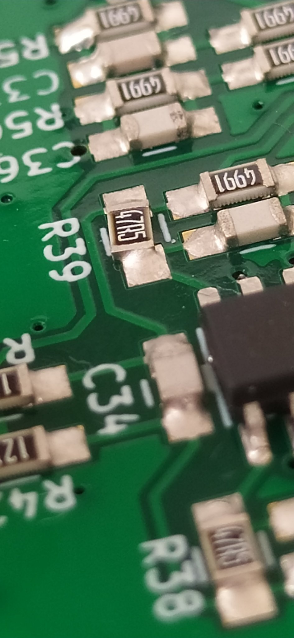

Thanks, I'll check the R39. And it is also stored at an angle. What temperature do you have set when using SMDLTLFP? I had heated the PCB to 120°C. I used an old clothes iron. Thank you for your reply.
If your solder is PbFree try 360C, if 60/40 Pb/Sn then try 320C.
Use some flux and the surface tension of the melted solder will align the chip resistor. You could just leave it as it is as it is mostly a cosmetic issue.
Practice with a scrap PCBA to develop your skills. Using the iron underneath is a good idea but not necessarily needed as there isn't too much additional thermal load to heat; that is, copper etc.
That looks like a good solder joint. Just cosmetically misaligned but should work. It’s quite clean - free of small solder balls etc. what brand solder paste are you using?
Oh, it's a low temp alloy... Sn42/Bi57.6/Ag0.4, melting point 138C
Recommended reflow temperature is 165C

These data are in the technical documentation. I am interested in the practical setting of the hot air station. I had to have about 200°C to work well with this paste.

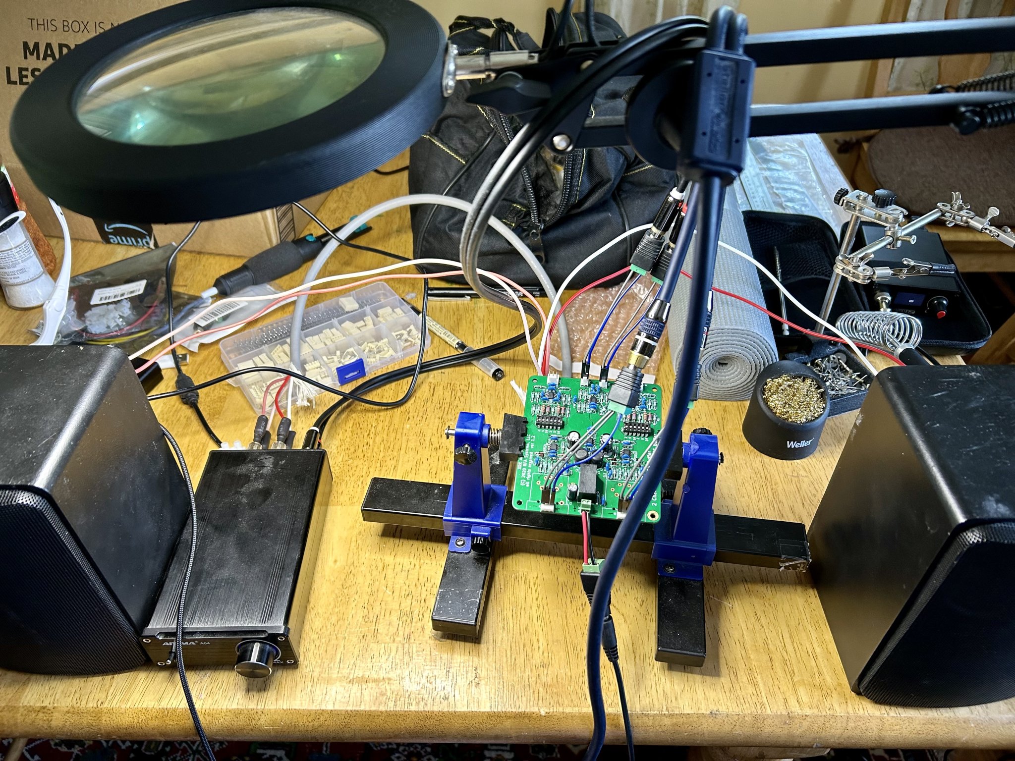

Happy update!
I was bummed I couldn’t figure out what was causing trouble with my board and really didn’t relish the idea of taking measurements at every point, so this project sat idle for a while.
Jut now decided to give it another look under magnification. One end of the Murata solder joints looked a bit off, so I removed that pin’s solder and resoldered it. Eureka! Everything works! I’m not a failure after all.
Now I have two of these working well, one in an enclosure and one as a free board. This makes me happy.

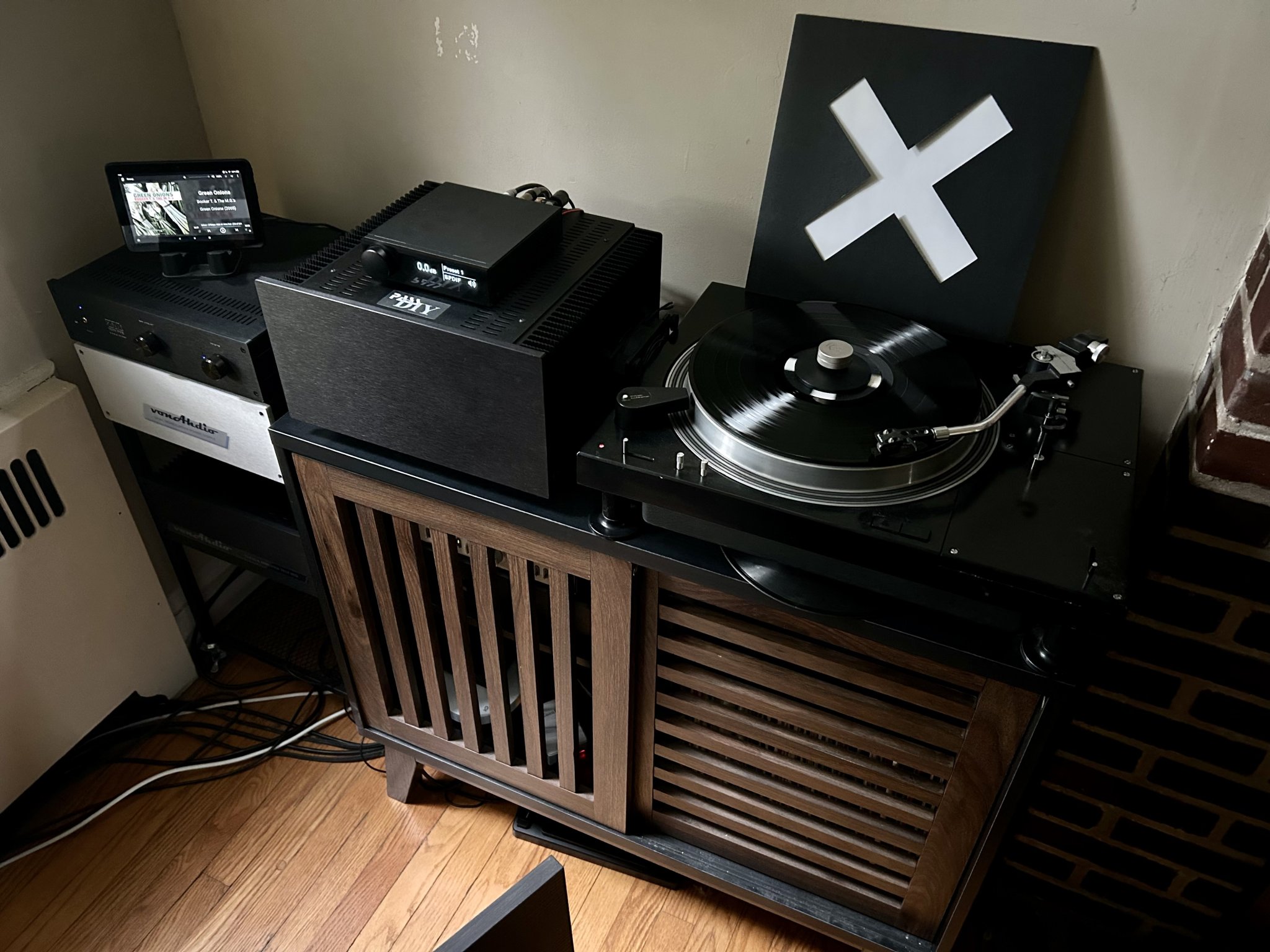

My current ideas for use are the TDV and the LU1014D OPS I luckily won from schultzsch. Those are the no-voltage-gain amps I have currently. I also have a M2 OPS build brewing in my mind.
The one in the enclosure I use for my vinyl rig when needed between my phono pre and whatever else is next (ADC or analog preamp).
I would love to see what kinds of projects folks who have built this board are using it in. Please share photos of you can.
Do,
Thanks! Big compliment from a builder whose builds are super neat and tidy!
It’s a Vcap ODAM with Miflex copper bypass.

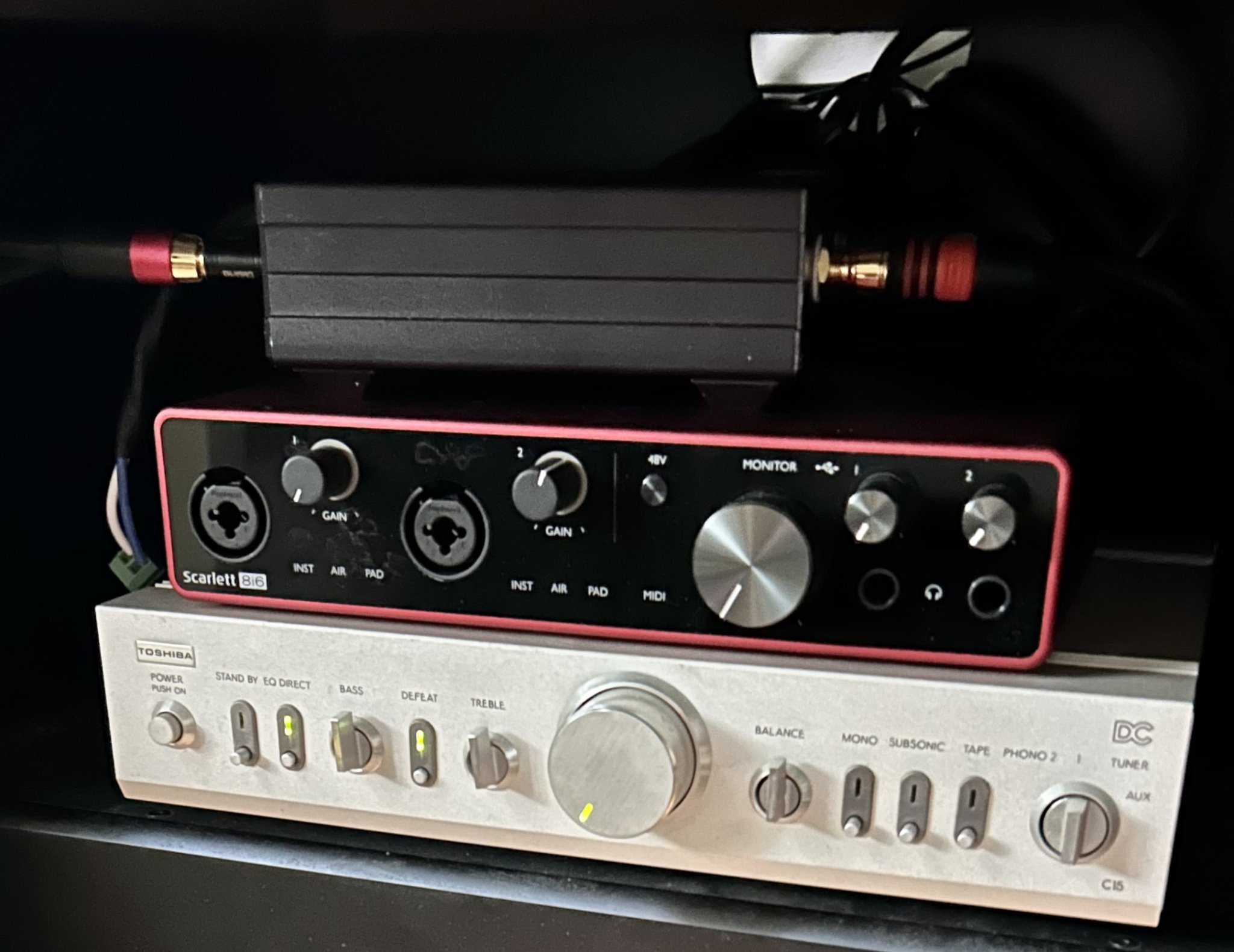

Here is a polar opposite photo to Anand’s. It’s just a black box with my BTSB in it.I would love to see what kinds of projects folks who have built this board are using it in. Please share photos of you can.
I use it to boost the MM phono output of my vinyl setup. The setup currently consists of:
- Technics SL-1100 table
- Pickering XUV cart (LPGear D4500Q replacement stylus)
- Toshiba SY-C15 Preamp (Phono input to tape out)
- BTSB (set at max gain)
- Focusrite Scarlett 8i6 (for ADC)
- MiniDSP Flex Eight (for DSP PEQ)
- Zen Mod Iron Pre SE (for Fugly goodness)
- Zen Mod Scryer amp (for even more Fugly goodness)
- DIY open baffle 3-way speakers

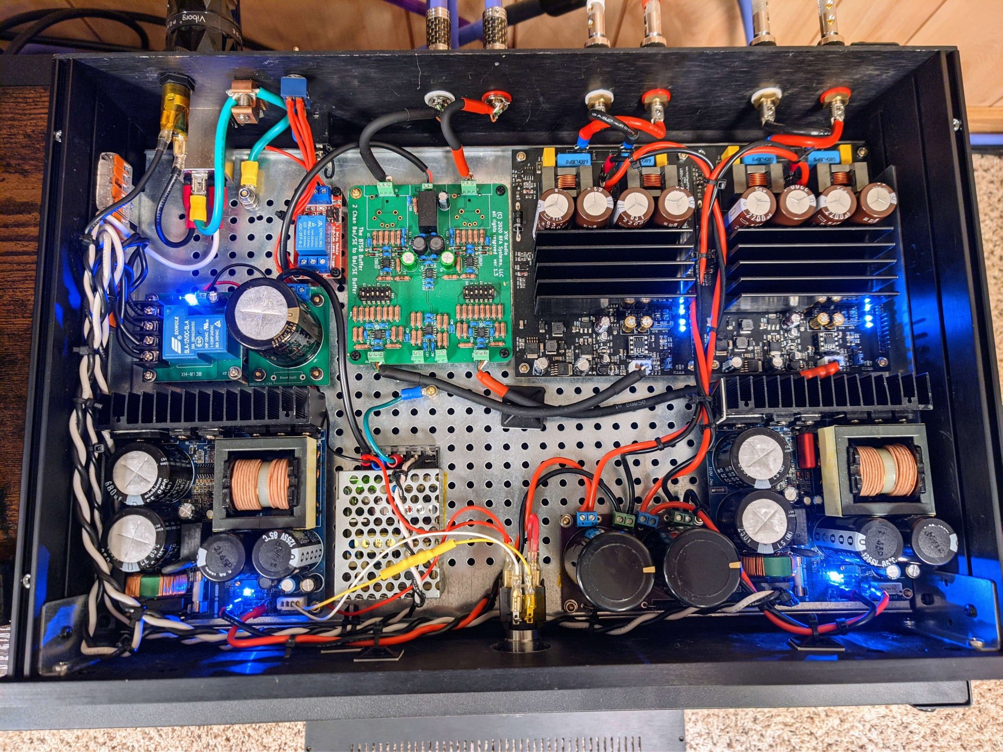

Here's my current implementation of the BTSB. Parts are..
Let's say I am interested in something like that, do you happen to have a schematic available? I don't mind designing my own boards, but I don't know that I could pioneer a circuit along the lines of your SSR headphone protection or something.
- Modushop Slimline 2u 280mm deep, fully vented top
- 2x Connex Electronic SMPS600RS
- 2x Sylph Audio D400M TPA3255 boards
- BTSB w/ 6800uF PSU capacitor to keep it online past amp decay
