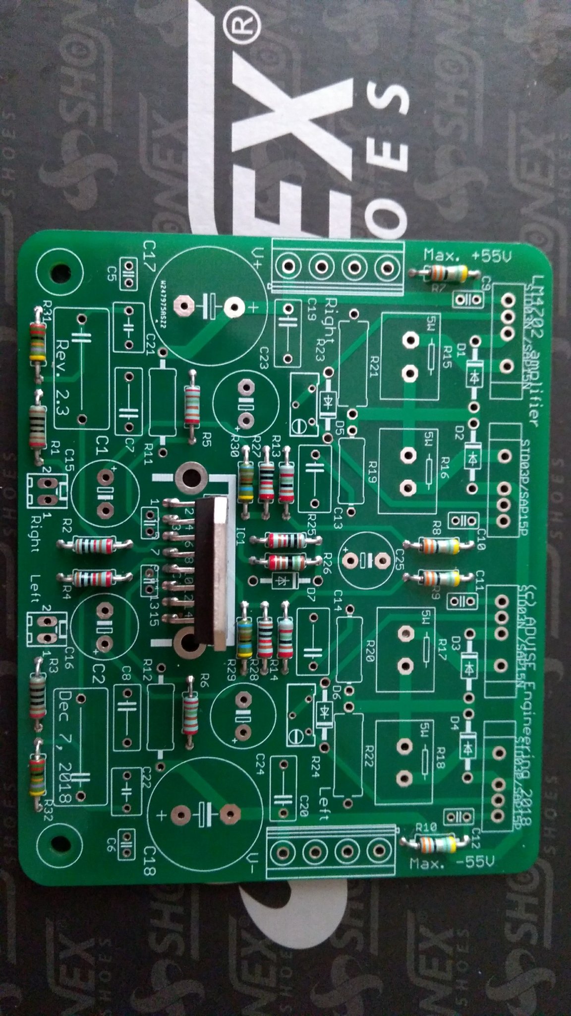

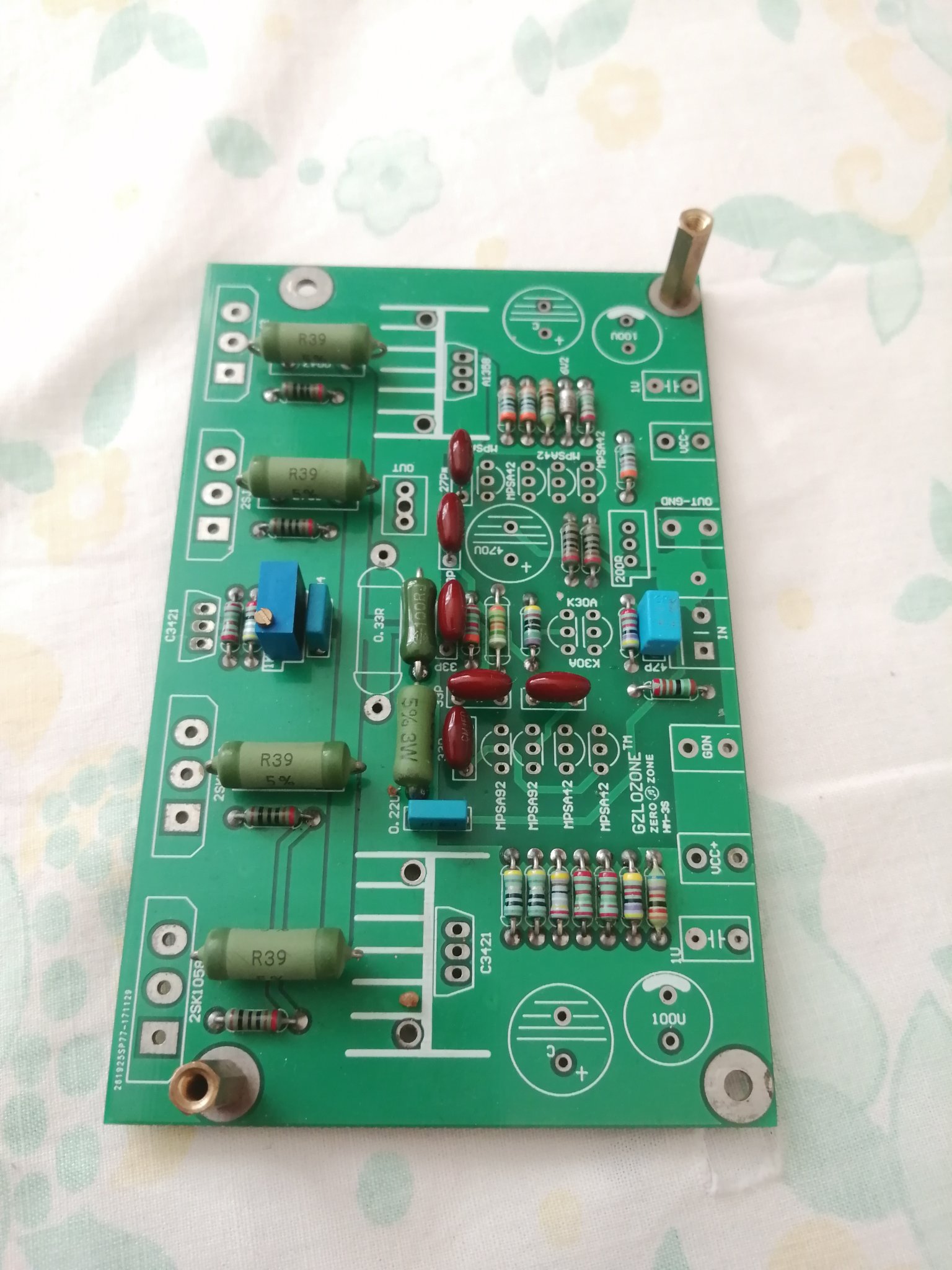

Hello my friend, yes it is very fun, I have a power transistor deficiency for 4b stt. I recovered my Goldmund clone, I'm missing a mosfet.No, I have purchased boards but now Iwork on several other projects (*) and build DIY housings for my amplifiers.
(hifi four chanel amp based on STK 4042XI ICs, 22W JLH 2005, chazis for Krell KSA-50 Mk. II, Accuphase A60, Linkwitz-Rilley active crossover... etc... Lots of fun)

Ah, MPS92. You can get it from both Reichelt and Farnel, but Reichelt sells CDIL and Farnell sells their own brand "Multicomp pro". I suspect that they are from similar source. I have tested CDIL transistors with curve tracer and I have found that they are good. Also, in a circuit I have measured decent noise flor. There is nothing to loose, they cost pennies, just transportation cost may be high.I'm missing a mosfet

ONSEMI mpsa92/42 is original in the country I am in, there is an oscillation problem, I want to use a different transistor in these goldmundsAh, MPS92. You can get it from both Reichelt and Farnel, but Reichelt sells CDIL and Farnell sells their own brand "Multicomp pro". I suspect that they are from similar source. I have tested CDIL transistors with curve tracer and I have found that they are good. Also, in a circuit I have measured decent noise flor. There is nothing to loose, they cost pennies, just transportation cost may be high.

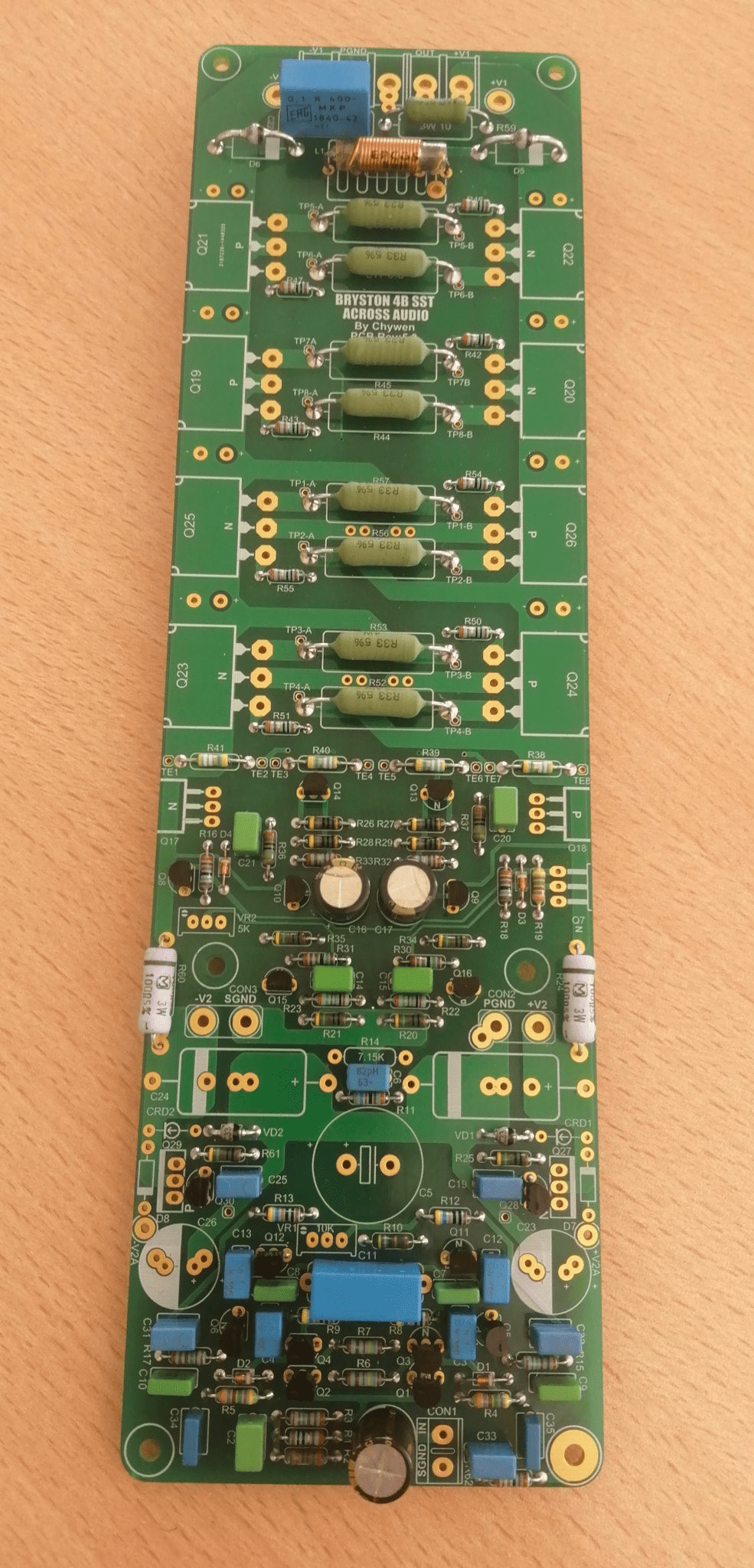

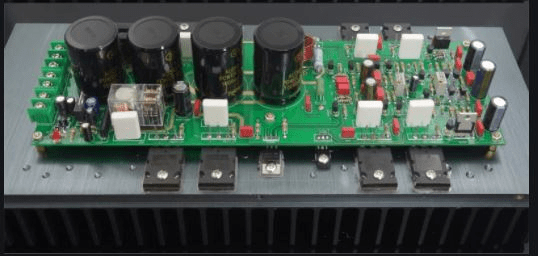

Another Bryston 4B SST board
There appears to be another board on aliexpress called "Refer to Bryston 4B SST", but this board does not look like the ones that people in this thread are building.
Anyone have comments/insights onto this board? Hi, i'm just want to buy this board instead the other on because i had a old 4B(the old pcb are not good anymore) and this board fit in the casing better than the other one, because that included the filter section and diode. So i'm just want to know if is good or not compare to the other pcb. Thanks.

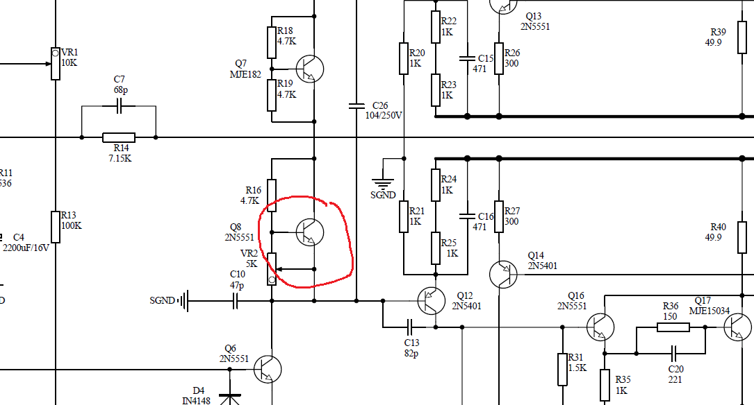

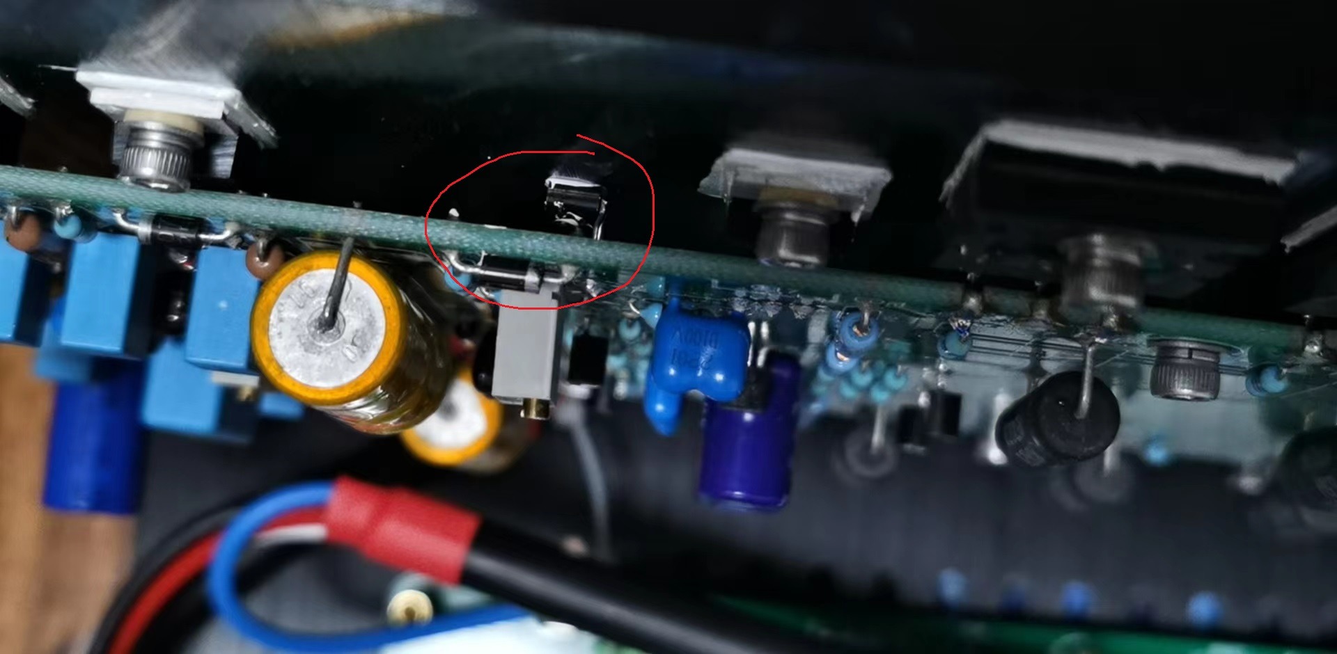

I have just built the 28b clone which works well, but I do have a question regarding the biasing.
I have had the amp on the bench with no input or output connected, whilst checking the bias and dc offset. The dc offset seems stable and fluctuates around + or - 2mV so all seems good there. The bias creeps up over a long period of time, it stayed at around 23mV across R45 for a couple of hours. I then left the amp alone for a further few hours and when I returned it was sitting around 45mV and was obviously quite warm.
The question I have is do I tweak this down after leaving it on for a number of hours or is it likely to go through a cycle of up and down and I just missed it going back down?
Any help would be much appreciated!

Install Q8 back to the heat sink will solve this problem.
