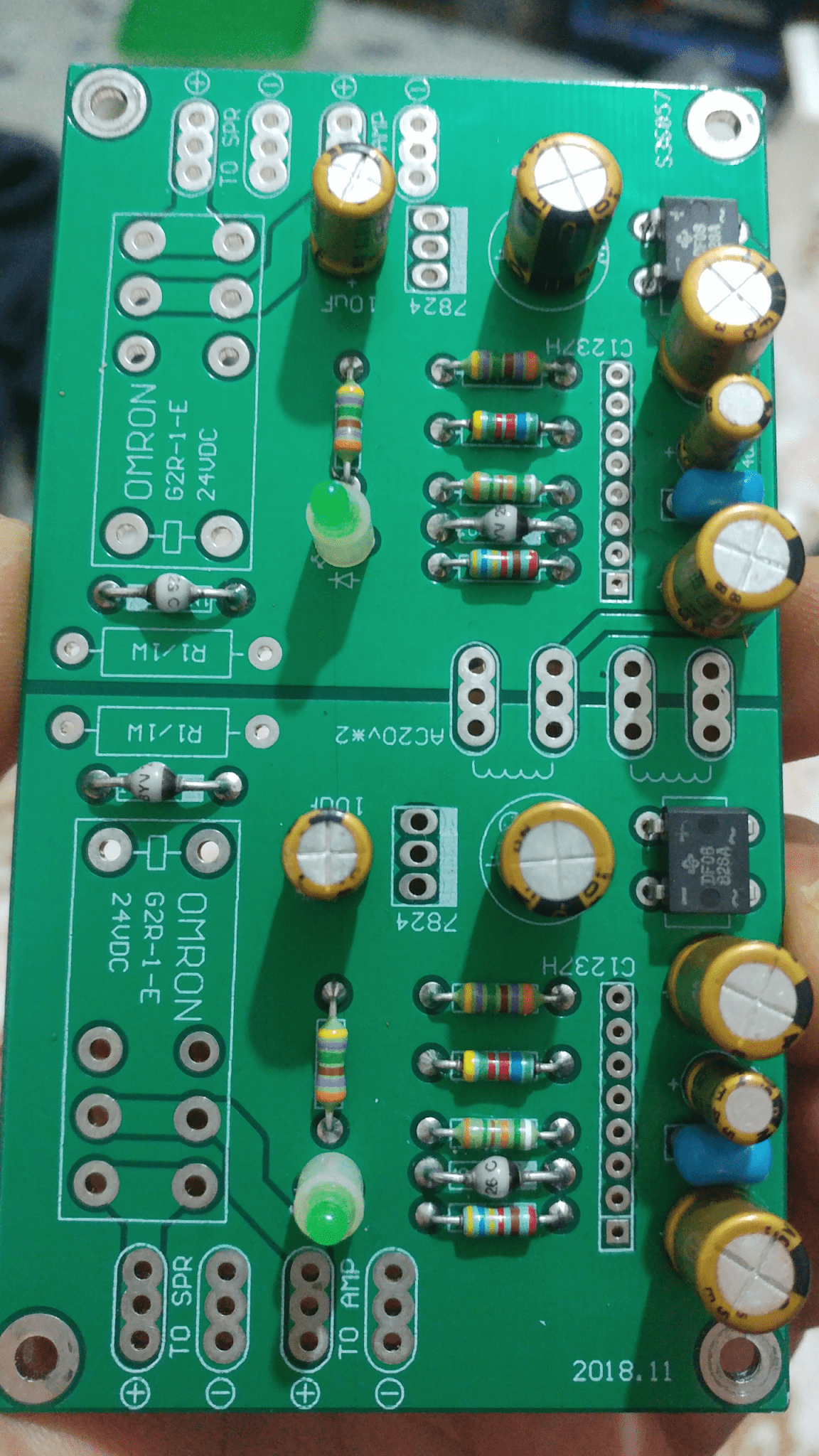

Of course. I will use also the PSU board, with everything you need integrated: Soft-start and separate speaker protection for both chanels are precious.Will you use the input module ?

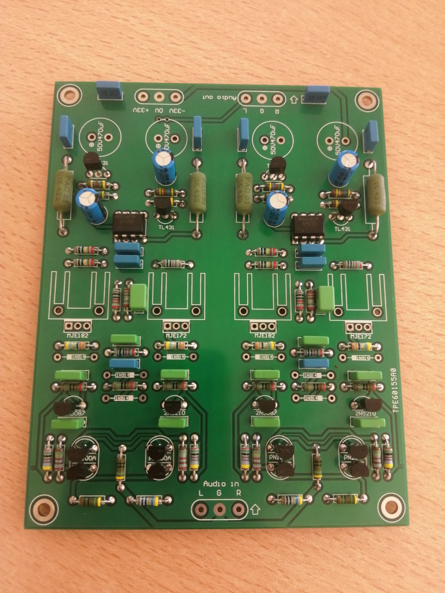

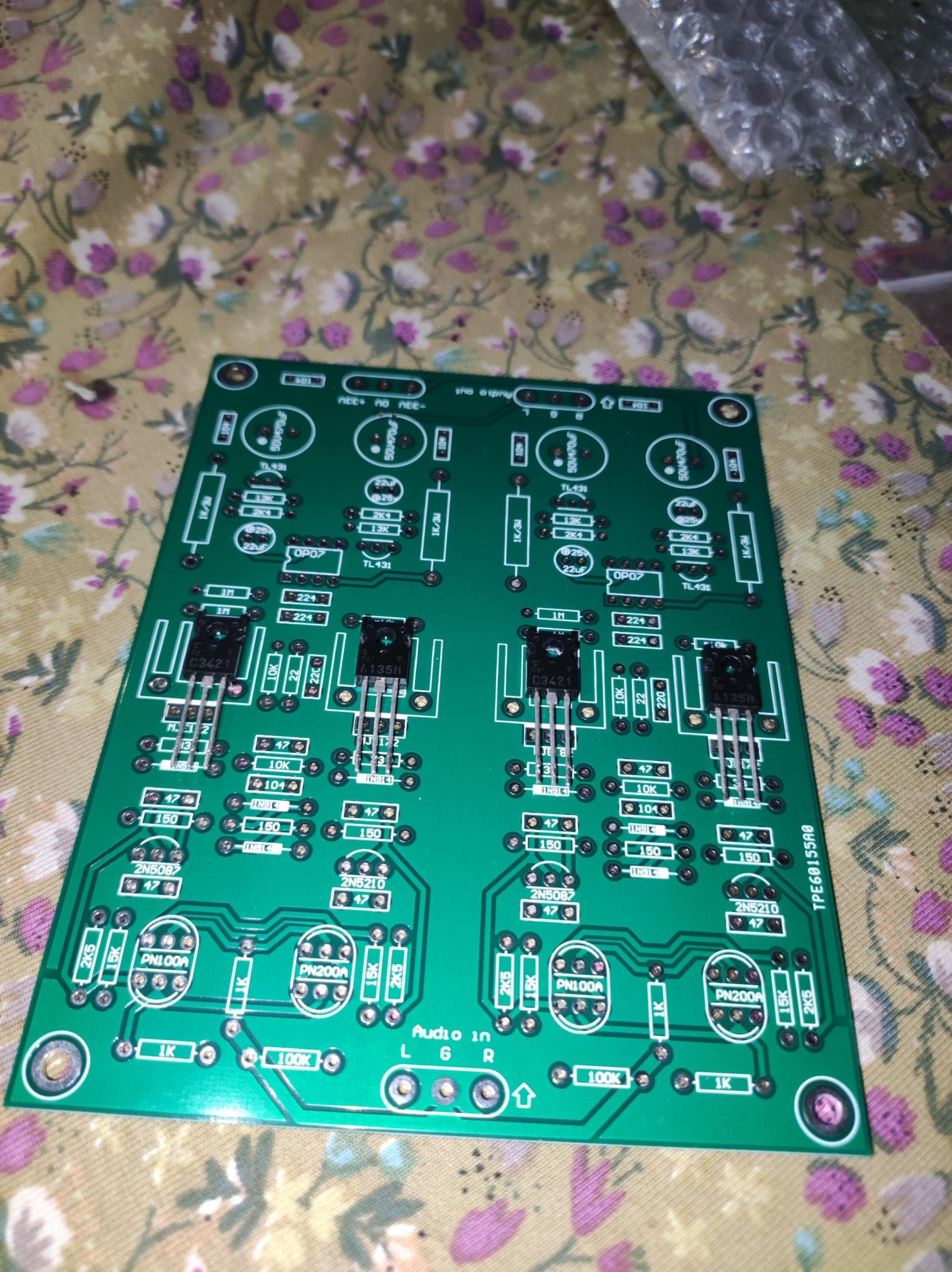

Hello hschier,Hi master of Diy. Can i use 2sc5200/2sa1943 pair like power amp for the 4B?
Have you tried a 2sc5200/2sa1943 pairs? Are there any problems with "faster" devices?
I ordered separate power supply boards on the PCB, I used them from the kit for configuration.
For double mono
For double mono

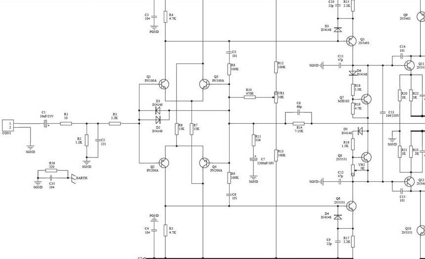

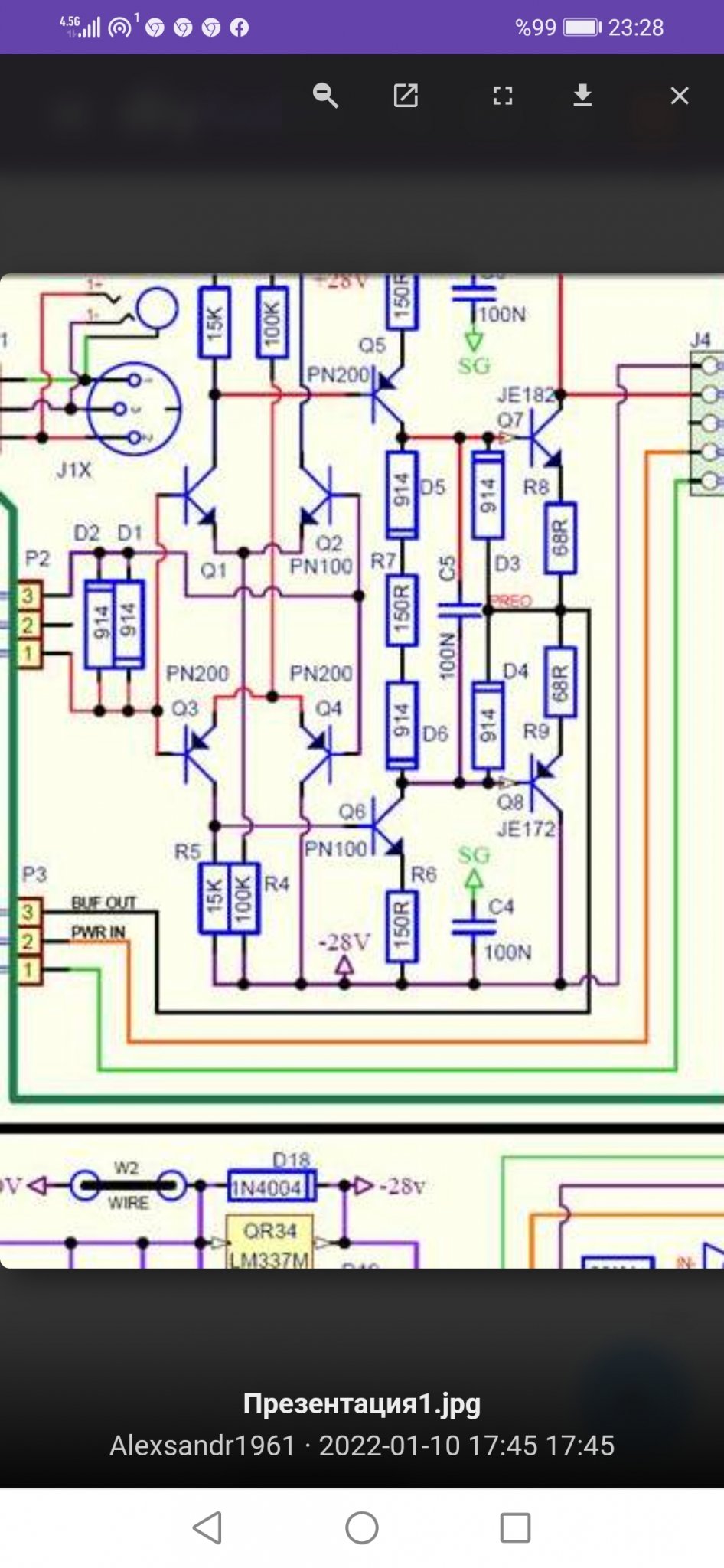

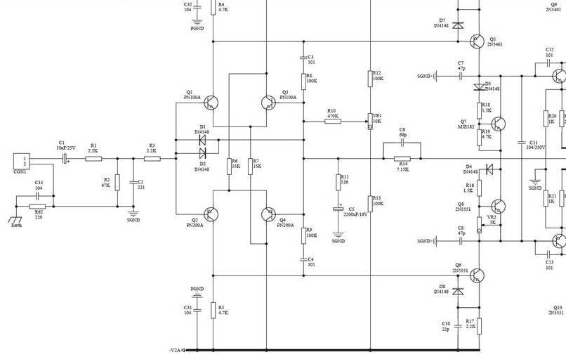

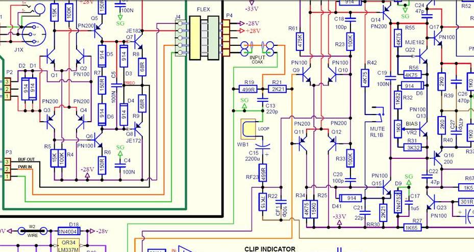

Is this part doa 33Pay attention to CF1 in the feedback.![]()

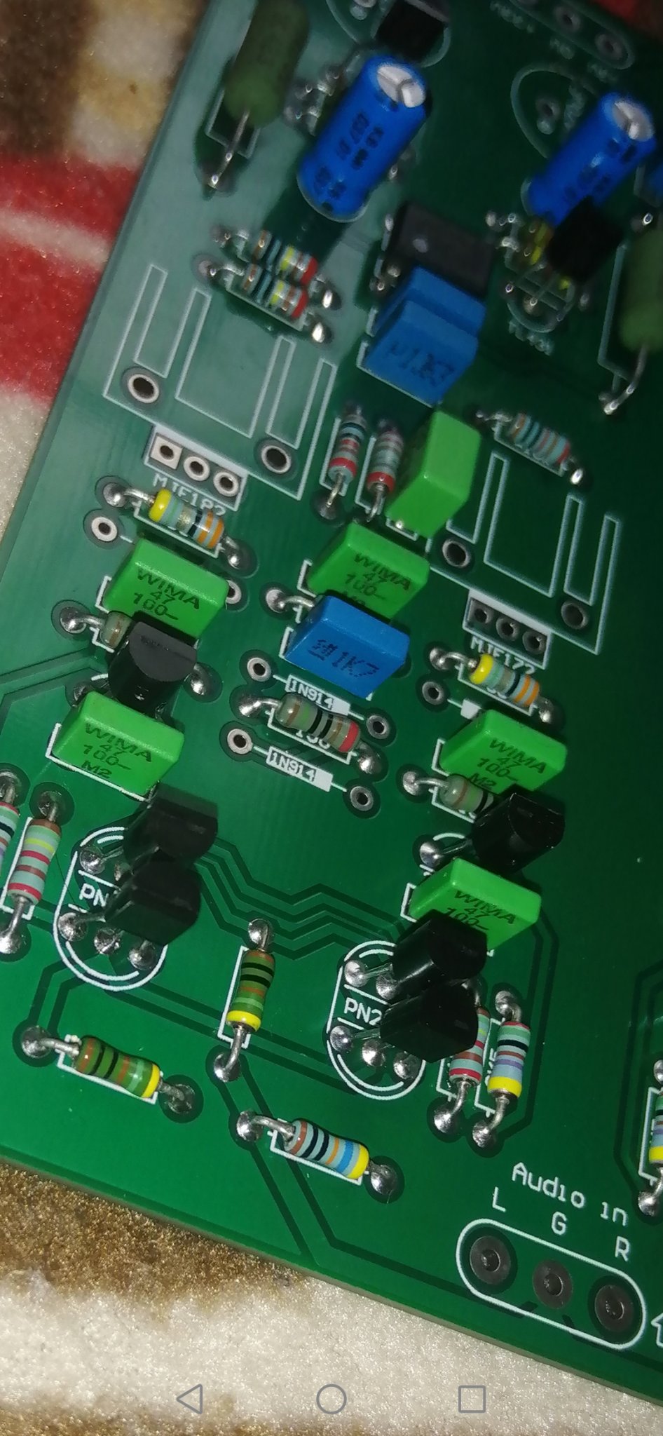

I bought doa33 for login I used bc550c bc560c instead of pn100a pn200a
( will use 2sc3421 2sa1358 instead of mje172_182)
