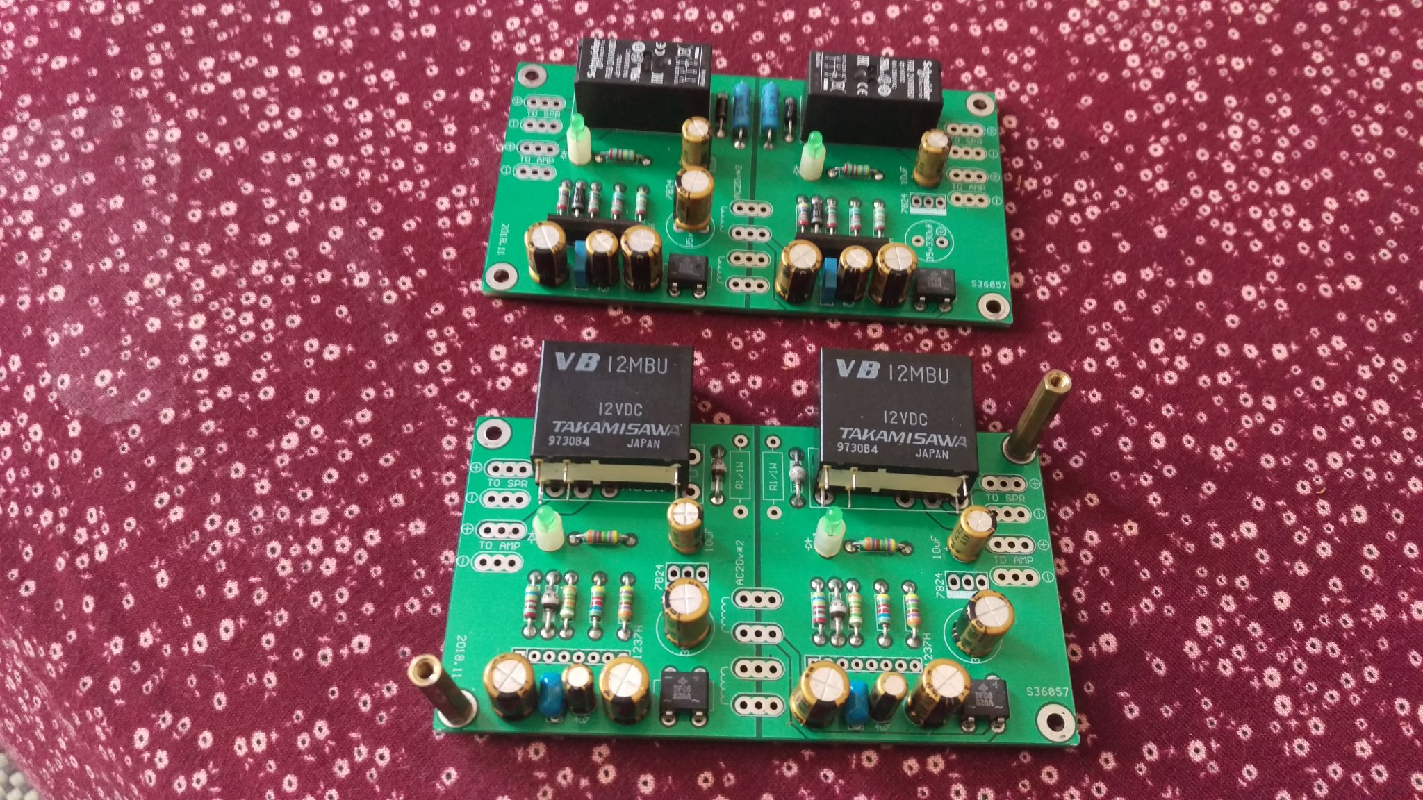

Thank you.... I will use Takamisawa relay

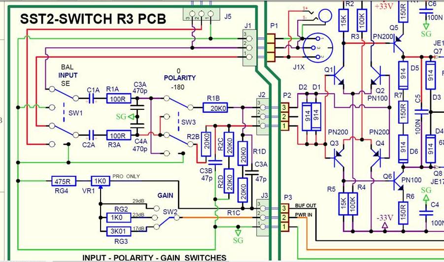

I have just upgraded my transformer in my 4b clone after using a temporary smaller lower voltage transformer. The old transformer ran at about 45Vand the amp has been used every day for a couple of years now, The new transformer runs at 68V and I now cant keep the bias down on the output transistors with the input board connected. If I disconnect the input board all is fine, as soon as the input board is connected the bias voltage starts climbing and of course the amp heats up. The DC offset voltage on both the input board and output of the main board (when not connected together) is about 4mV, so no issues there.
I noticed in the debugging document it mentions if using higher voltages to re-adjust the current to the unbiased flow and adjust the current and midpoint, not really sure what this means but I assume I need to do this to get the amp working properly again.
Can any help or point me in the right direction?

Problem solved!
Installed 68pF caps into C16 and C17 on the input board. The extra voltage must have made it oscillate.

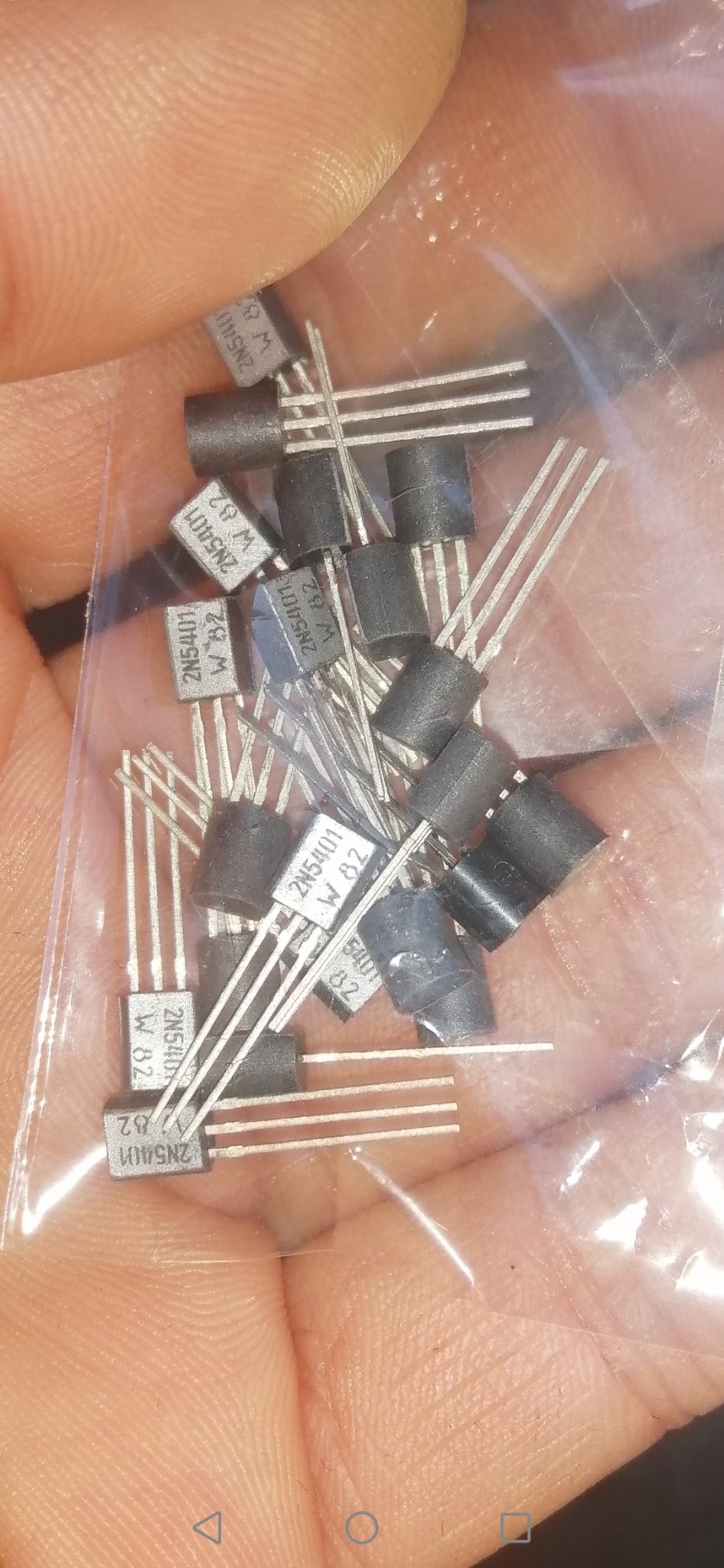

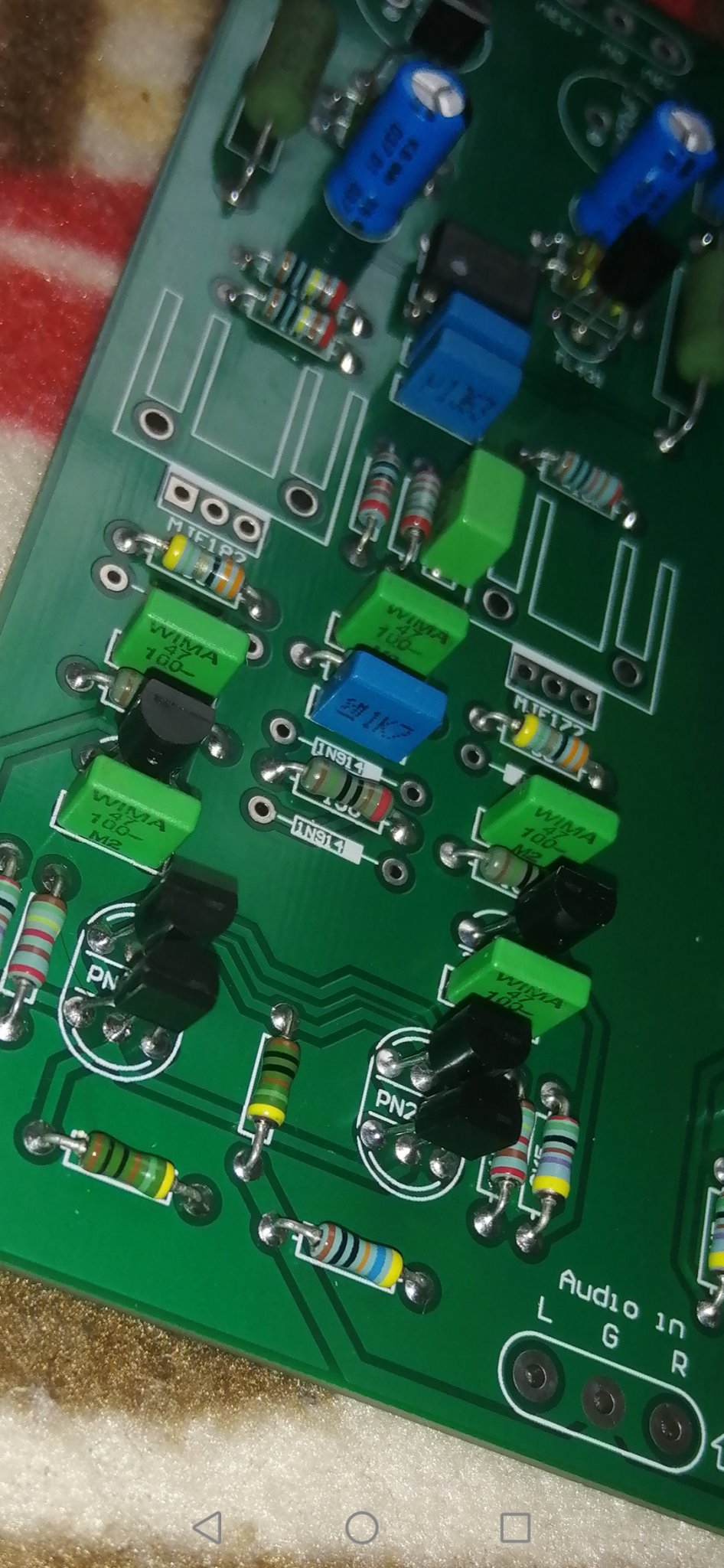

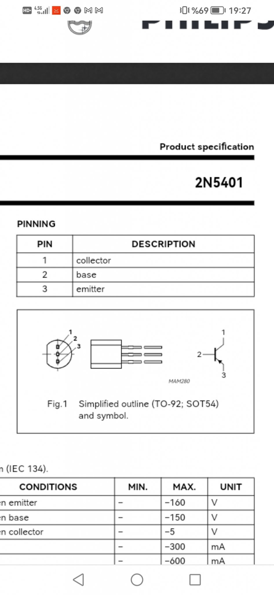

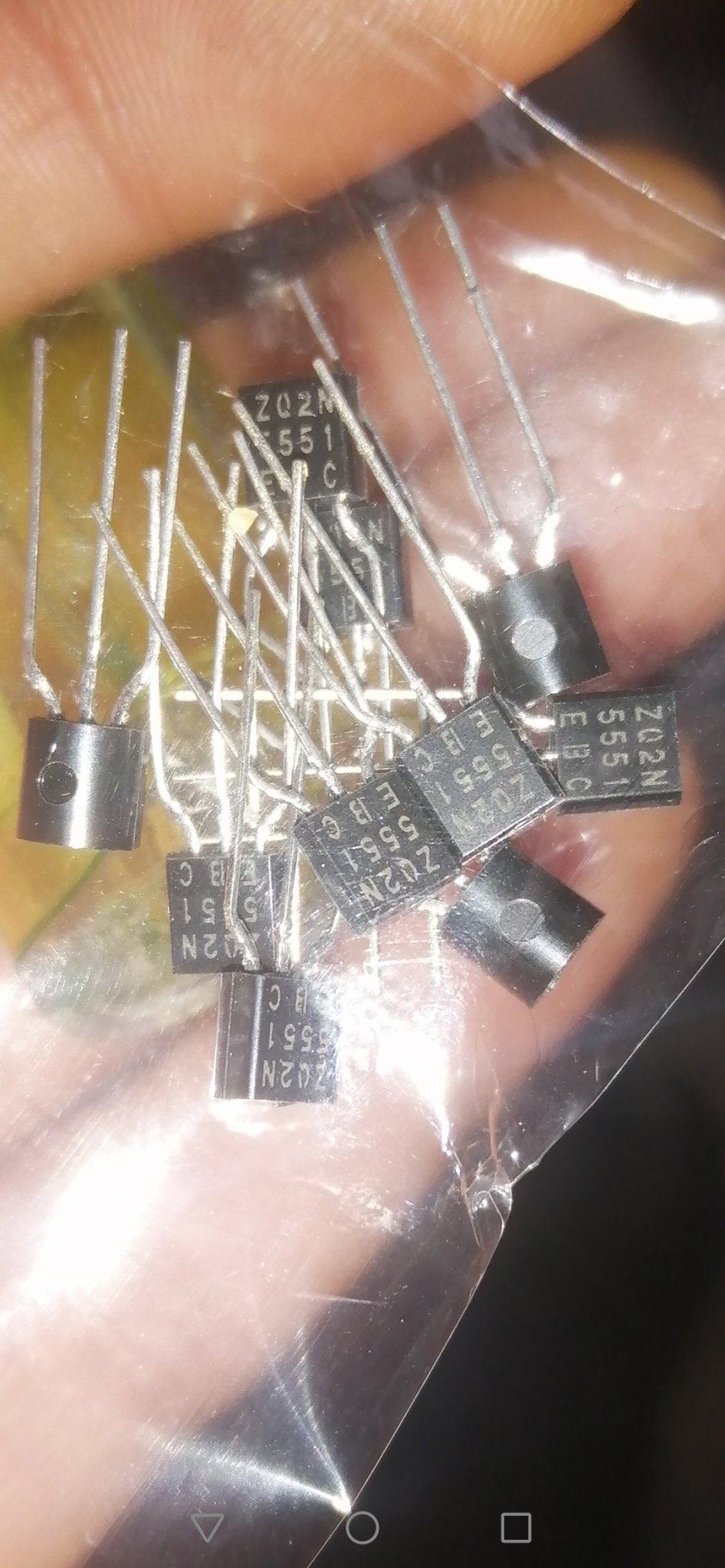

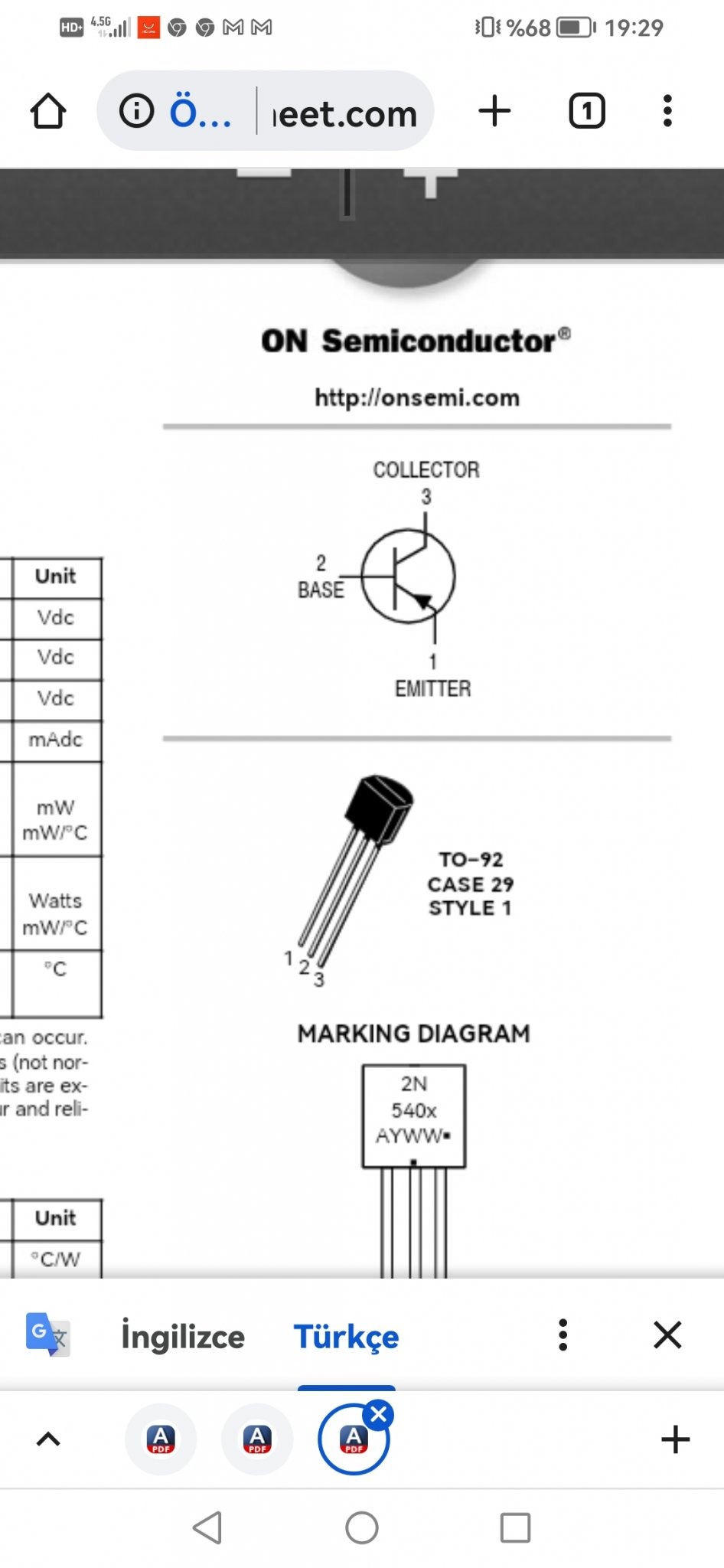

Merhaba Sensation45
Bu, "Çinli" cbe 5551/5401 ile ilgili "bir sorundur. Bunlar aslında "değiştirilmiş" pin çıkışlı CDIL (Hindistan) varyantlarıdır.
BURAYA bakın . Sadece sahip olmalarınızın önceliğini kullanın ve bunlara uygulanmadan uçlar için bükün.
Hi Sensation45
This is known issue with "Chinese" cbe 5551/5401. These are in fact CDIL (India) variants with "swapped" pinout.
Look HERE. Just use what you have and bend their leads accordingly before soldering.
Berlusconi Thank you I have these philips, they are the same as ONSEMI 2n5401 when viewed as 1 foot from the front.
