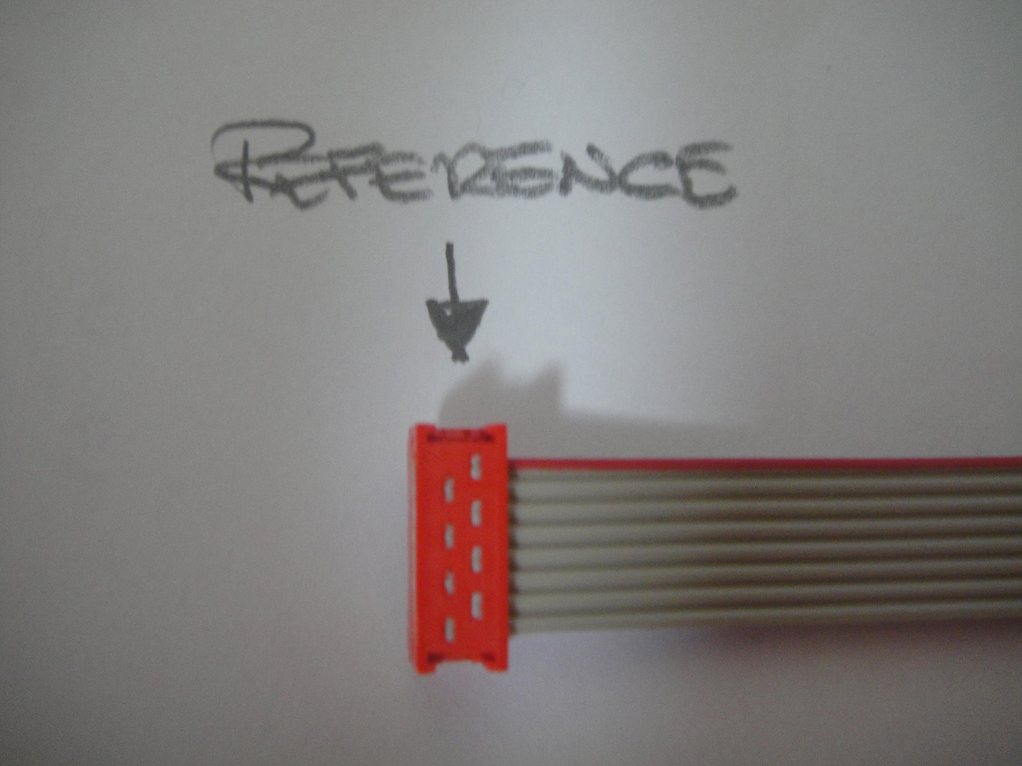

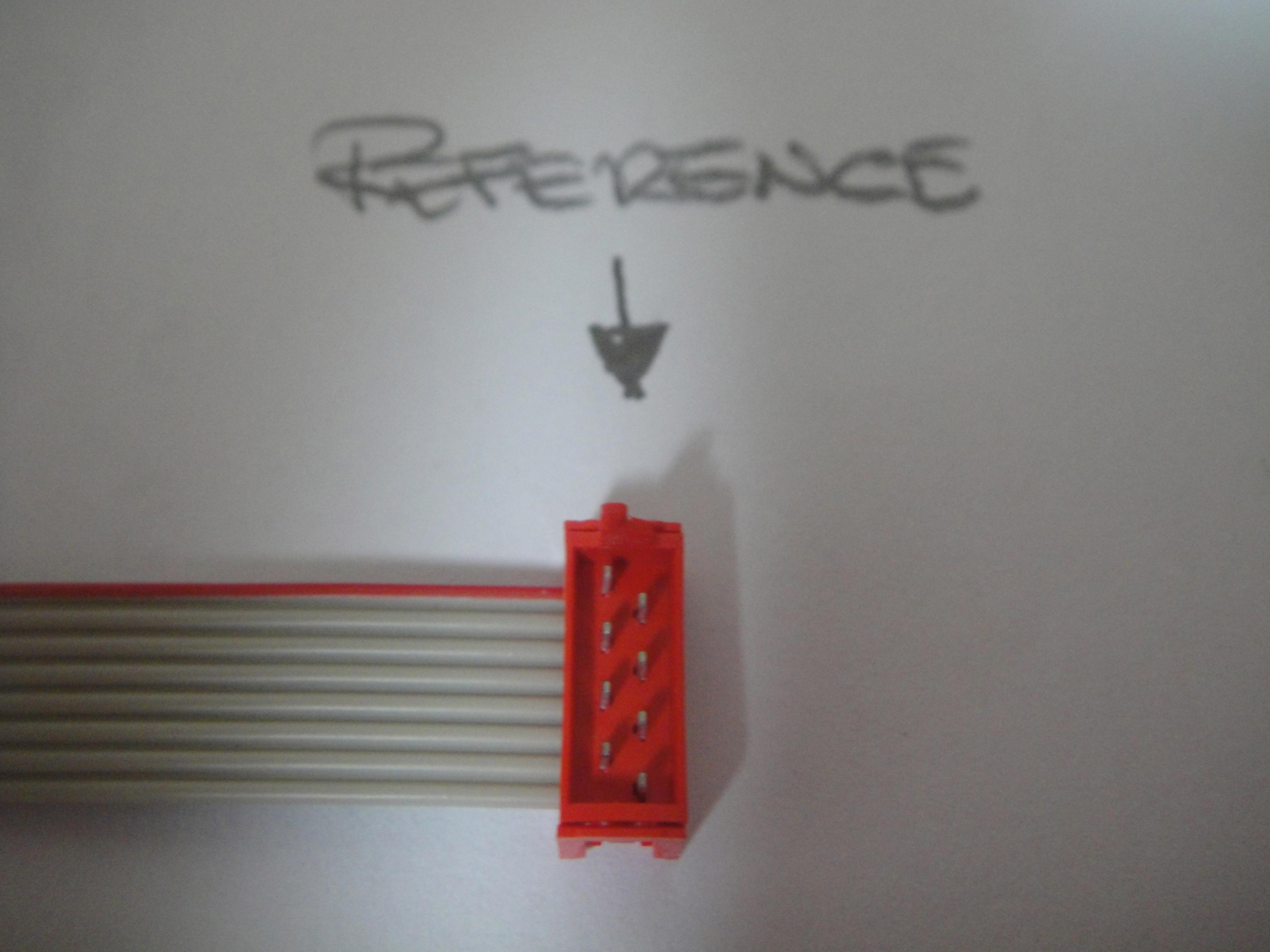

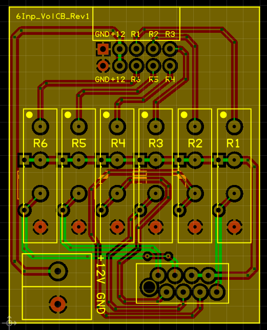

Hi Hans,
I received the cable and I am checking the connections starting from the picture of the silkscreen you attached here.
The reference point is "up" in you picture and the line from Rel4 to Rel1 at the left is more near to the reference point than the line Rel5, Rel6 and +5V.
Looking at the cable I can't match the reference point with the 2 lines. In the cable, keeping the reference "up", the left line (Rel4 to Rel1) is lower than the other line (Rel5 to +5V)
I attached a picture indicating the reference point. As you can see the 2 lines are different from your silkscreen
This is valid in both the side of the cable
Hoping that the above is understandable can you please confirm what I am saying?
Thanks and Regards,
Enrico
Hi Enrico,
Better double checked than not checked at all.
The yellow line shows how to the female connector will sit on the VolCB.
I think everything is O.K., including the mounting notch in brown on top.
Let me know if you still think something is wrong.
Hans

Hans,
Sorry, I am quoting myself, the only way that make sense on your silkscreen is to mount the cable in the bottom side of PCB. Maybe this was your intention?

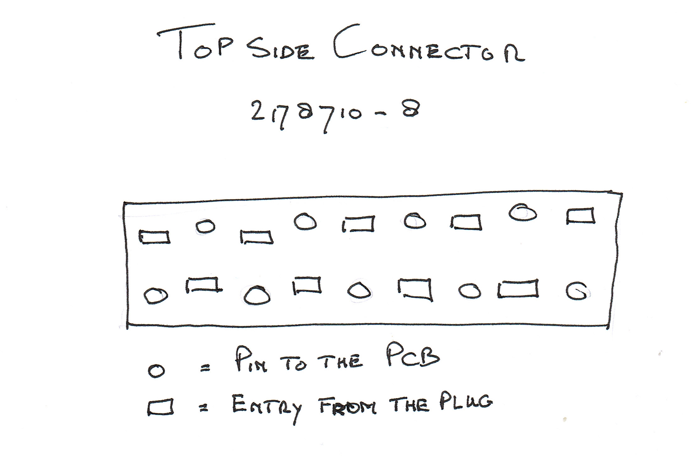

It´s o.k. to check and double check.
The pins of the plug on your picture are misleading because they are at the opposite side of the pins of connector 2178710-8.
So to my opinion everything is just fine.
The red wire in your cable should be the +5V
Hans

Hi Hans,
Thanks for your reply.
You are right, the pin connection in the cable is disaligned with female connector in the PCB and now everything make sense.
This also confirm that the female connector should be installed in the VolCB while the fix part of the cable will be in my side?
Thanks again and Best Regards,
Enrico
Female connector on VolCB, that was exactly what I had in mind.Hi Hans,
