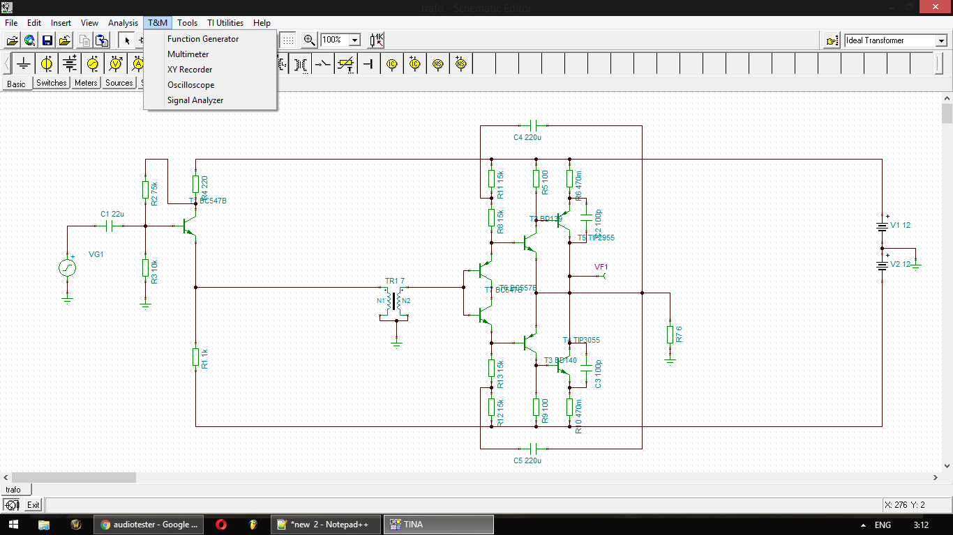

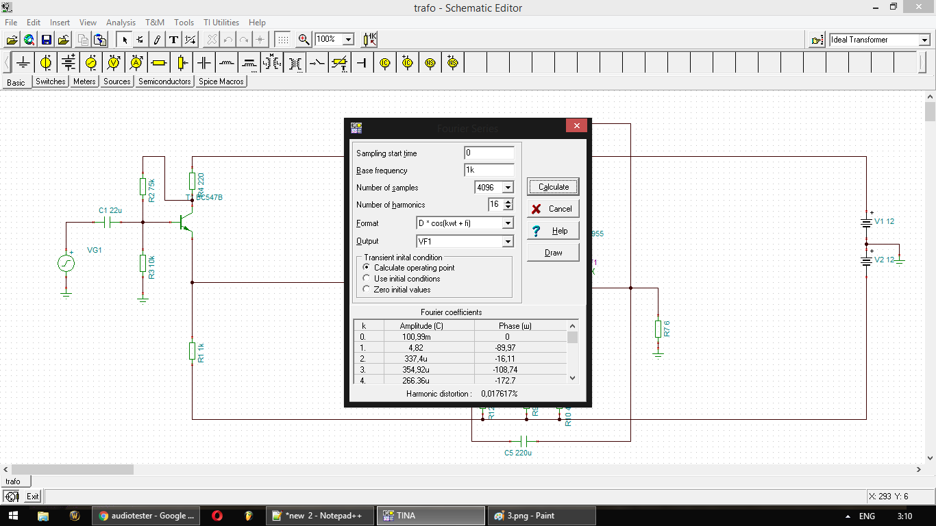

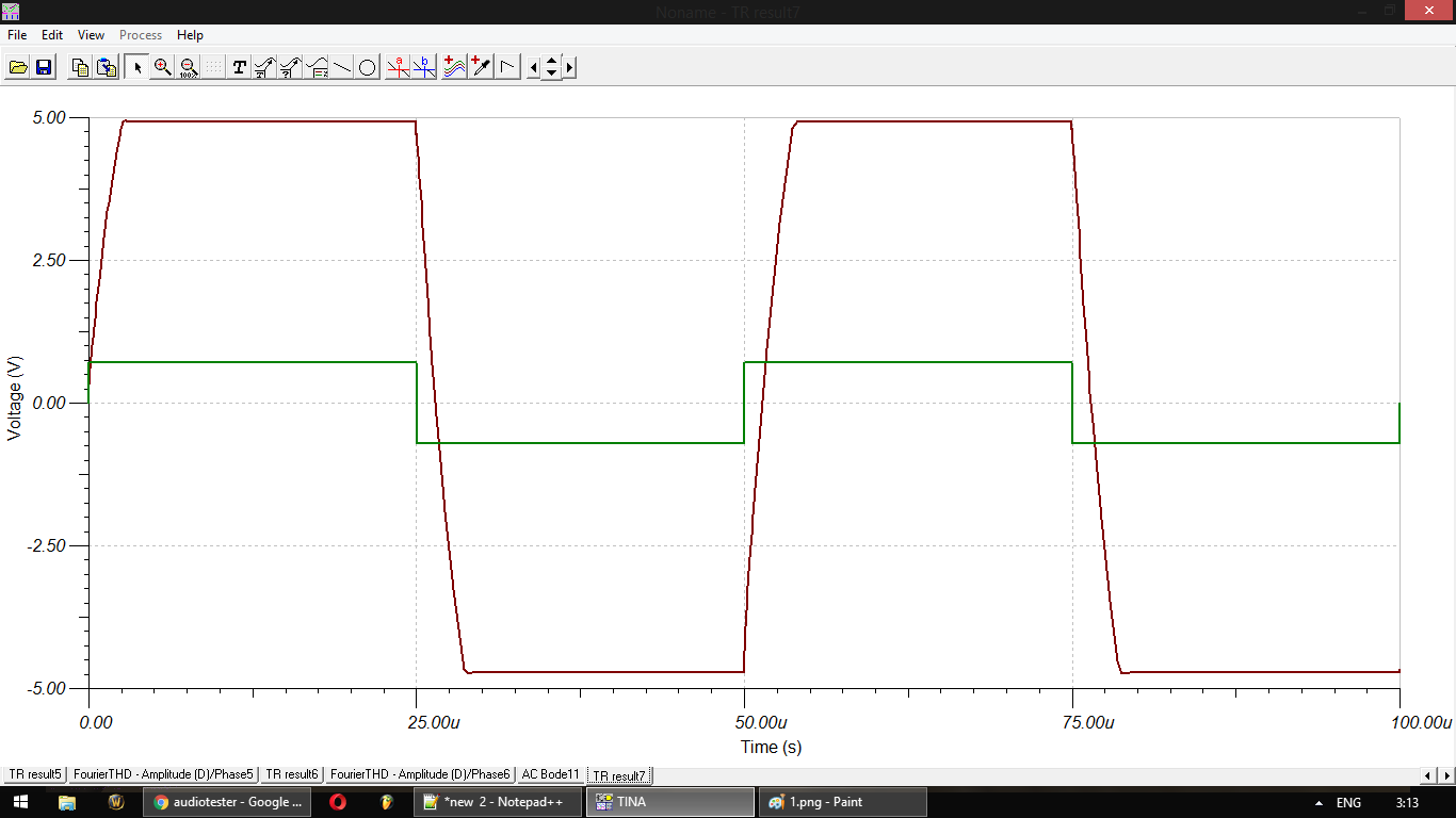

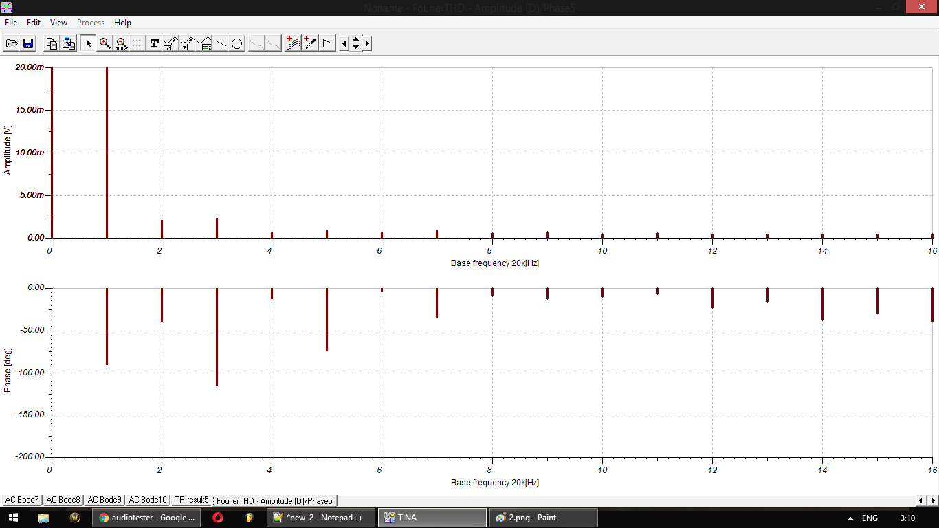

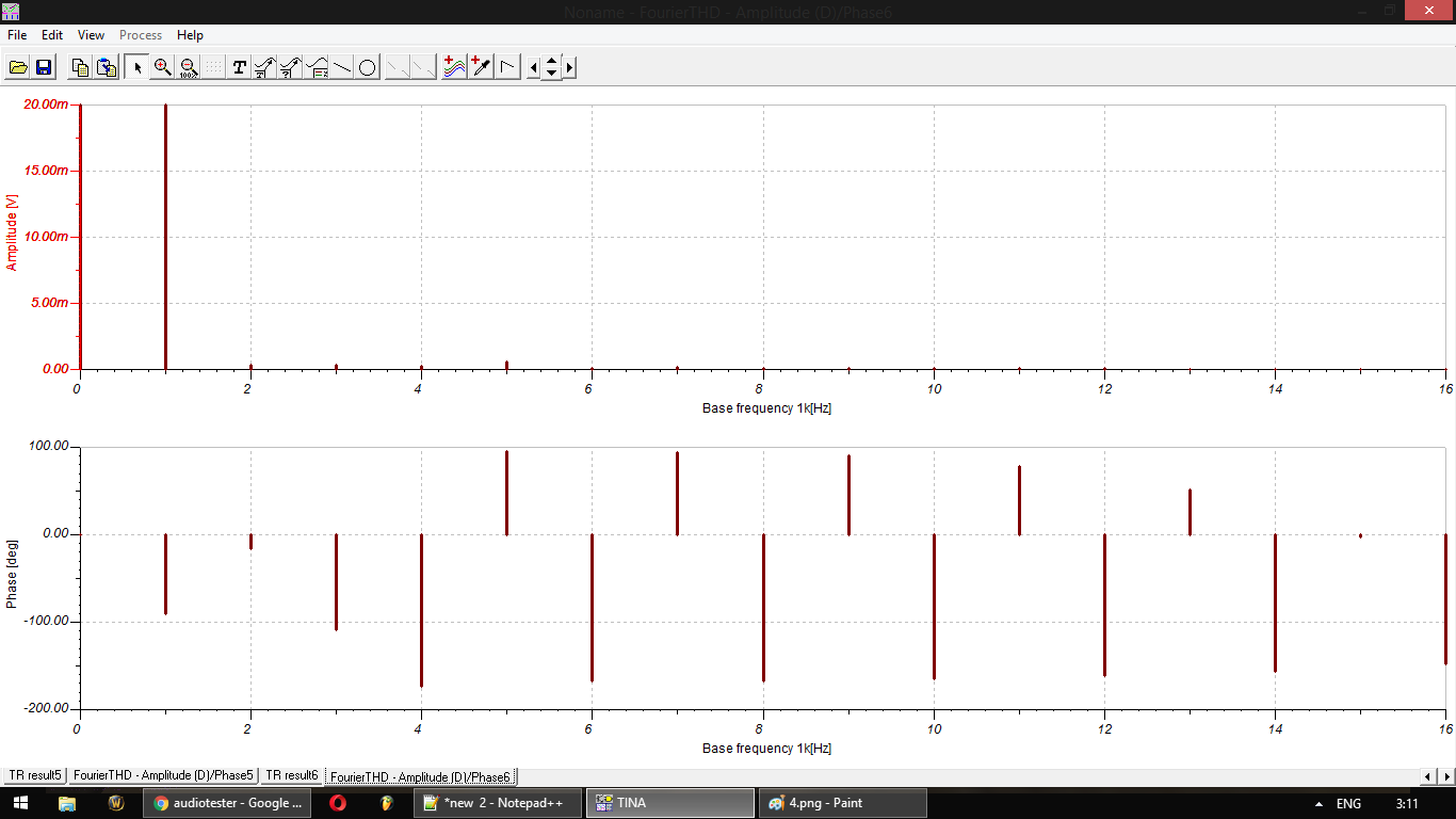

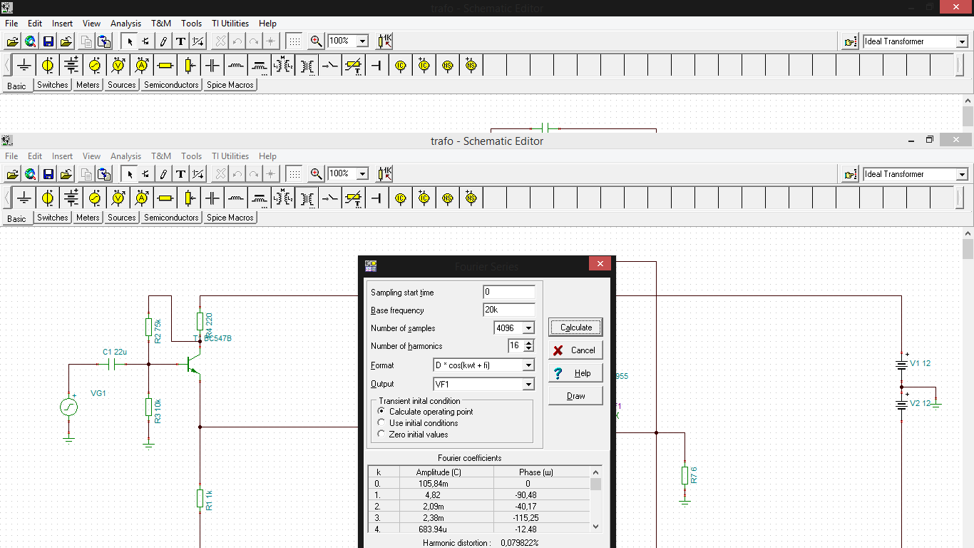

Like this one I simulated:
THD is measured at half power.
As follows:
0.018% 1khz
0.080% 20khz
The squares are 20khz ones.
As follows:
0.018% 1khz
0.080% 20khz

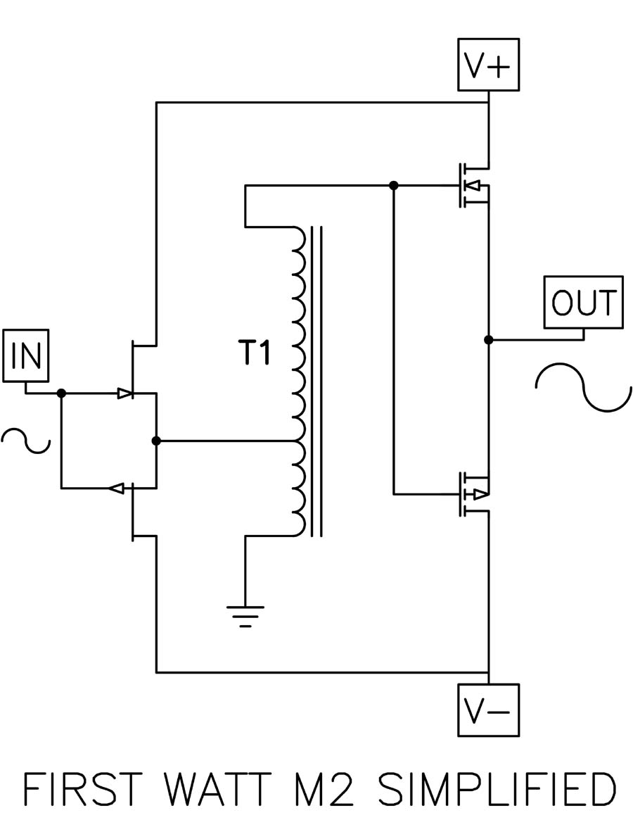

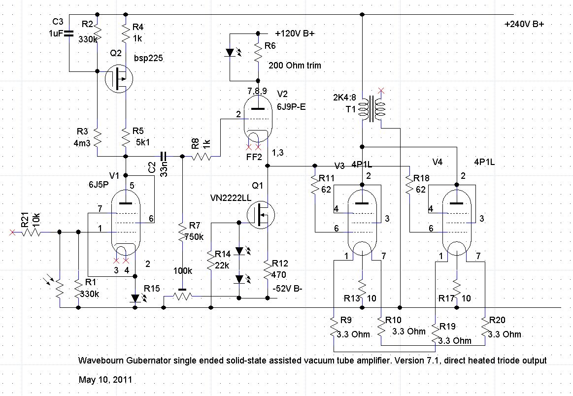

sser2 said:Are you talking about your 4P10S amplifier, the one "Темная ночь, один пуля застрял в провода.."? Why not posting a schematic?
Can be this one, if you offer a 5W per channel amp for a contest. Can be some other one. I described all details of the schematic; can't you draw it? 😀
A pentode power stage can work w/o NFB of any kind, and sound as good or even better than one with feedback. With a right speaker.
True. Depends on a speaker. But strictly speaking, if you want to reproduce records to fool imagination, "sounds nice" is not enough. It is not a high end amp, it is rather a musical instrument that adds to any music own "character".
Edit: here is a schematic of my 5W per channel "No feedback" amp attached. It is much more complex than a pentode one, with nested feedbacks... But both sound equally clean and transparent.
