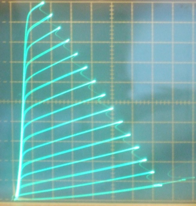

The usual NFB scheme requires infinite loop gain to reach zero distortion. Of course, diminishing returns occur along the way there.
An interesting alternative approach comes to mind from an extension to an old xfmr linearization scheme (patented in the 1940s), now offered as the LEM (linearity enhancement module) by Custom Analogue Audio (Joe Rasmussen).
This scheme puts a low level HF (above audio) signal, of constant amplitude, into the input LTP of the amplifier, with the intention of improving the low signal permeability of the OT. Much like the HF bias used for tape recording. (and for removing xfmr core hysteresis)
If the level of the (constant) HF is monitored (via synchronous demodulation) at the final tube plates, this indicates the forward gain of the amplifier. If that level is used to control the tail current of the input LTP (altering the LTP gain), then the forward amplifier gain can be servo controlled to be constant. Only finite gain is required in this control loop to achieve constant amplifier gain (within the audio frequency range). (within the linear capabilities of the control loop devices themselves, ie the variable CCS tail and sync. demodulator)
Of course starting out with linear gain devices in the amplifier makes for easier work for any linearity control loop. Like Super Linear tubes, below:
