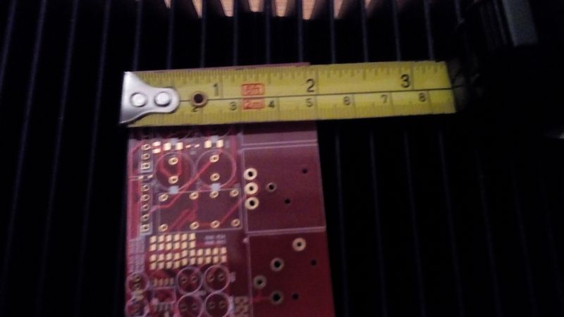

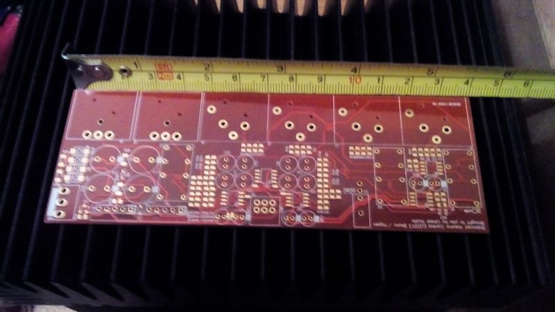

I'm obviously not Jan Didden but hope I can help since I have one board right in front of me and just took measures / photo's of it:
The PCB is precisely 49x140mm or approx. 2.0x5.5"
