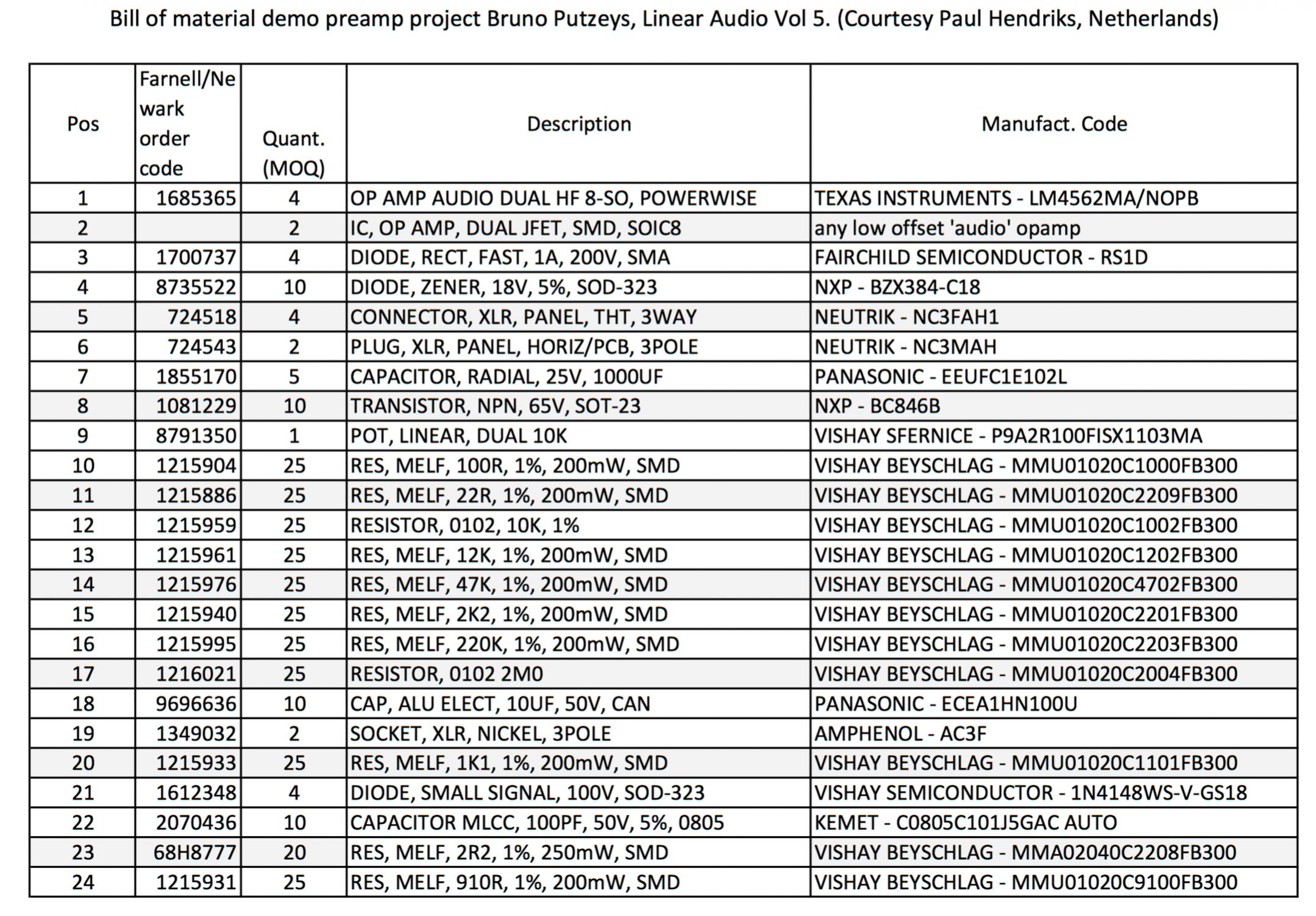

OK Chaps,
I need some clarification here.
I had initially sent the generic BOM from the article (I painstakingly put the graphic it into Excel). They quoted against this.
I then sent them an email last night saying basically "sorry, I now have a more specific BOM with specific part numbers. Can you please quote against these parts".
They haven't got back to me yet, but I really need a final, approved BOM, whether it contains specific parts or not (any standard 1% will do, 0.1% for precision, no need for melfs or anything else fancy).
I cannot go back to the lab every other day changing the BOM against which they are researching and getting specific pricing. I want to help out with this, but I'm not prepared to ruin any possible future relationship with these people if I appear to change my mind all the time!
So can we please have a complete, approved, detailed where necessary BOM so I can give them a final BOM against which everyone is happy.
Thanks 🙂
Thanks 🙂

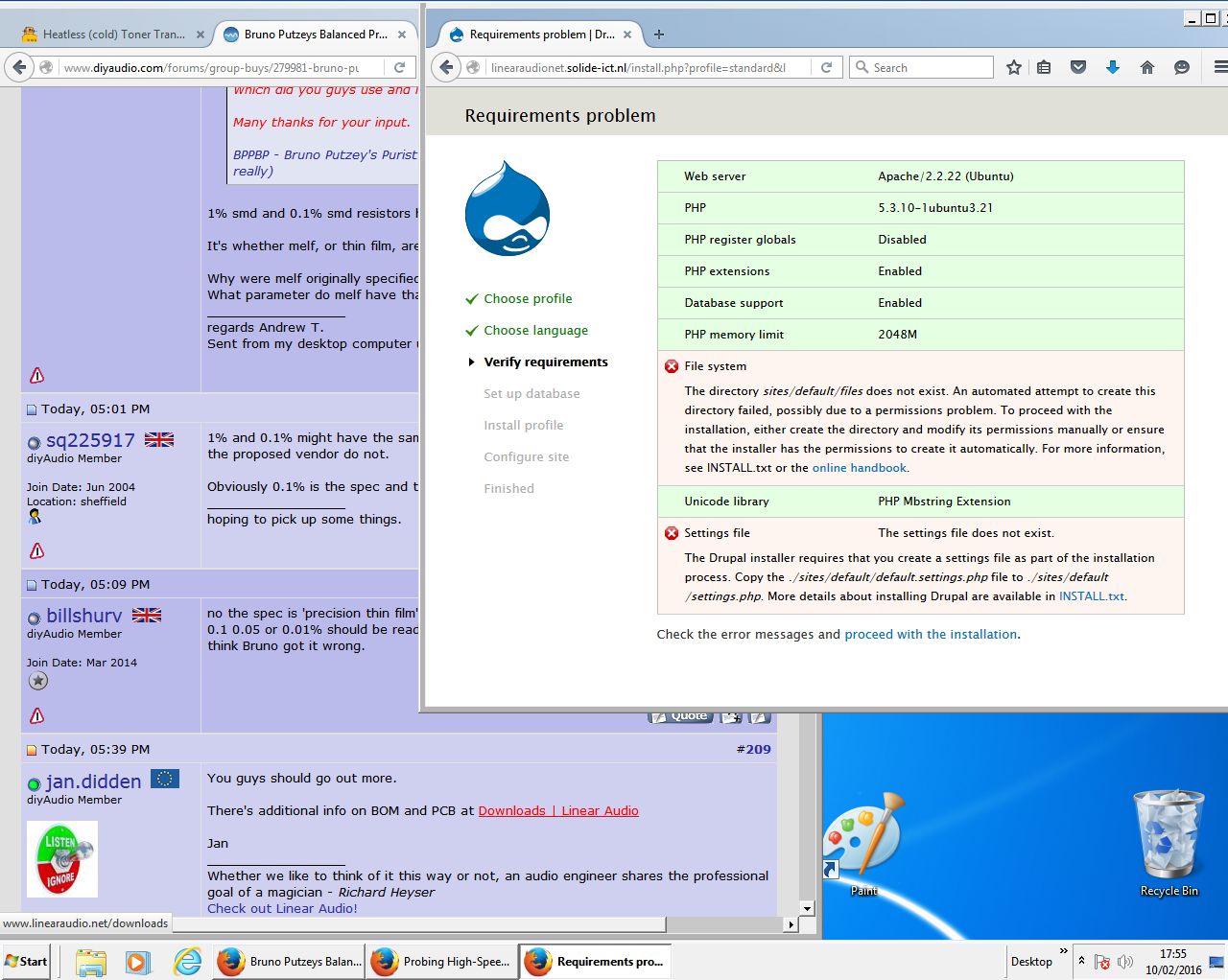

I went out and now I am lost.
Whoa! What's that??
I'll set my webmaster on it (should be under support...).
Jan

Worry not. As soon as we can get hold of the Farnell BOM we can X-check and mutis mutandis have you a final BOM for the supplier.
So it is Paul Hendriks interpretation but not a Bruno made BOM that the link above point to?
It says melf.
Linear Audio BOM attached for those who had access problems....
It says melf.
