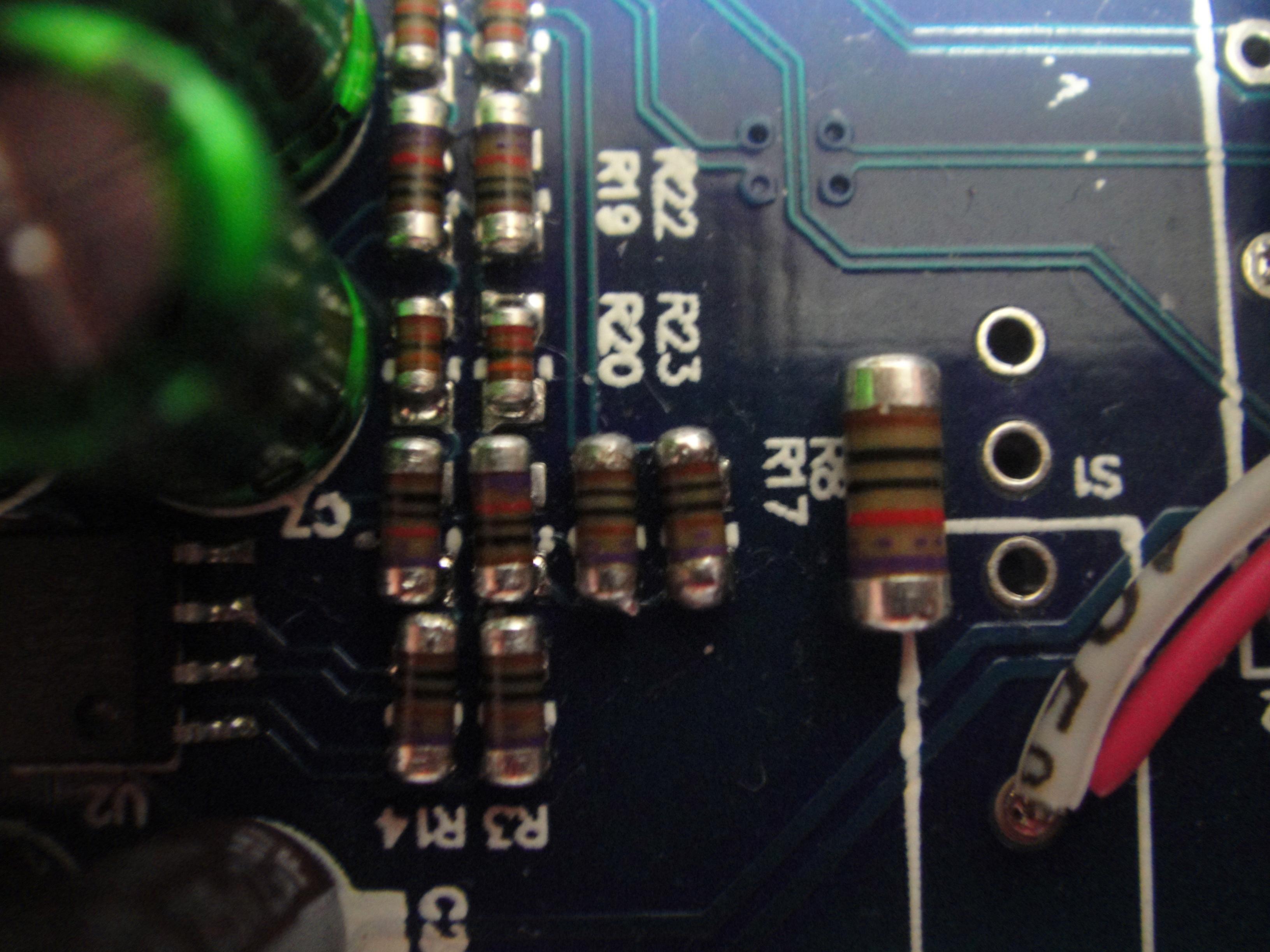

Unfortunately I “blindly” place the order on Mouser for the parts based on the BOM published in the thread. There is more than one mistake:
- The expensive SMD resistors R2, R3, R13, R14, R30, R31, R40, R41, R8, R17, R35, R44, R19, R22, R46 and R49 are wrong.
The size of the 0207 serie resistors proposed in the BOM cannot fit in the pcb. The only available size with the same characteristic is the serie 0204 that is a little bigger than the other resistors but (being really careful) can fit the footprint
- The C10, C16, C26, C27, C28, C29 can’t fit in the pcb. Changed on ELNA SilmicII RFS-25V220ME3#5
- The C12, C13, C14, C15 can’t fit in the pcb. Changed on Nichicon UKT1E102MPD

Hi Robert,
I re-read my post and actually I was not so clear... sorry about that.
When I mention that the MMA0204 are a little bigger I was referring to the pads in the PCB...
The UMB0207 serie doesn't fit at all, as you see in the d/s they are 5.8 mm.
I just take a picture where you can see the 0204 and 0102 soldered in the PCB and near the 0207 as reference.
I hope this can help and I would suggest you to revise also the caps, the ones in BOM not even fit
Best Regards,
Enrico
This a view of the PCB manufactured from Bruno's Gerber file, with two size 0805 resistors on it. There is just about enough pad area to solder the components of this size.
Judge by yourself whether you can solder a larger component onto these pads.

Thanks Enrico and Braca
Ok, can I suggest to change the BoM as follows:
line 14 - R2 etc.: VISHAY BEYSCHLAG UMB02070G1001BBU00 -> MMU01020E1001BB300
line 19 - R8 etc.: VISHAY BEYSCHLAG UMB02070G1002BBU00 -> MMU01020E1002BB300
line 21 - R19 etc.: VISHAY BEYSCHLAG UMB02070G1002BBU00 -> MMU01020E1002BB300
Regarding the capacitors, the diameter of the proposed ones was too big, right? Assuming from your previous pictures Enrico there's only 5mm diameter per cap, correct? I would not use ELNA SilmicII RFS-25V220ME3#5, since they are only rated 25V whereas Bruno specifies 63V. I'd therefore suggest to change:
line 4 - C10 etc.: ELNA - RFS-100V220MH5#5 -> Nichicon UKW1J220MDD or UFW1J220MDD (don't know how series KW and FW differ?)
line 5 - C12 etc.: ELNA - RFS-25V102MJ8#5 -> Nichicon UKT1E102MPD (these seem to be fine, and with 10mm diameter the smallest possible)

Yes, the pads are all 0805
Was there a reason you chose cylindrical SMD over the 0805 flat types themselves? Or just availability?
No, that's what my research at Mouser came up with given the parameters (MELF in particular)
I had a look at 0.5W 1206 are readily available. 6p more than melf. Unless we need 1W parts in the PSU I would stick with flat for the 2R2?
I definitely remember Bruno saying you need MELF there for increased inrush performance (i.e. not breaking when switched on).

The only Melf resistors to be used are R25 to R28 because of the high inrush current at switch on in order to load C12 to C15.
None of the other resistors should be Melf.
The 1K and 10K resistors specified in the Bom by Bruno as "Precision Thin Film" should be 0.1% or better because of their direct impact on CMRR.
These 1K resistors should also have a very low Tempco of 25ppm/C to prevent thermal modulation.
Using 0.1% resistors will give you a CMRR in the order of 60dB.

Thanks Hans. I will remove the BoM on my website which wrongly specifies lots of melf.
I build up my own unit(s) in the same way as you suggest.
