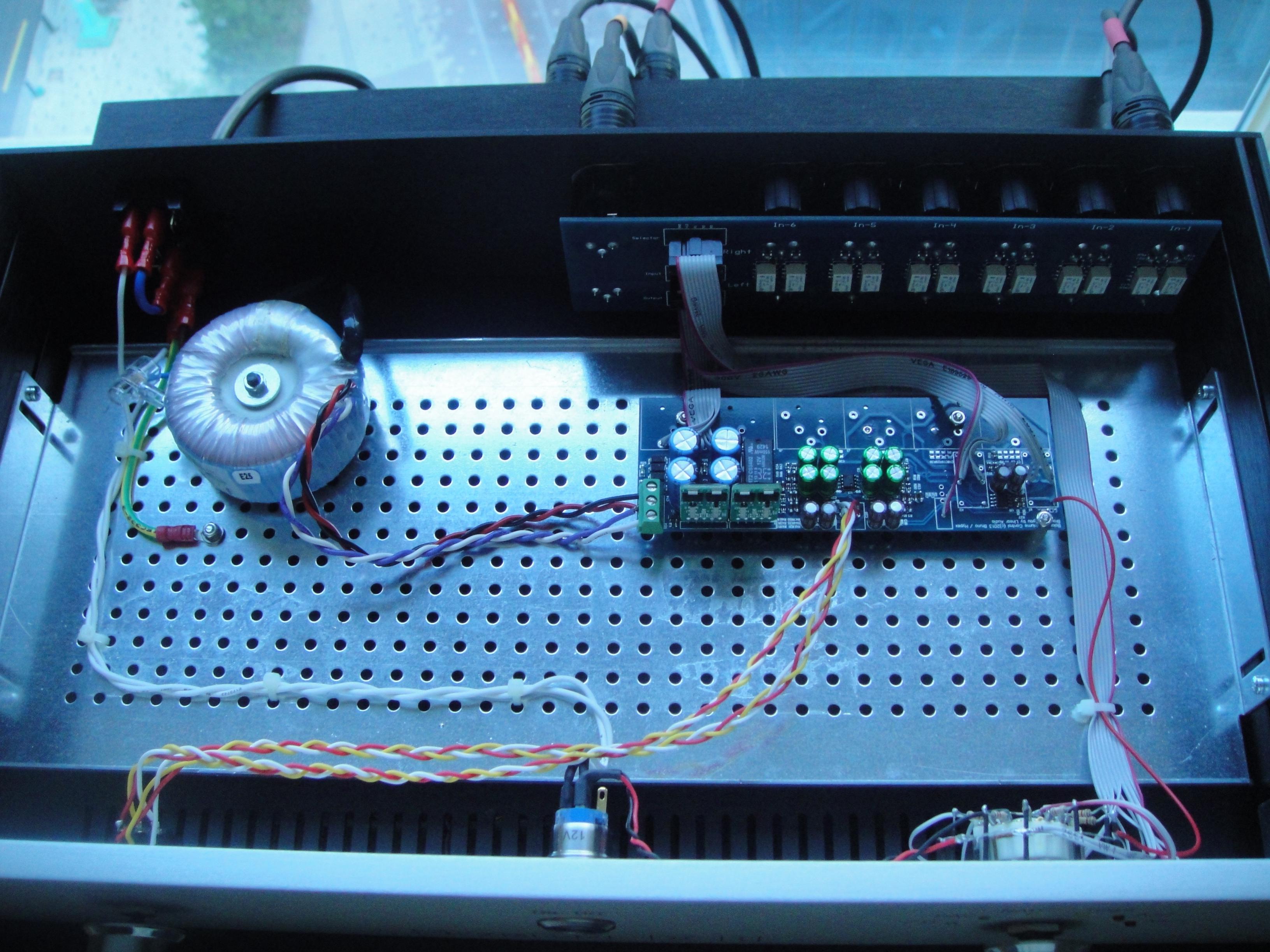

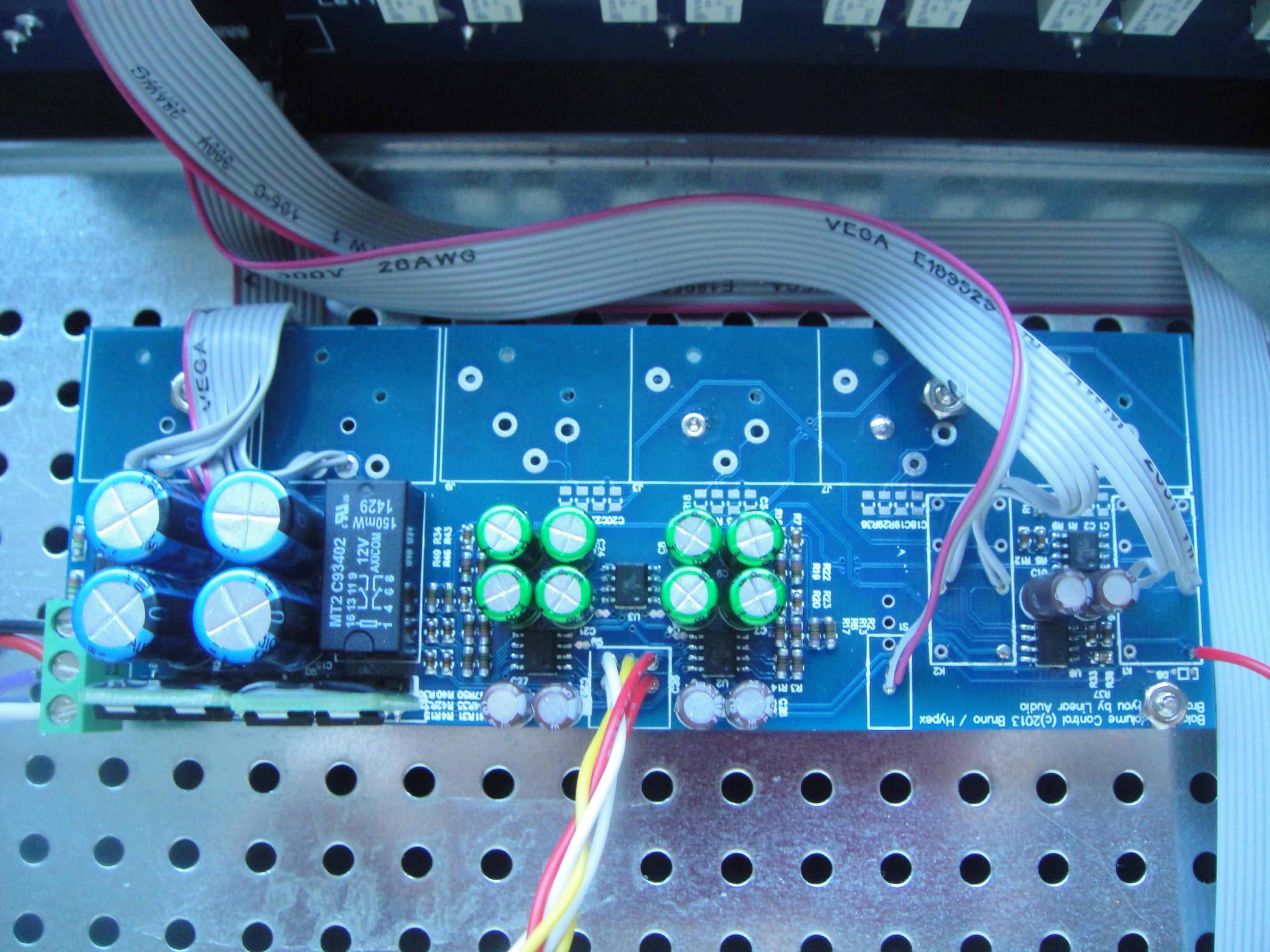

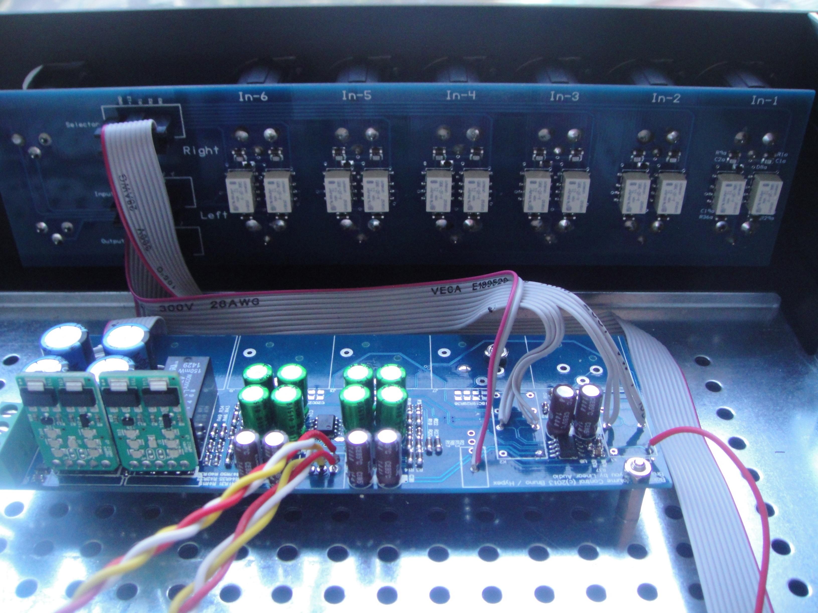

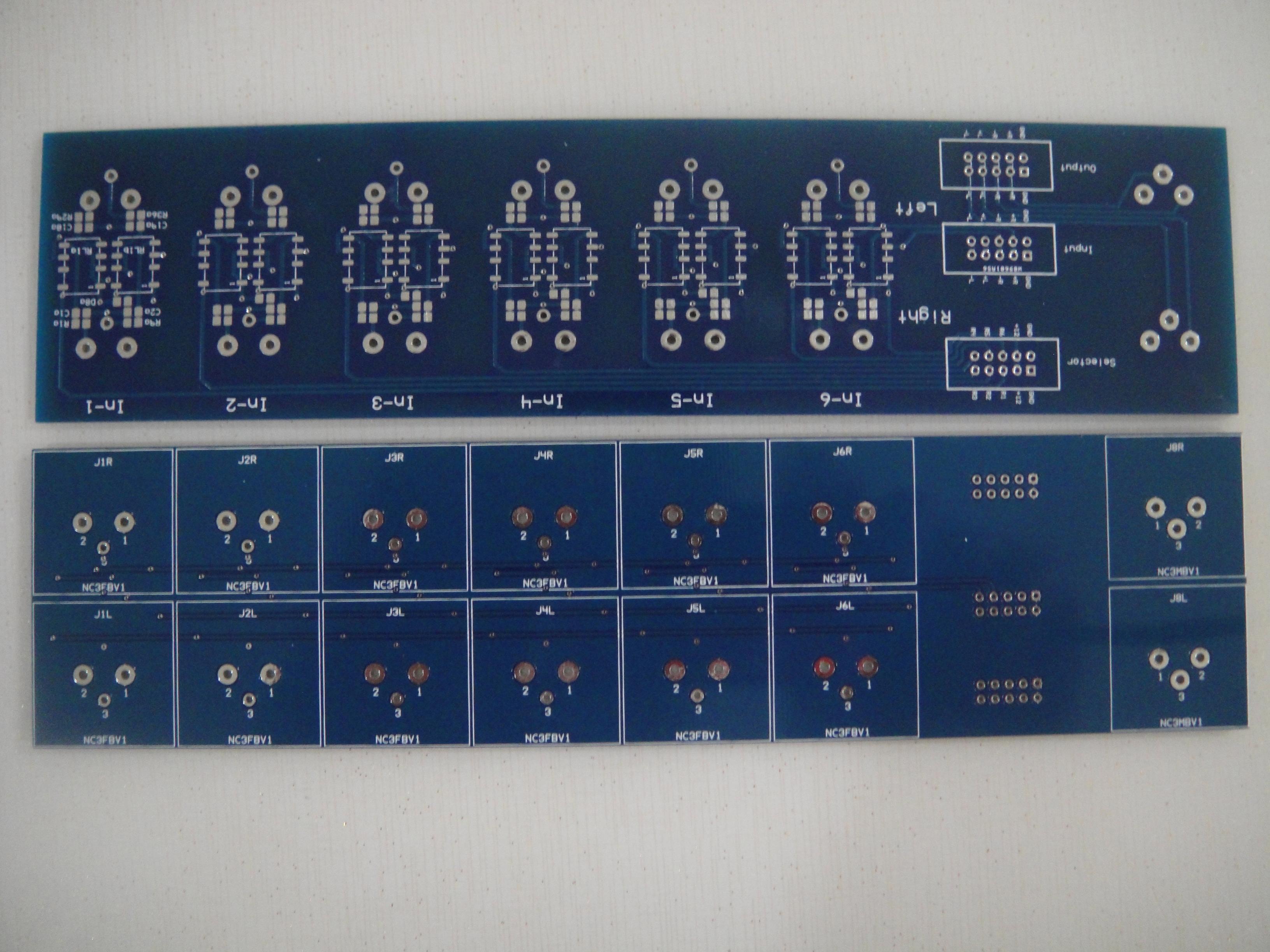

I am receiving requests of my 6 inputs boards by PM that I show in the post #67, so I decided with the agreement with Bertel and tfboy to see if there is the interest to start a dedicated GB that will include the 6 input board and in case the front panel board and in case the relevant rotary switch and LEDs.
I repost here the pictures that I send some days ago and this is the link for the GB : http://www.diyaudio.com/forums/grou...ys-preampli-gb-6-input-board.html#post4620322
