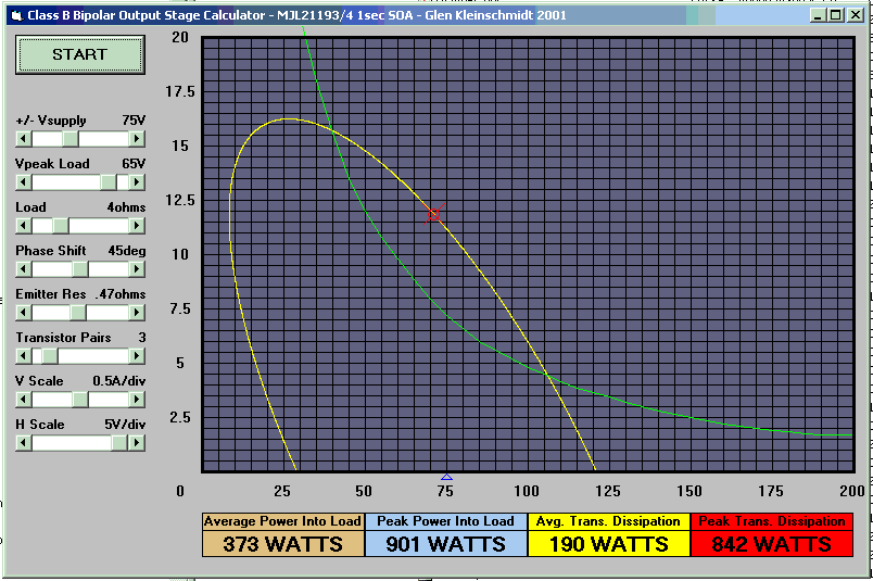

+/-75 V rails with a 4 ohm load is going to give you an amplifier with a power output of around 500W (If your power supply is up to the task).
That will make 3 pairs of MJ21193's into burnt smokey crispies pretty quickly with the volume control turned up.
Below is the reactive loadline for a reasonable 4 ohm speaker (2.83ohms+j2.83ohms).
The green line is the non-temperature derated 1sec SOAR for the MJ(L)21193(4). It doesn't come close to enclosing the load line.
I'd use 6 pairs minimum.

There is no doubt in the data presented by Glen, but it depends on the point of view. If the amp was run in test mode i.e. sinus input on the bench at full power for an extended period then the output stage is at risk.

G'day Quasi.
I have to disagree.
The graph shows that over just half a cycle at near maximum output, the 1 sec SOA of 3 parallel connected MJ21193's doesn't even come close to enclosing the reactive 4 ohm load line. And don't forget, the SOA curve shown is not temperature derated - it assumes a case temperature of 25 deg C.
In real life, with the transistor cases runing at perhaps 70 deg C or so, the conditions will be much worse.
It is unfortunate that the ON semi datasheets for the MJ21193 only show a 1 SEC SOA curve, but if you look at the SOA graphs for the similarly rated MJL3281A (Which has a virtually identical 1 Sec SOA) you'll see that the 1 second and 10ms SOA curves have have much less than one order of magnitude difference between them.
If you temperature derate and extrpolate from the graphs, you'll see that even the 10mS SOA will be violated.
Three MJ21193 pairs with +/-75V rails would be just passable for a domestic HiFi amp with 8 ohm loads, but hugely inadequate for 4 ohms, IMO.
What you say about the SOA design margins of commercial power amps is generally true for the cheaper end of the domestic amplifier market, but not so for proper professional or PA use.
I doubdt that there would be many professional amplifiers rated at ~500W in to 4 ohms with only three pairs of MJ21193/4 (or equilavent, power rating wise) transistors noted for their reliability.
I wrote the SOA calculator myself in Microsoft Visual Basic for computing my own high power designs. If you want a copy for a play, I can e-mail it to you.
Glen
Hi Glen,
In my post #8, I described this amp a powerful domestic power amp. Indeed if the amp was to be used as a musical instrument amplifier then the output stage needs to be heavier. It is true also for PA applications because compression is often used lifting the average power dissipation.
In terms of actual power delivered, in post #32 I gave an estimate of power using 70 volt rails. Along the theme of a domestic amplifier using a "reasonable" power supply, I estimated some losses in the power supply and in the amplifier finally arriving at a conservative 210 watts into 8 ohms. I guess near 400 watts into 4 ohms is achievable. I named this amp the N-Bip350 because in a "reasonable" stereo build this is reflects what would be achieved.
In another thread I presented a mos version of this amp. With a 500va transformer and DC rails of 73 volts I achieved 210 watts into 8 ohms and 360 watts into 4 ohms before clipping.
Having said the above I must fess up that when I looked at the SOAR of the MJ21193 and compared it to the MJ15003 I didn't notice that I was comparing a 1 sec SOAR to a DC SOAR. It may well be that the MJ15003 is actually stronger.
There is no way this amp could deliver 500 watts into 4 ohms with a reasonable power supply of say a 600 - 800va transformer. The amps that I've seen capable of delivering 500+ watts into 4 ohms run rails of around 80 volts (or more, idle).
I would be delighted if you could send me your SOAR applet. I currently do it in Excel. Please email to quasiweb@adam.com.au
I have written all the above for a wider audience and may have written the obvious for some readers. I trust I have not offended anyone in doing so.

Hi Quasi.
I don't think that you should have offended anyone either. I was just replying to Taj, who said that he has a 105VCT transformer, giving rail voltages of just under +/-75V and anticipates the use of 4 ohm speakers. He didn’t say what his transformers VA rating is though.
500W in 4ohm = 63V peak. That gives a ~10V sag/ripple/Vsat/etc headroom. 500W would just be rather close to the maximum RMS power output if his PSU is beefy enough.
Way back in 1997 SC did a 500W amp using a dual 55V secondary 800VA toroid (giving a nominal rail voltages of +/-80V. It used six pairs of MJL21193/4 transistors (plus a seventh pair for drivers) and about 80,000uF filter capacitance per rail. It managed a measured 500W rms and 590W for brief bursts.
The MJ15003 is a 20A transistor and it SOA at low voltages is superior to the M21193, but it is a lower voltage device and its secondary breakdown occurs earlier. The MJ21193 is better at high voltages.
