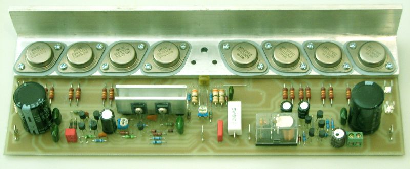

Prototype almost finished
Here's a photo of the almost finished prototype. It's missing the output drivers and the output coil. I revised the layout to suit the heatsink mounting bracket I used and once tested I will post the layout for anyone who is interested.
Cheers
Q
Cheers
Q
Hi Quasi,
That looks professional! Nice work!
It seems that you using Sprint Layout for PCB design. Am I right?
I'm using the 4.0 version, and I'm really pleased with the software. Cheap, but really reliable and practicable. For home usage it's perfect.
Thanks Edl, yes I use sprint. As you say it's very easy to use (although I had to draw new TO3 devices at an angle). I also like using the fill command to save on etchant.
Merry Christmas to you and your family.
Cheers
Q

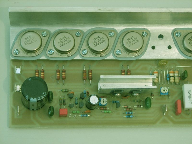

Merry xmas Quasi,
I had a question that I like to ask about the pcb design. At the lower left corner there is a 0.1uf. the lower side of which goes to the ground. Instead of going to the closest ground that the 300uf had, it had to go all the way back to the middle parallel with the 300uf ground. What would be the significance of this? Hope that is not a very stupid question.
Similiar with the -ve rail.
Hi Bigpanda
On the positive rail there are two 0.1uf capacitors. The first one is in parallel with the electrolytic and this one is connected straight across it. These capacitors filter the positive rail after the fuse.
The other 0.1uf is connected before the fuse and provides some filtering to the positive track feeding the first and second stages. This goes back to central ground to avoid the heavy current flows associated with the output stage.
The negative rail is the same. The 0.1uf in the middle of the board filters the negative rail feeding the constant current source. This is also before the fuse and is returned via a seperate track to ground to avoid the heavy currents on the other earth track.
I hope the above makes sense. I have attached the revised layout to show how the different tracks run.
