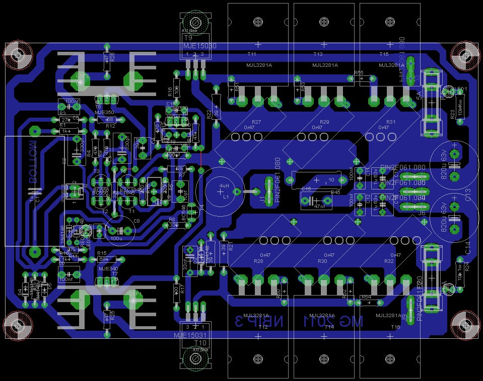

And the last evolution, the one i will use after putting together on study board all my need and possibilities. Suitable home place is an important criteria and i don't want to exced 24x25x34cm (WxHxD), use of a maximum parts i have in stock is a another.
The main project turn on 500VA Rcore 2x36Vac, 8xMur3020WT for rectification, 32.000µF/63V smoothing caps per Voltage rail, 6x MJL3281A paired output devices. Each output device emitter resitor will consist on a little pcboard that support 4x 1R8 1W 1% metal resistors in parallel

That's my way to avoid difficulties to find locally 5W 0r22 non inductive resistors

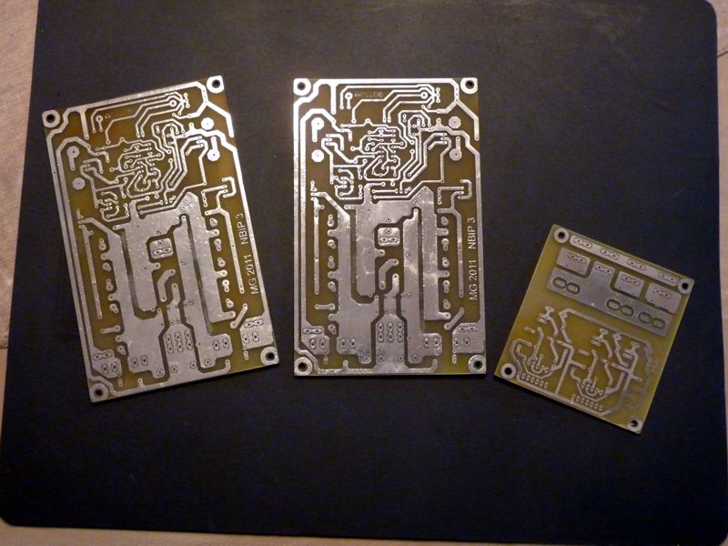

Hi, I will screw board and transistors on a (plastic, wood....) sheet that was large cuted in the center (under board) and so let acces to parts solder pad.
My Nbip board has big evolution on routing job last few monthes.BD139 will be screw direct on MJL3281. see attached (PCB : 100x160mm standart board)

One minor point , you had one end of R21 connected to the fused -ve rail. Does it matter if I had that end connected to the un-fused -ve rail? Any affect on the operation (normal operation or in case of failure)?

When you do so -Ve fuse as no protection effect on case of faillure.
