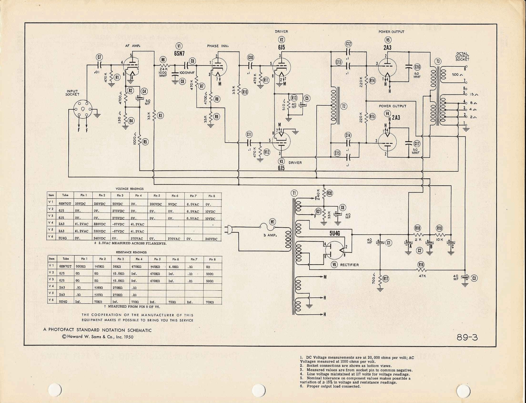

I'm in the process of building a pair of these amps. I have several 6c4c=6B4G and several 6a5g tubes. I'd like to be able to use both. The 6c4c are directly heated cathodes and the 6a5g are indirectly heated.Thought maybe i could make it switchable.
I have seen two different schematics of this amp. I'm a little confused by this circuit. Seems the full rectified voltage appears across C1 with less appearing across C2 and the difference being across R17?
If there is a simple way to set this amp up to use both those tubes? I also read r20 r21 and c6 was mentioned somewhere in the past as significant part of the circuit, yet in the circuit redraw it is omitted. I'm not clear on this.

It is using R17 to make the negative bias voltage for the output tubes , so you don't need a separate winding for this . And of course in 50's extra diodes for rectification were expensive .
I don't think you can use both tubes in the same circuit as 6a5g has the cathode connected to a middle tap of the filament , that direct heated tubes don't have
All the B+ current passes through R17. The voltage drop across R17 is needed, it is the negative bias supply voltage for the 2A3 grids.
R20, R21, and C6 are the elevation voltage for the filament of the phase inverter tube; because its cathode voltage is far above the ground voltage.
It saves the filament to cathode insulation of the phase inverter tube.

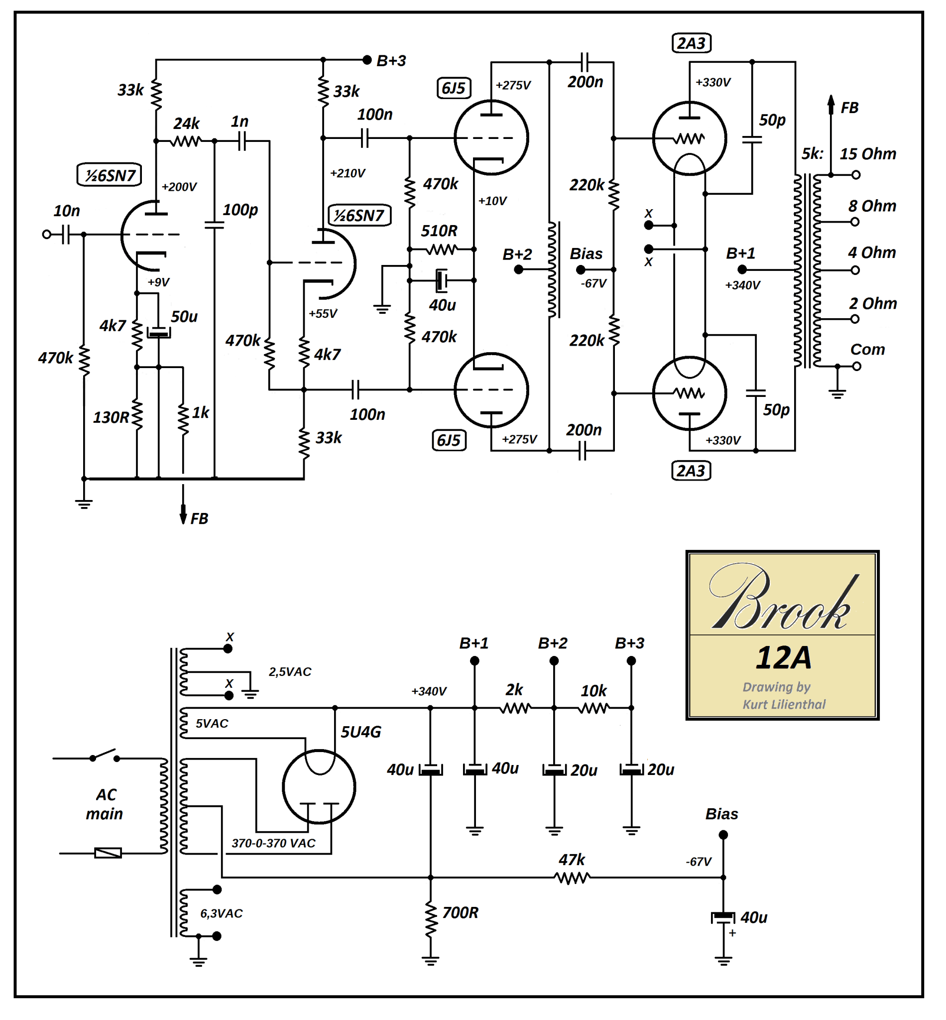

The first schematic does not have any connection to ground that will return the 2A3 filament DC current, H and H. The filaments are floating, there will be no plate current. Needs to be fixed.
The second schematic shows the 2.5V filament winding, X and X, with a center tap to ground. It is the DC return for the 2A3 tubes.
The output tubes have to be Very well matched, whether 2A3, 6C4C, 6B4G, or 6A5G. That is because they do not have individual bias voltages.
The bias circuit is simple, but only because they used Very well matched output tubes.
Otherwise, you have to provide individual bias circuits for each tube; even if you match the DC current, the signal currents might not be matched.
The output transformer Hates Un-balanced DC plate currents (early lamination Saturation).
What output transformer, and what push pull driver choke will you use?
They need to match the original parts, or you may have to revise all the frequency determining poles to get it to work, instead of oscillating.
The circuit signal path has 1 RC, then a pair of RC, then another pair of RC coupling.
It also has 1 push pull choke on the drivers, and the output transformer.
That is 5 low frequency poles; more even than a Williamson circuit.
I hope all those poles are at different frequencies; otherwise you will have a Power Oscillator, instead of a Power Amplifier.
Considering the possible errors in the schematic(s), and the circuit topology, I think you should . . . Trust, but Verify all the details.
There may be lots of other things that I did not spot, they might be a problem too.
Perhaps you should make it all work with 2A3s before you try other tubes.
I do not want to keep you from trying to duplicate that circuit; but you may need some others who have actually built that circuit, and made it work even if the driver choke and output transformer are not original.

@ 6a3summer, are you suggesting that a separate filament transformer and a regulated bias supply with seperate bias pots might be better to use? If an auxiliary PT to generate bias voltage was used, I guess i would ground the cathodes or add the Rk if I want the same feel as the original circuit.? The bias supply would have excess voltage for the bias regulator to work properly and for good control over the tube idle current I assume. It seems its getting quite a bit more complicated to get around the tube matching with my little stash of 6c4c and 6a5g's.
swingarm63,
Yes. You got my point.
If you try and build an original old circuit, you will have to have identical parts, or re-design the circuit.
Part of the original parts includes: very well matched 2A3 tubes.
Of course, changing tubes to 6C4C or 6A5G, you will need very well matched tubes.
. . . But there are other solutions that do not have to Very well matched tubes, just well matched tubes:
1. Self Bias . . . It is not simple to use Self Bias for 2 or more DHT tubes, such as Parallel Single Ended, or Push Pull.
But yes, for DHT, you will need individual filament windings. And the self bias resistor looses quite a bit of B+,
but on your amplifier circuit, you just make up for that by shorting across the original 700 Ohm resistor. Do not forget to use individual bypass caps across the individual self bias resistors.
Or
2. Individual fixed adjustable bias . . . the fact is that the voltage drop across the 700 Ohm resistor can run separate bias potentiometers. Change the resistor to 750 or 800 Ohms, and you will have extra range on the added individual 10k pots.
Yes, you will have a little less B+ for the output tubes if you change 700 Ohms to 750 Ohms or 800 Ohms.
Or, use the original 700 Ohms, and set the stronger / highest conducting tube 10k pot to max current setting, and the 'less conducting tube's 10 pot to less bias voltage until its current matches the stronger tube.
Decide on the tradeoffs of 1. and 2. above, and move forward with your re-design.
Have fun designing, building, and listening.

What do you think about:
Changing R17 from 700 Ohms to 750 Ohms
Changing R16 from 47k Ohms to 1k Ohms
Changing C3 from 47uF to 1000uF (be careful of the polarity, the positive end goes to ground)
Then make two individual adjustable bias circuits, one for each 2A3:
20k resistor, one end to ground, the other end to the bottom of a 5k Potentiometer, the top of the 5k potentiometer to the junction of the 1k resistor and the negative terminal of the 1000uF capacitor.
Remove the connections of the two 2A3s 220k grid resistors that each went to the original 2A3 bias circuit. They will now go to the individual bias pot wipers.
Connect the now 'freed' ends of the individual 220k grid resistors, to the bias potentiometer wiper.
Duplicate this for the other 2A3.
Draw that circuit up, and Post it in this Thread, so I can see if you got it right.
Caution: when first powering the amplifier on, start with the bias wiper turned to the end of the potentiometer that is connected to the junction of the 1k resistor and the negative end of the 1000uF cap.
I would suggest you just build the Brook as is. It's a back-bias design, nothing wrong with that, and it's a classic. If you change the bias arrangement you're going to need to fuss with the B+ on the 6B4G's and your power supply will be a mess. It's very cleverly designed to work exactly as is. It's push-pull so unless the output tubes are very poorly matched the filament noise should cancel.
R20, R21 and C6 are there to raise the filament supply of the input tubes a certain voltage above ground, to avoid the heater-cathode limitations of those tubes. They are necessary and should not be omitted.
