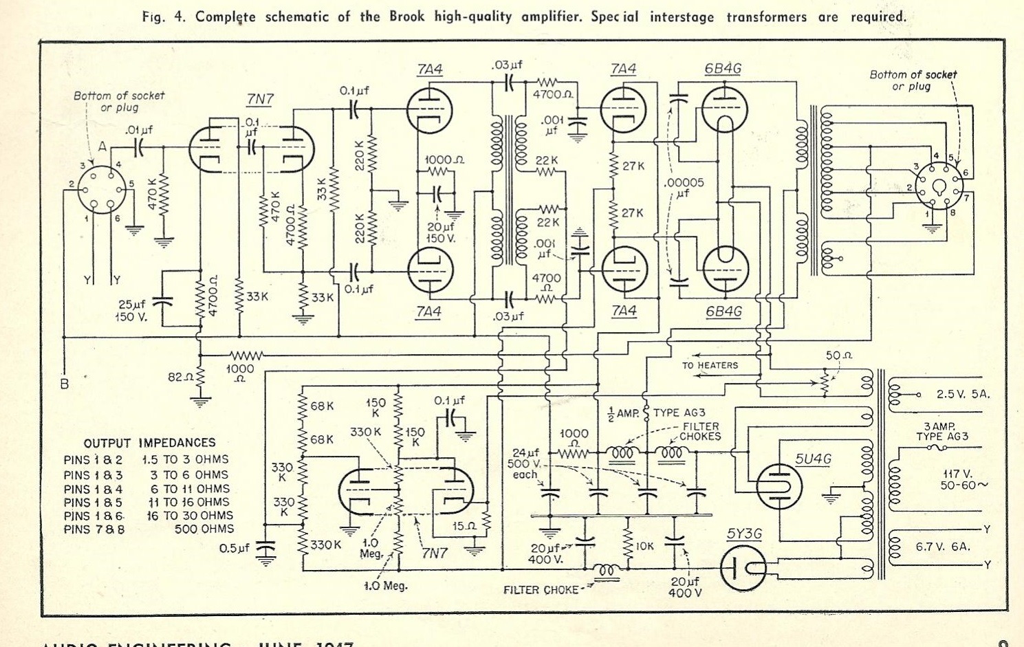

Study what you've drawn and you'll see the problems: grid leaks, grid stops, bias source. Also remember that your added adjustments can only decrease the bias voltage from its original value, so you need to start higher.
