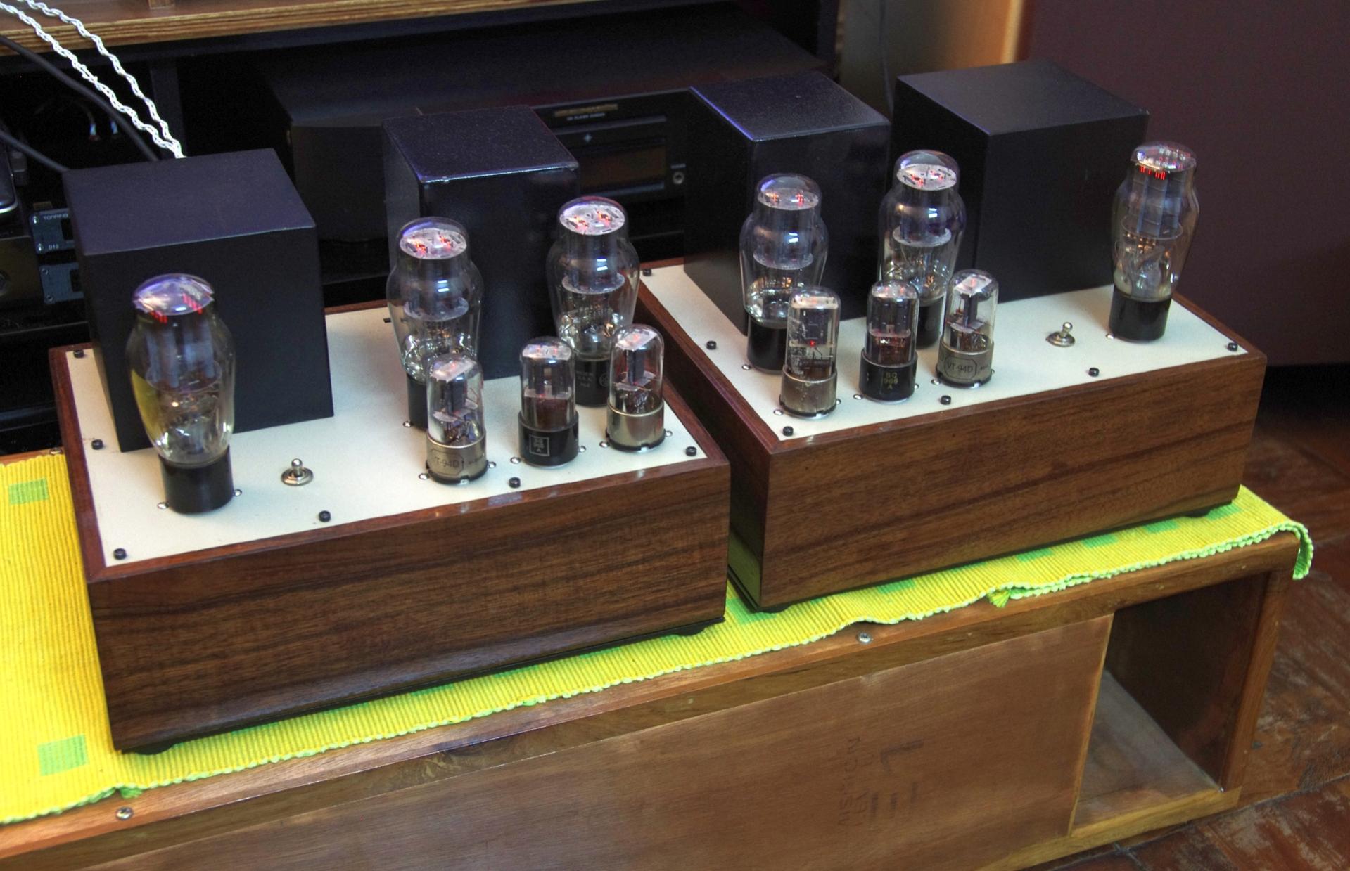

Brook 12A Mono blocks

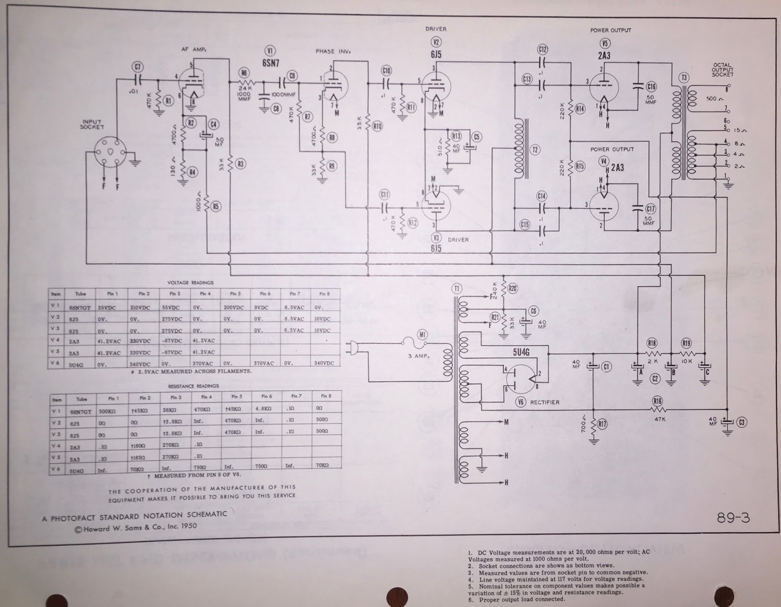

The power supply was built off this schematic. Measurements shown here are to spec in the build. The negative bias voltage is -63v, a little less than the -67v since the mains supply is lower as well.
Does that help.

The 2A3s are fine. We noticed the missing heater V and have a 1.5v supply.
I'm reworking the power supply from scratch trying to keep with the original. Could somebody take a look at the choke after the first tap. It's helped control the hum by a lot. I'd like to eliminate that as being one of the problems.
We've also seen one of the dual-caps short, so that'll be replaced soon. The PS values I've used is in this link, from post #35.
