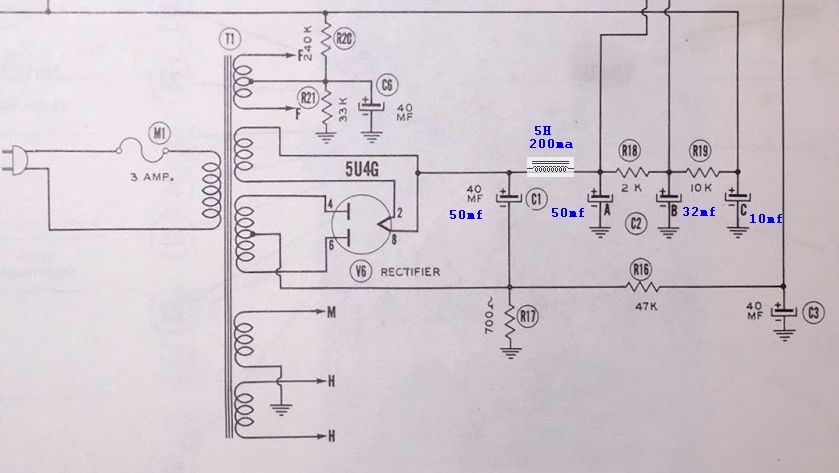

I've got the Brook going. There are some strange things happening. The NFB is at 1K.
It runs fine with great HF, ok mids and very little bass till about 30-45m. Then the sound balances out nicely.
After about an hour-and-half, the mains trafo gets uncomfortably hot and the bass from the speakers starts popping. You can hear a constant popping noise on bass from the music. It is not too evident at low volumes.
I don't want to hijack this thread and am happy to start a new one. Just thought I'd keep the Brook info in one location. Any help would be great. Thanks.
Here's a scribbled image of the values. Forgot to mention, these are not monoblocks. The PS is one BIG chunk of IRON for both channels in a single chassis.
