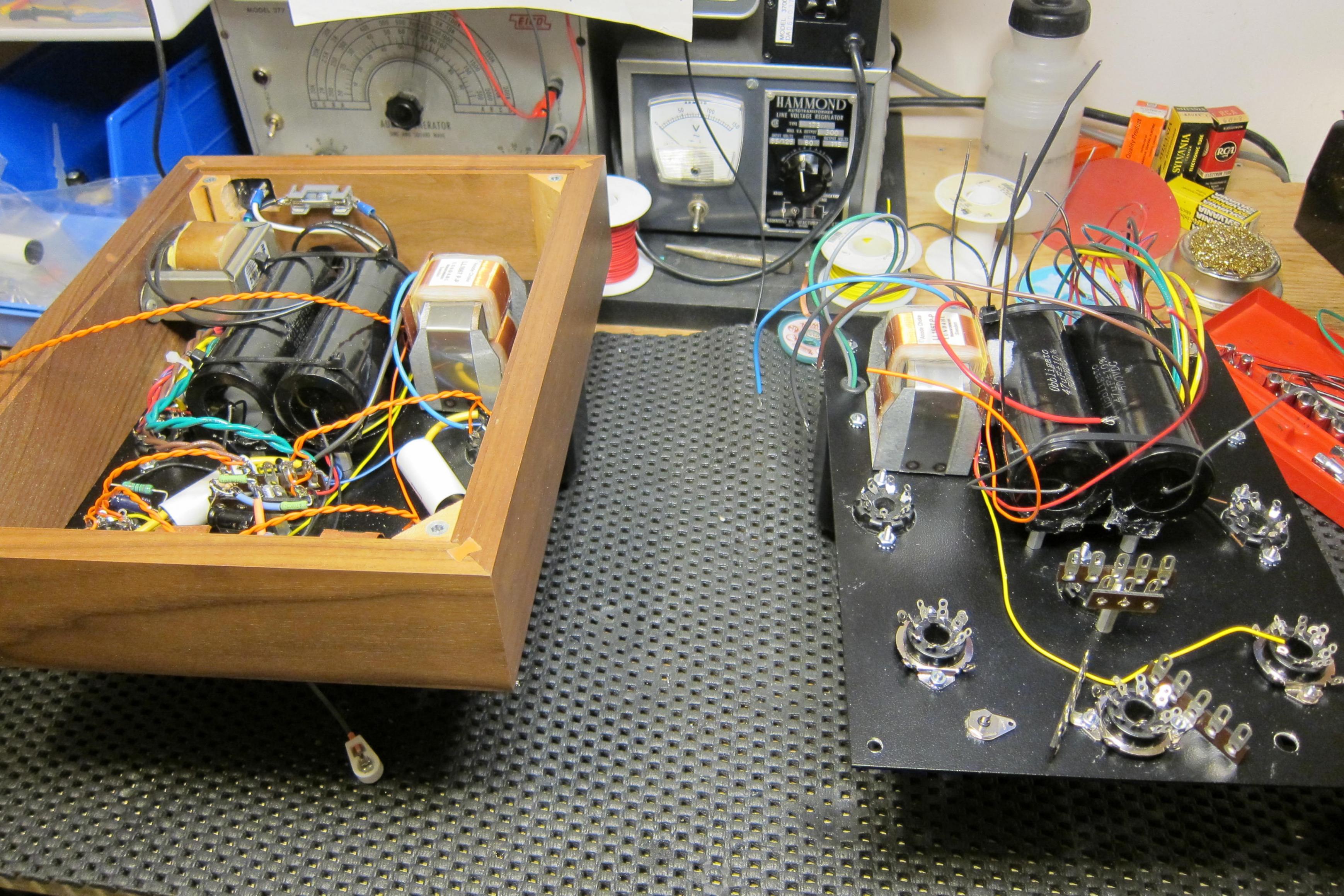

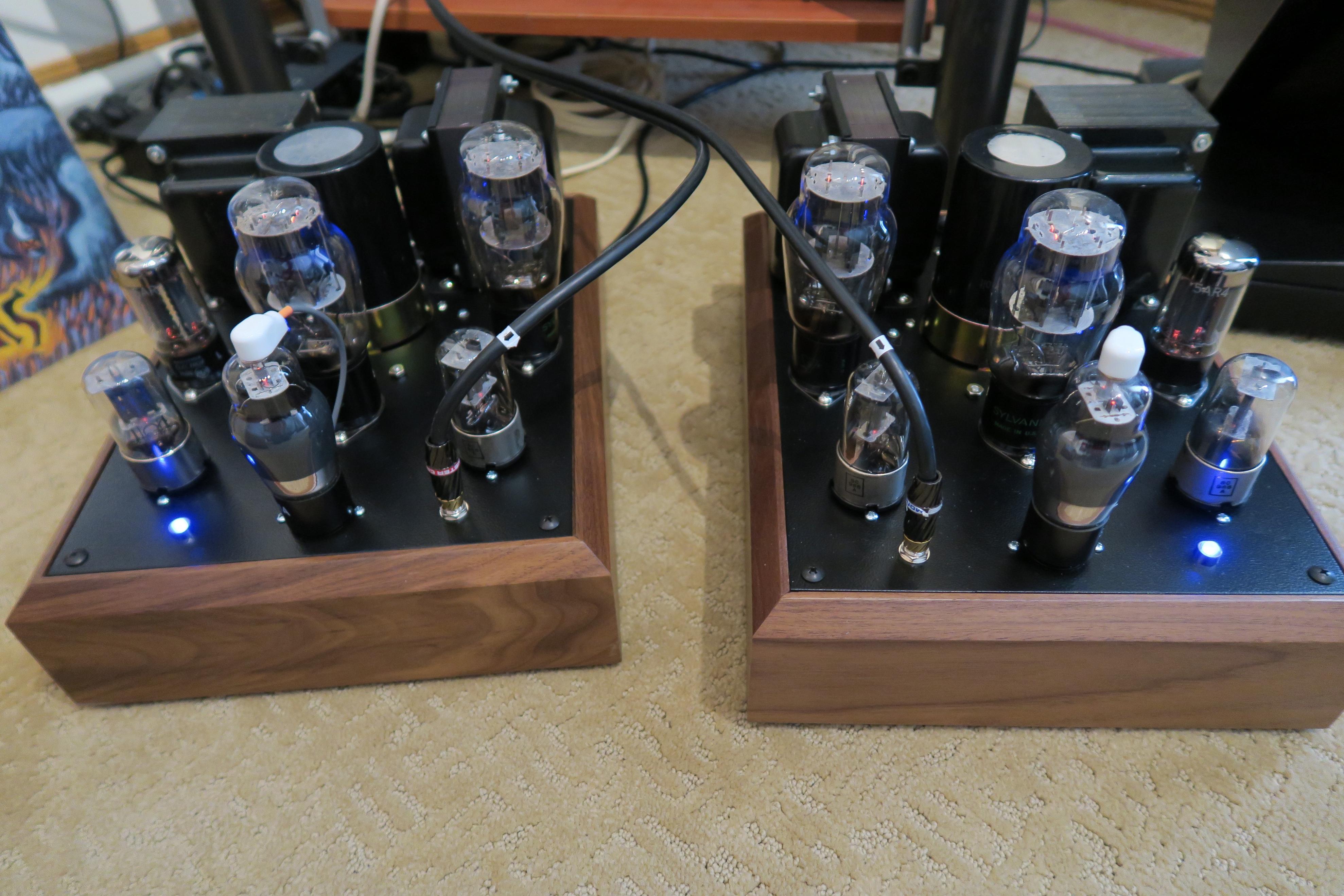

A very long gestation period for these as I started accumulating tubes almost 10 years ago-good thing as they're much more dear now. As for the particulars, outputs are 6A5G's, subbing for the 2A3's in the original. The input is 6F8G, an obscure and great-sounding 6SN7. Power transformer is custom wound by Heyboer, OPT's are Electra Print. I had to add a choke in the power supply as hum was unbearable without it in spite of increased capacitance. They sound wonderful, like listening to all my music for the first time. Many thanks to some of you who answered my queries concerning this build and especially to Briney who has built the same, although more true to the original.

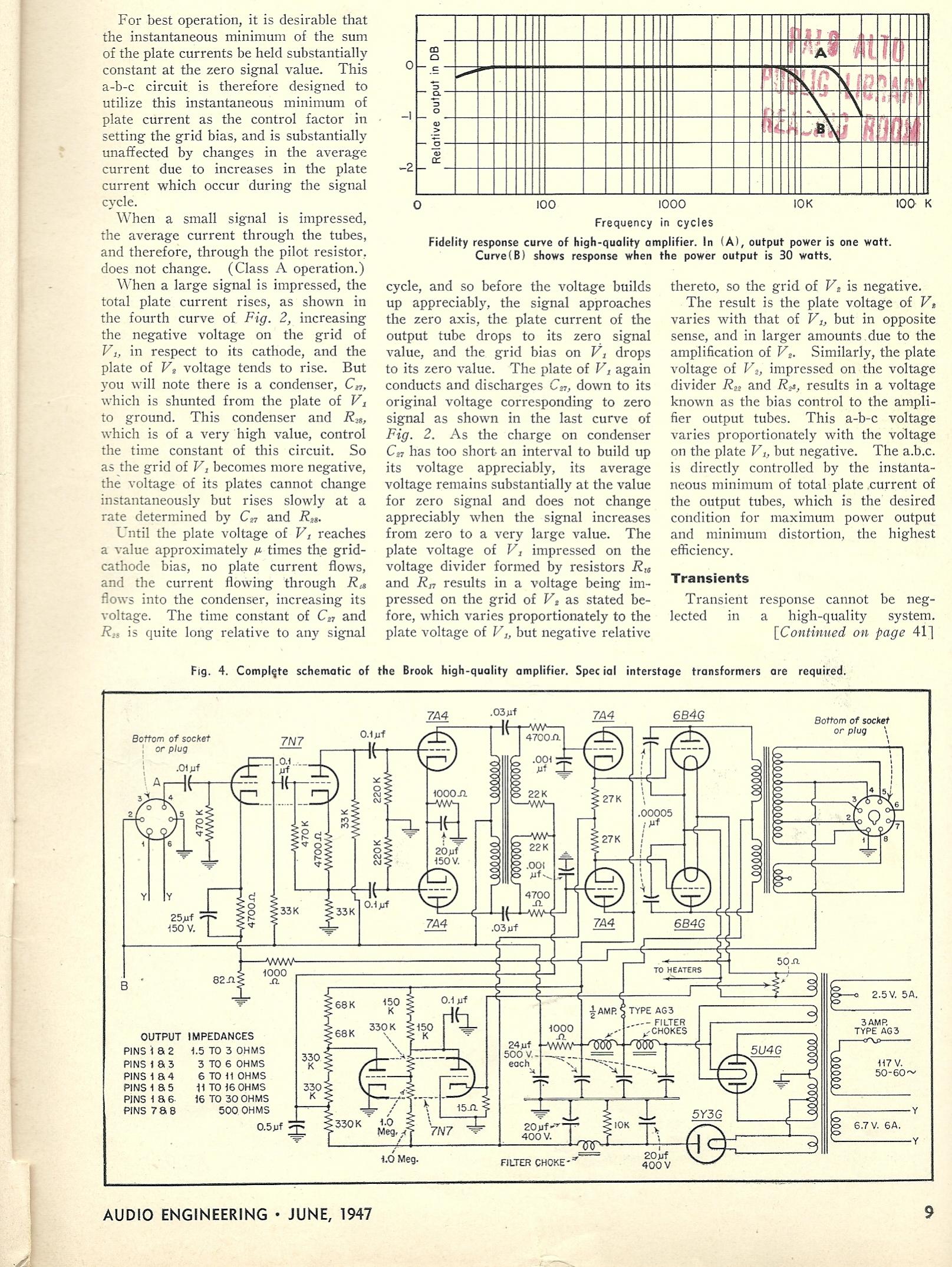

Where can we find a schematic, unique1?
Here's the schematic:
http://www.ampslab.com/SCHEMATICS/Brook12A.gif
Please note I built a C- supply for the bias and used a 5AR4 rectifier which resulted in a 300-0-300 PT with the low impedance caps. Plate voltages are within 4v of schematic values. The triode side of the VT-99 with the grid cap was used for the splitter. It would have been rather weird to have mounted an RCA jack on top of the tube if that was to have been V1. No, I can't take credit for the chassis, Hammond. The PT also has two 6.3v filament supplies which I specified as the 6A5G's have their own centre tap and I elevated the centre tap for the preamp tubes.

I personally would try out the cap plate triode for input differential amplifier on the 6F8G... and make sure there is a decent sized grid stopper on the phase splitter as well. 😉

Mr. Briney, they sound spectacular, in my estimation. I've never heard things in my music that I'm hearing now. Super solid and extended bass, nuance, fluidity, detail, sweet top end. They're not overly loud at 10w or so but drive my Duevels nicely. I'm going to get the Cornwalls out for an audition as well.
Many thanks again for your help although I deviated quite a bit, especially with the power supply and the 5AR4 rectifier.
