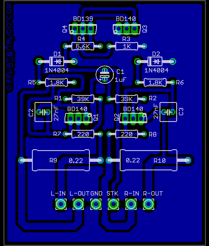

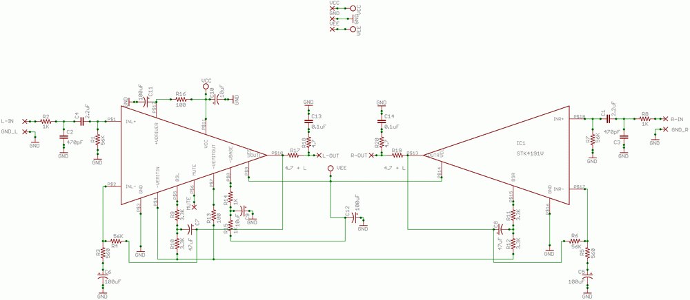

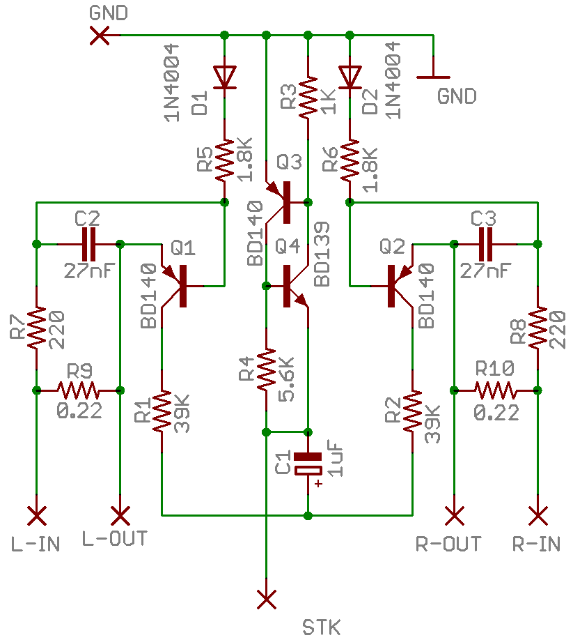

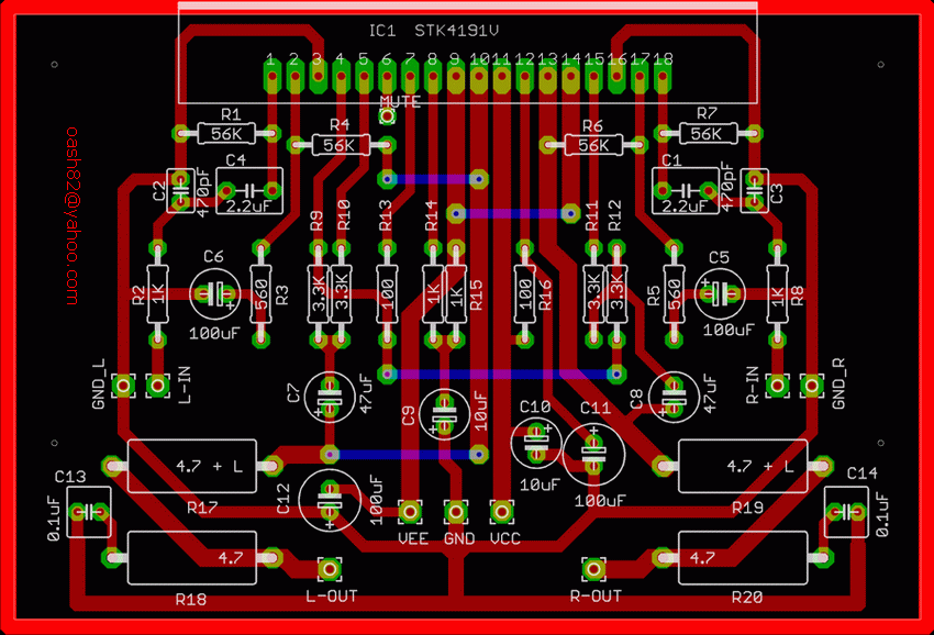

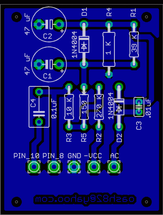

Hi, Metal, can you post Eagle files for the STK4191 PCB design, and for the stereo protection PCB... Thanks
pcb lay out of stk4050
hi METAL,
STK4191V PCB design
Attachment: stk4191v_brd.gif
This has been downloaded 1156 time(
amazing design! for this pcb lay out of stk4191, can make same lay out for stk4050.
thanks
hi METAL,
STK4191V PCB design
thanks
anybody can show this circuit work to protect amp?STK4191V stereo protection schematic
