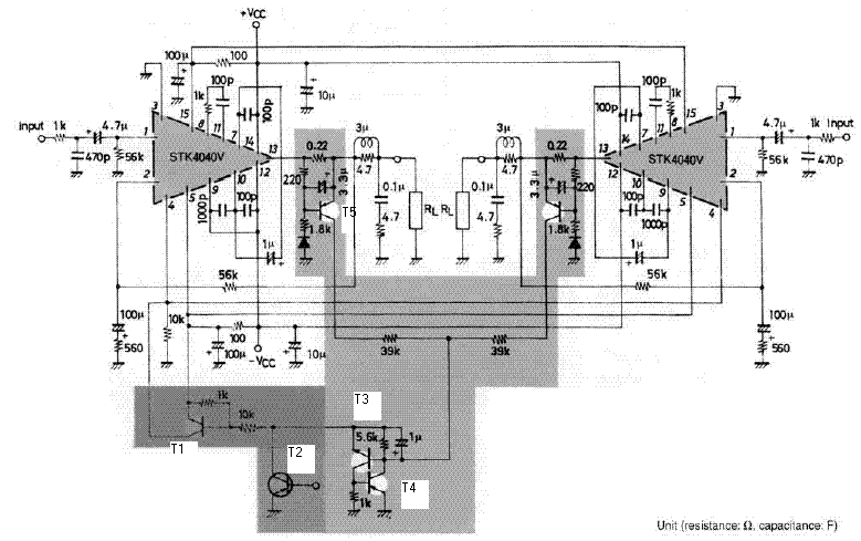

Mute and protection circuit for STK module
Hi everyone,
Is there someone who knows how the mute and protection circuit for the STK modules work?
I've found this circuit in the datasheet of the STK4040V.
As you can see in the figure I attached, I've given the transistors a name T1,T2,T3...
I think that T1 and T2 are the transistors for the mute circuit and T3,T4 and T5 for the protection.
When T2 is ON I think there is muting.
At high output current output there is also muting. I don't understand the 3.3 microfarad capacitor over the 0.22 Ohm output resistor. The voltage is AC how can you put an elco over it.
If I want to avoid cracks and plops during power on, can I solve this when I put a resistor, capacitor network on the base of T2. Just like a reset circuit?
Can someone help me with a detailed explanation of this?
Best regards
Kurt
Mute and protection schematic for STK
Schematic
Hi Kurt
It seems that we both have the same problem,I have seen this protection circuit in STK4191II datasheet,to be honest I could not understand how its working.
But I think that the 3.3 uF capacitor is for a time constant along with the 220 Ohm resistor,I mean when the DC output offset is 0.7 volt,it gives delay before the BE voltage reaches 0.7 volt for the transistor on the output,and the muting occurs .
