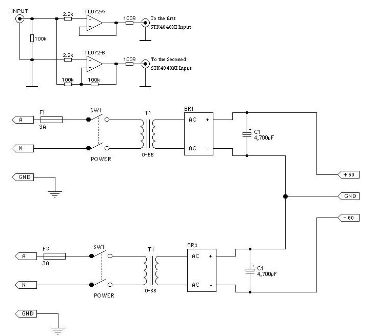

HI All
I have decided to built bridged amp with two stk4050, i have one and i have ordered a second stk. Now, I want to ask you do you think that best way to do this is by using the schematic that metal posted (schematic with two TL072)?
metal, if i use this schematic I dont have to make any changes to schematics that are given in the STK's datasheet, I just have to connect the output from the first TL072 to the input of one STK amp and the output of the second TL072 to the input of the other STK amp (which both are non-inverting just like in the datasheet) Please correct me if im wrong!!!
Another thing, what power supply should I use for this amplifier?Should I have 2x66VDC for each STK??? Please help me with this
Hello skobo
No need to change the original schematicccs of the STKs your are going to use.
Both STKs will be running in non-inverting configuration, I built this circuit long time ago, and results were very good.
The first Opamp is connected as buffer only, while the second is configured as an inverting Opamp.
I have used the first Opamp as a buffer cuz I noticed that the inverting Opamp may add phase delay to the second STK, so I used the first Opamp as a buffer to add the same phase delay to the first STK, and obtain best possible results.
Also bear in mind that you don't have to bother your self by desiging another inverted STK circuit nor the PCB design, so that both STKs will be running as non-inverting amplifiers and they have the same electrical and frequency response charctersistics.
Regarding the power supply, note that each STK will be virtually driving 4 Ohm inductive load, not 8 Ohm. You better use 60+/- volts power supply, and each transformer must be capable of delivering 7.5 Ampere at least.
Look at the accompanying diagram please.

Don't use the schematic in the Datasheet.
Lower the gain to ~26 and take the inductor from the output.
In my opinion the best STK chip to bridge is the STK401-330 😉
You can bridge each chip( each one as 2 channels).

To Metal
Thanks for the advice.Reading all posts answered some open questions.There is still one question: where do I collect the output power from the bridged amplifier?
Maybe it is a dumb question but i have to ask it.
1.Do I connect the speaker between the outputs of the two stk ic's?
2.Or I connect the two outputs together in one point and the other point for connecting the speaker will be the ground?
Like I said it is the first time I bridge amplifiers.
Please don't be upset,take your time and give me an answer.

Hello
You take the first output "Non - Inverted, and connect it to "+" terminal of your speaker, take the second output "Inverted" and connect it to "-" terminal of the speaker. Don't ever think about connecting both outputs together, as you are gonna blow the STKs, cuz they give inphase signal, but with opposite polarities.
So, no GND is connected to speaker, niether any outputs, ok 🙂
I am not upset, and rarely I do.
The schematic with the two tl op-amps is clear. One of the tl drives one stk and the other tl drives the second stk. Exactly 🙂
Regards

Hello AudioIng
Good luck 🙂
Just don't turn the volume too high when it works. And you better add 10 Ohm 5 watt resistors on the supplies rails when you first carry the tests.
