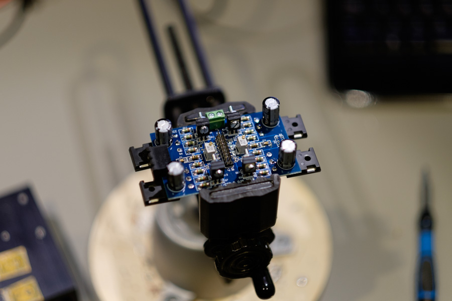

The new CFP PCB from Seeed is finally here! Two weeks from Seeed to Norway, and another two weeks through customs processing by the postal service... 🙄
Anyway, moved all the parts over from the previous CFP effort, using BD139/140 as drivers, soon ready to turn it on. Stay tuned!
Very interesting.
What is your soldering technique ? What is the size of this PCB ?
Is this the entire amp or a module ?
I'm just using a regular old soldering station. The PCB is 50x80mm. This is just the output stage, drivers and output transistors and Vbe multiplier. The opamp stage is on a separate PCB that plugs into the pin header. I'm very pleased with this modular approach, allows easy testing of different input and output stages.

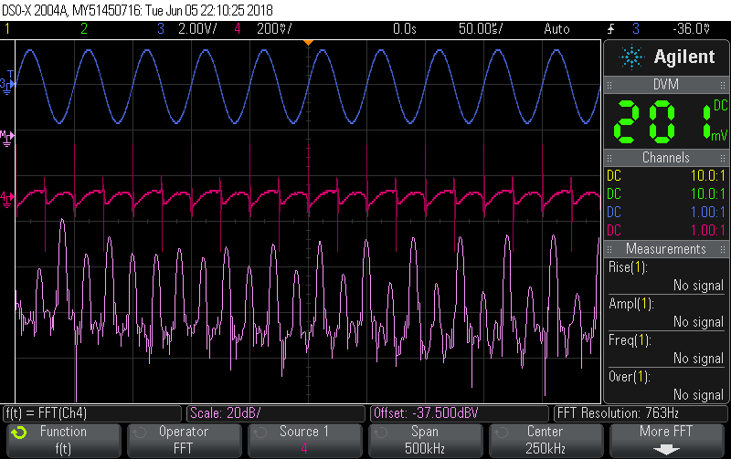

And the results are in!
Unfortunately, it's disappointing. The BD139/140 drivers needed 100p CB caps and 22R base stopper resistors in order to become stable...
The THDN results then became exactly the same as those in post 54.
So a lot of work for no improvement, but I'll chalk it up as a learning experience. It's a shame because the CFP really excels in one department: Keeping a very stable idle current! No matter how warm the amp is, the idle current immediately settles to the correct value.

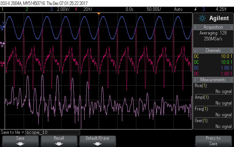

So I am going back to the EF output stage from here on in my quest for linearity. The reason is shown quite clearly in these 'scope captures:
Trace 3 and 4 is the monitor output and the distortion residual respectively from the AP1. The signal is 20kHz/10W/8ohm and the analyzer bandwith is set to 500kHz.
scope_10.png is with the EF output stage and scope_20.png is with the CFP output stage. Note the different scale of trace 4, the distortion residual! The math trace shows the FFT of the distortion residual with 50kHz/div. All the high order harmonics resulting from crossover distortion in the CFP stage is quite something...
