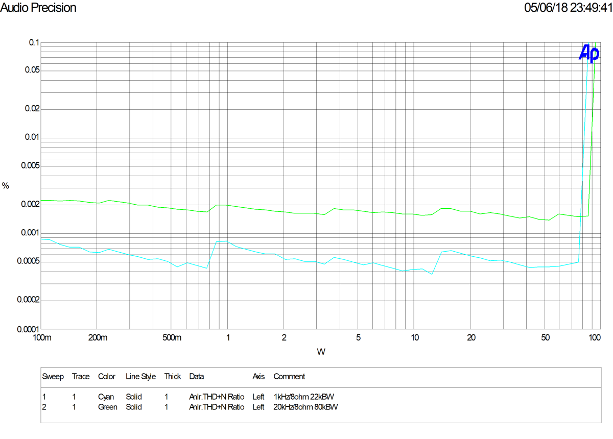

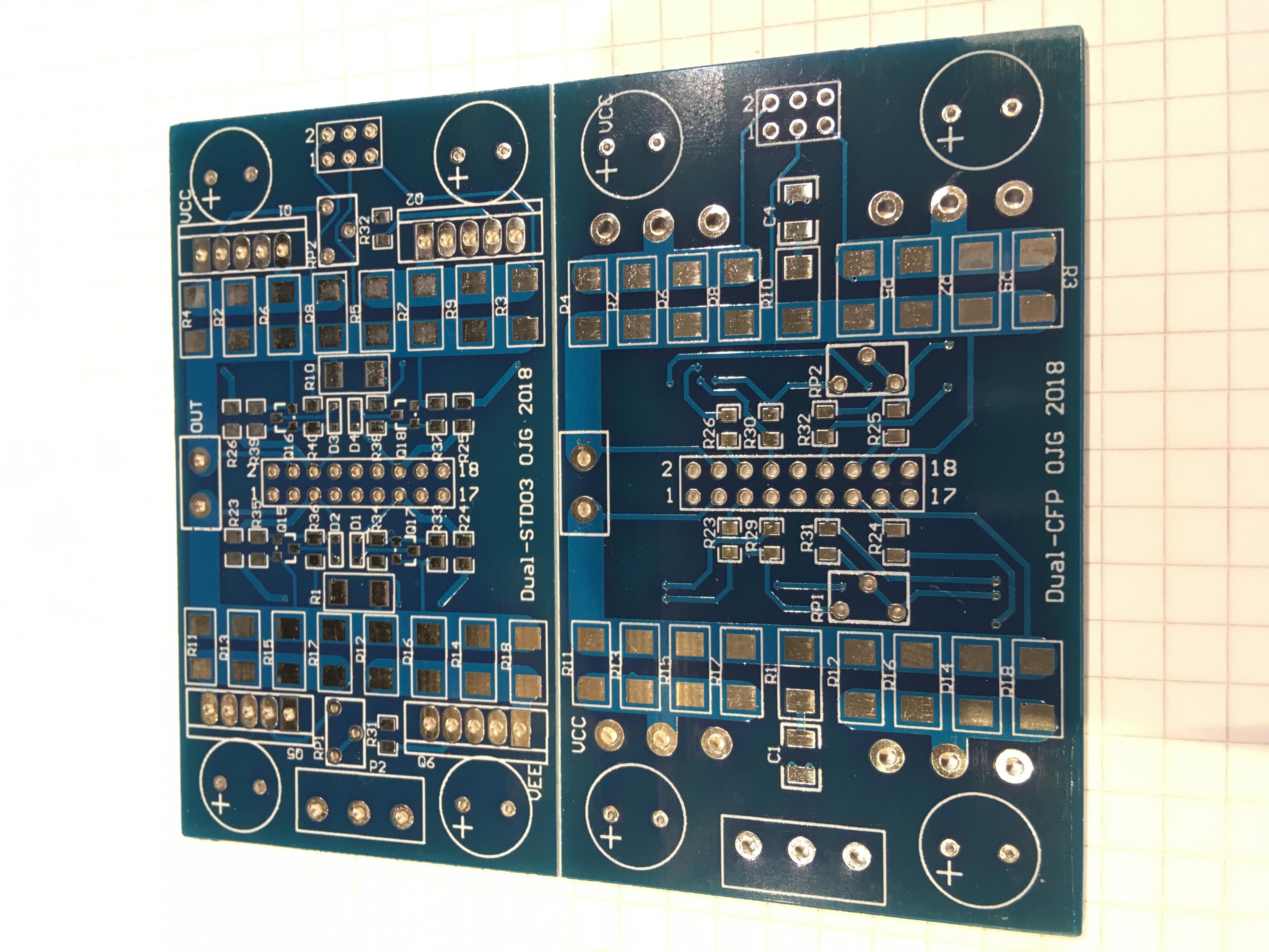

Update!
Received PCBs from Seedstudio finally. This is both the CFP and the STD03 based output stages. I have the parts for the CFP stage, but not sure when I will have the time to solder it up, busy both at work and at home this month.
Also I don't have high hopes for the CFP stage, it oscillates in LTSpice no matter what I do...
The Cordell DM I ordered from Pilgham Audio has still not arrived, hopefully it's just bad luck.

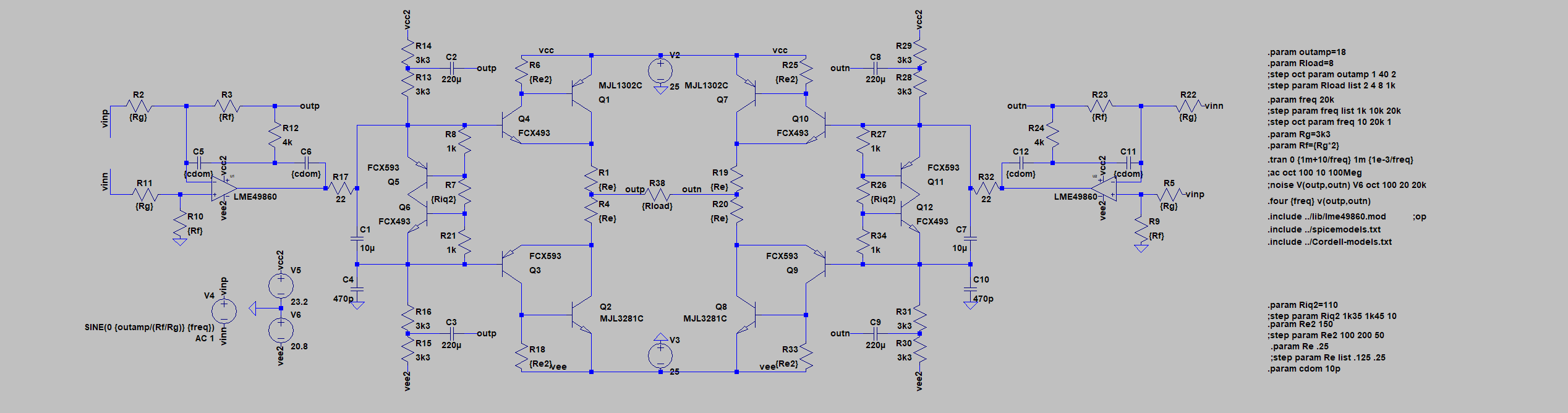

Thanks for the update.
This is bad news about CFP.
I have no stability issue whatsoever with LTspice on a op amp design with LT6090 and CFP with Toshiba 2SC5200/2SA1949 TTA004/TTC004. Models from LT and Toshiba. With large capacitive load it does need an output inductor to go back stable, with simulated inductive tracks base stoppers do restore stability.
I understand about such topology that, for stability, the current booster needs a faster Ft than the op amp. What about Ft of the driver bjt versus the output bjt ? I am confused about this but think that is the key for stability of an op amp with CFP. What do you think ? Should we have FT of op amp < driver < output, OR, op amp < output < driver.
Have you tried caps at c.b. of drivers to decrease their effective Ft ? Then may be the op amp is too fast.
To be honest, I do not understand well enough CFP stability and wish all helps and comments about this.

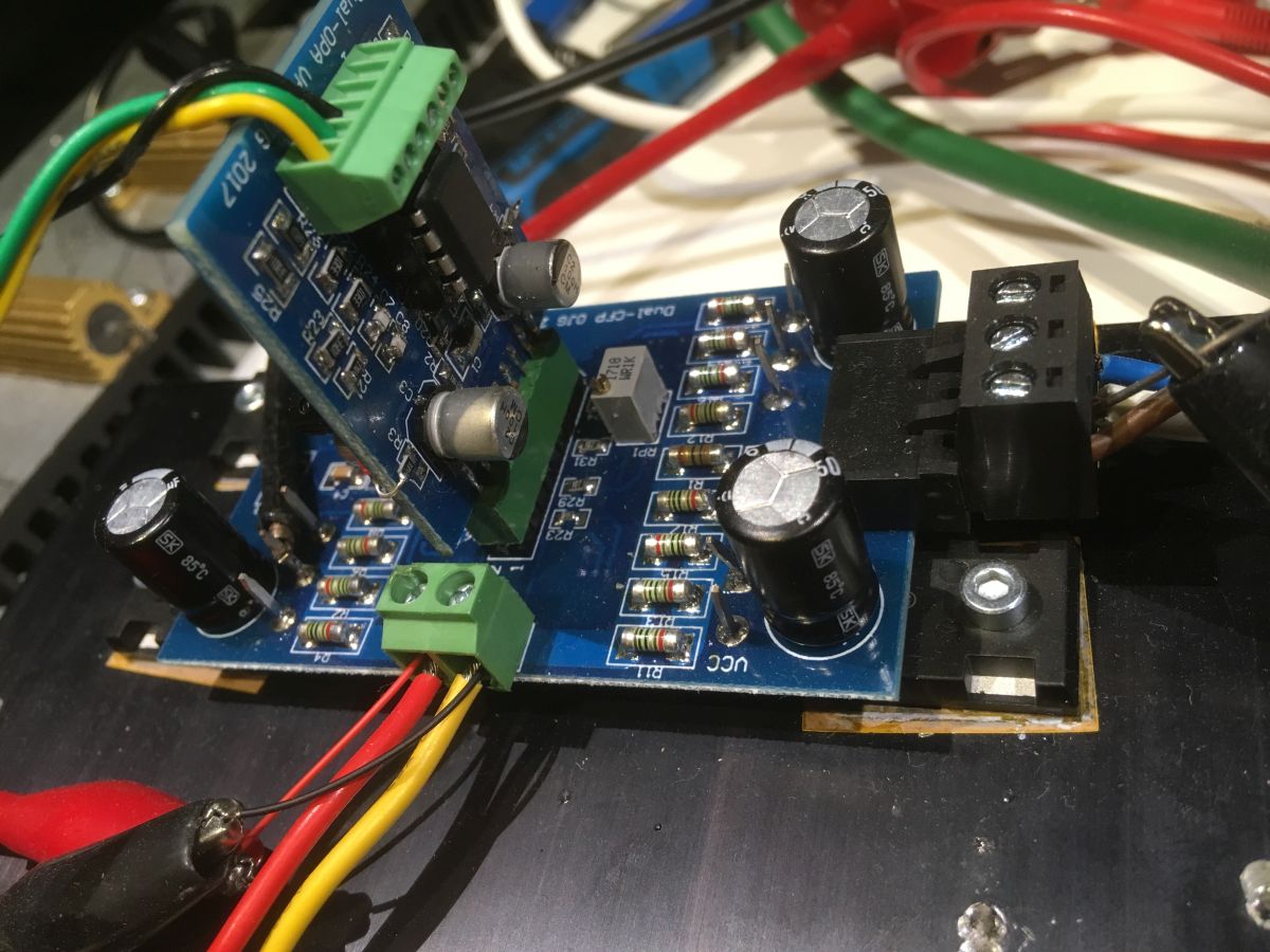

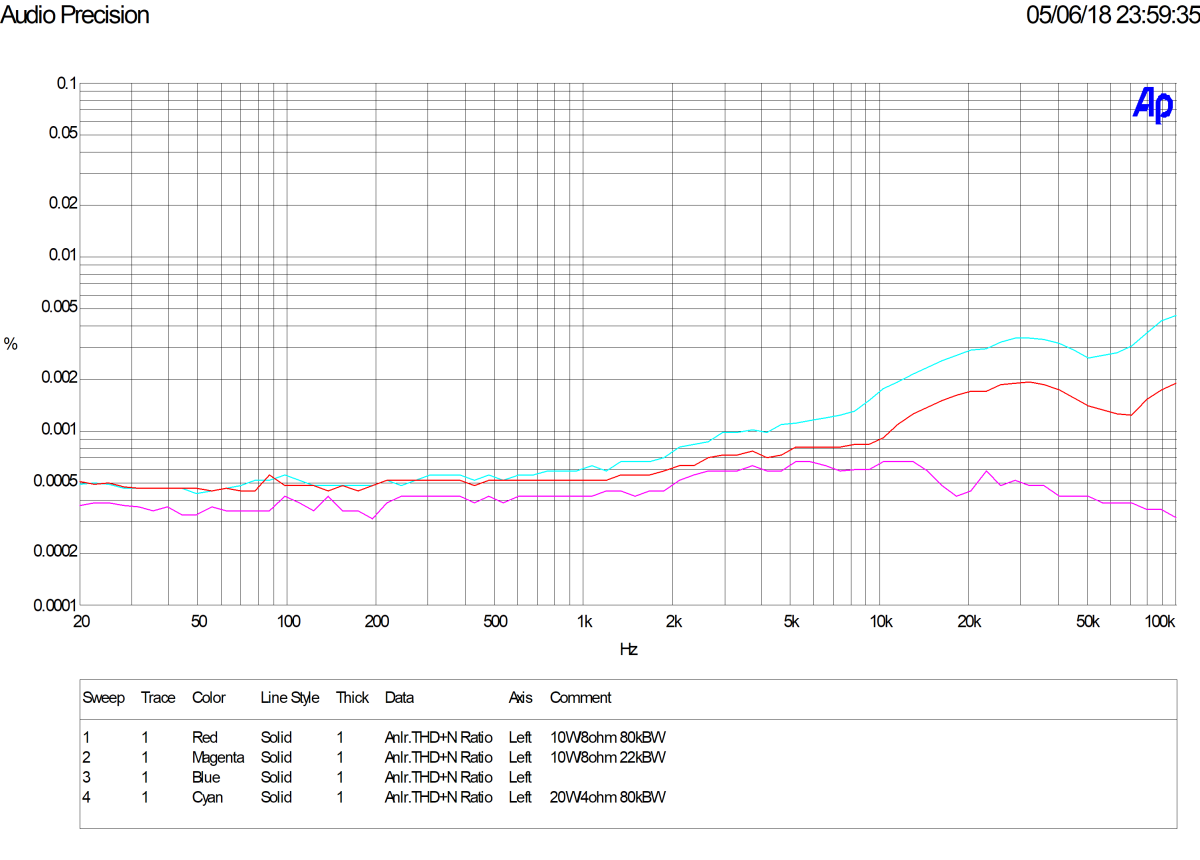

Finally an update!
I have assembled and tested the CFP output stage. And my fears came through, it oscillated like crazy in the beginning.
After lots of experimentation on compensation I ended up with a RC filter (22R/470p) between the opamp and the output stage in addition to usual TMC compensation (10p/4k/10p).
This throws away quite a bit of loopgain compared with the EF output stage.
This shows in the measured THD as well. Although it's below the measurement floor for frequencies <1kHz, it rises above that and ends up at 16-20ppm at 20kHz.
That number may still be ok, but what worries me is the distribution of the harmonics. Lots of high-order harmonics due to a very sharp discontinuity at the crossover.
The textbooks and simulations predicted this, but I didn't think it would be this bad in practice, but it is. So the CFP seems to be a dead-end, unless someone has a good tip for me on how to "fix" it.
It's ok that Vbe multiplier ? You switch the transistors between them. About outputstage.....where are the base stop resistors ?
Yes I believe the Vbe multiplier is ok, although I know the collectors of the Vbe transistors do not have a well-define voltage.
Actually the idle current is one of the things that is very good with this CFP stage. It is very stable, and settles quickly to the correct value after a transient.
Also a nice feature of the CFP is that the optimal bias current is lower than the EF stage, and so it runs very cool. Just 0.1A idle supply current for the whole amp.
"You switch the transistors between them." Not sure what you mean here, want to explain some more?
I believe R17 and R32 works as base-stop resistors. I also tried adding resistors (10ohm) to each driver base, but that was not enough to prevent oscillation.
Perhaps, as mchambin points out, that the CFP stage works better with slower driver transistors. I think we need FT of op amp < driver < output.
You can try adding miller (C-B) caps to the CFP. First try drivers, then try o/p's... No guarantees.
For the sim imho start with just the "one half" and get it straight first.
Also I would delete the R12 at the beginning. Add it back in when you get the whole o/p stage to behave.
In my head the caps from driver base to ground achieves the same thing, but perhaps I am mistaken? There is very little signal swing on the drivers collector, so connecting the capacitor from base to collector, or base to ground is almost the same thing? I'd be happy to hear an explanation of why there is any significant difference.
Of course, I only sim one half of the amplifer for stability.For the sim imho start with just the "one half" and get it straight first.
Of course, I did.Also I would delete the R12 at the beginning. Add it back in when you get the whole o/p stage to behave.
I guess that the 470pF - 22R filter is bad idea as it adds
phase to the output stage.
Your problem is a very fast opamp stage which drives
a slow output power stage.
The opamp sees an error and tries to correct it,
but the slow output can not follow in time,
and the opamp is shooting over the goal.
The solution is to make the opamp stage slower.
Try to avoid TMC for the start and leave out R12 and C6 in
the feedback.
Increase the very small 10 pF to 100 pF and make some
tests with a fast rising pulse.
The 100pF between opamp output and negative input
builds an integrator and this slows down the opamp stage.
Do some tests with fast rising pulses and capacitive loads.
I would guess that you get more troubles as you have
no isolating inductor at the output and no snubber.
An output capacitive load together with the open loop
amp output resistance is a R-C filter, which adds phase.
A good amplifier has zero overshoot.
For audio purposes, a bessel filter with constant group delay
may even be preferable.
The problem with the CFP is that it is really a small inverting amplifier
with gain. Here you have a similar probem: a fast driver
transistor and a slow output transistor.
Try to add a Miller C between the Collector and base of the driver...
Your amplifier is a cascade of two stages:
The opamp stage should be designed to have unity gain frequency of
about 500kHz (= -90 degree of phase).
The output power stage (with gain of 1) should not add more than about
-45 degree at 500kHz.
This would give you a small overshoot as in a Butterworth filter.
You can test the opamp driver and the output driver in isolation.
Each should be stable in isolation. the output stage should not add
more than 45 degree of phase at the unity gain frequency of the
opamp stage.

Hi udok, thank you for the long and useful reply.
I agree with most of your analysis, it is a fast opamp driving an output stage which in itself is a 2-stage amplifier with feedback using fast input transistor and comparatively slow output transistors. It's a configuration asking for trouble.
I know one solution is to slow down the opamp stage. But that means less NFB available to suppress the quite nasty high-order crossover distortion from the CFP stage. So I would like to avoid that solution as much as possible.
I have not tested with capacitive loads yet, first it needs to be stable with a simple load resistor. I don't have an output inductor, but I do have a snubber although the ltspice schematic does not show it.
I will try and add a capacitor between base and collector of the driver transistor, since two of you have suggested it. Although I still don't see what the practical difference is between a base-collector capacitor or a base-ground capacitor. All the voltage swing is on the base, the collector is swinging almost no voltage.
Why should it be 500kHz of GBW? What is so special about that number? I'd like it to be as high as possible, while still keeping phase-margin high.
Here are my notes from the different compensation variants I have tried so far:
47p MC + no LPF + 0R RB -> oscillation
47p MC + 22R/470p LPF + 0R RB -> stable
22p/4k TMC + 22R/470p LPF + 0R RB -> stable
10p/4k TMC + 22R/100p LPF + 0R RB -> oscillation
22p/4k TMC + 22R/100p LPF + 0R RB -> oscillation
22p/1k TMC + 22R/100p LPF + 0R RB -> oscillation
10p/1k TMC + 22R/100p LPF + 0R RB -> oscillation
10p/1k TMC + 22R/470p LPF + 0R RB -> stable -> 0.00400% THD+N at 20kHz/10W/80kBW
10p/NU MC + 22R/470p LPF + 0R RB -> stable -> 0.00220% THD+N at 20kHz/10W/80kBW
10p/4k TMC + 22R/470p LPF + 0R RB -> stable -> 0.00160% THD+N at 20kHz/10W/80kBW
10p/10k TMC + 22R/470p LPF + 0R RB -> stable -> 0.00160% THD+N at 20kHz/10W/80kBW
5p/10k TMC + 22R/470p LPF + 0R RB -> oscillation
5p/2k7 TMC + 22R/470p LPF + 0R RB -> oscillation
10p/2k7 TMC + 22R/470p LPF + 0R RB -> stable -> 0.00160% THD+N at 20kHz/10W/80kBW

While playing a little with the spice simulation I discovered that with the old BD139/140 from Cordell's models, the amp was stable without any 22R/470p LPF. So I decided to make a variant of the output board with TO126 drivers. Sim with the MJE340/350 models oscillated again, so it might not be big success. We'll see.
The design is sent to Seeed so they can make it while I'm on summer vacation. The weather has been exceptionally nice here this summer so it means spending time outdoors is prioritized higher. It might therefore be a while until the next update.
