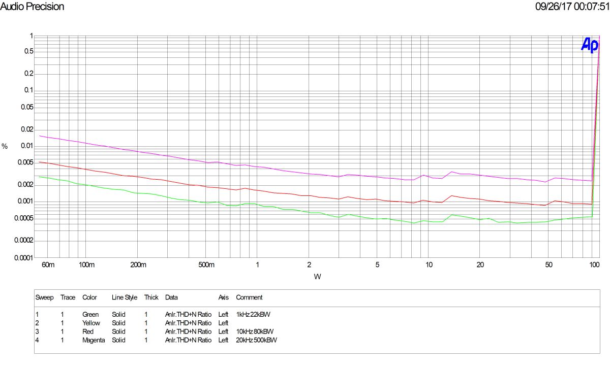

What is the Gain, 5 ? Load, 8 Ohm ?
What are the BW figures about ?
Gain is 2 * 22k/3.3k = 13.3 = 22.5dB
Load is 8 ohm unless stated otherwise, I probably forgot to say that.
BW is the measurement bandwidth of the AP. It is essential to know the measurement bandwidth when comparing results. Be very sceptical of THD numbers or plots where the measurement bandwidth isn't stated. It usually either means that they are trying to make the numbers look good for bragging/marketing purpose, or that they don't really know what they are doing. Especially THD20 numbers (THD @ 20kHz) depend a lot on whether the bandwidth is 80k or 500k or something else.
The parts arrived, I can now mount the MJL3281/1302 and LME49860 as intended. Also add regulators to set the opamp supply voltage to +23.4V/-21.4V.
And it still works and is stable, even without compensation cap! This is now a very high-bandwidth amplifier.
The optimal output stage idle current, for lowest THDN at 20kHz/5W/80kBW is now 75mA, which is _exactly_ the same as what LTspice predicted would be the optimal idle current! It is still less than what the "Oliver" current would be (104mA).

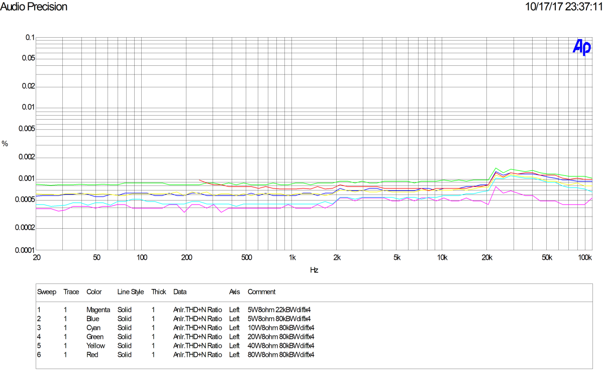

With the MJW3281/1302 and +-26V supplies, the amplifier clips at 90W/8ohm. The THDN with 22kHz measurement bandwidth is ~5-8ppm at all frequencies, probably hitting the noisefloor. With 80kHz measurement bandwidth the THDN is just around 8-15ppm at all frequencies.
Note the THDN measurement out to 100kHz with a 500kHz measurement bandwidth, 0.01% at 100kHz...

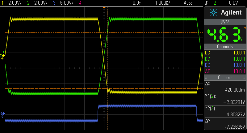

That it didn't need compensation surprised me a little. The LTspice sim required about 10pF compensation to be stable, so it was close. I was expecting the actual hardware to be more difficult to stabilize than the sim.
Here is a scope capture of a 100kHz squarewave. The blue curve is the input signal, the green and yellow are the two output phases.
There is about 2% overshoot which makes out to about 70 degrees phasemargin. It could be that some ringing is caused by the measurement setup, scope probe ground loops etc.
The slew rate is 7.2V / 420ns = 17V/us. Which is expected since the LME49860 has a specified slewrate of 15-20V/us. The slew-rate does not win any spec competition, but the full power bandwidth is still 140kHz. Should be enough 🙂

Lowering the gain should lower THD even more, it is stable at 6dB of gain in each "leg", so 12dB of gain in total.
THD at 20kHz with 80kHz measurement bandwidth is then less than 8ppm for all levels up to 80W/8ohm.

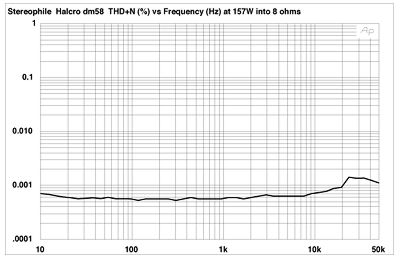

Does anyone remember the splash the Halcro amplifier made 15 years ago? It was hailed as the low-distortion benchmark of its time. The Stereophile measurement looks strikingly similiar to my own. Which indicates two things: Since the curves are so similar it indicates that my AP1 is ok. And with this amp I've reached the measurement limit of the AP1 just like Stereophile did with the Halcro. 😎

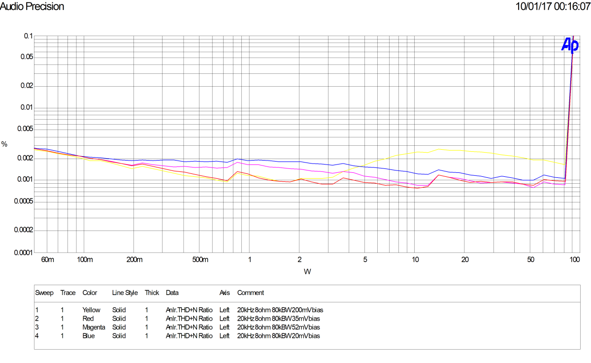

Here is the plot of THD vs amplitude for different output stage bias currents.
The blue line is underbias: 20mV over the pair of 0.25ohm emitter resistors.
The magenta line is the theoretical optimal bias quoted in several books of 26mV / Re.
The red line is the optimal bias adjusted for lowest measured THD. It comes out as 35mV in this case.
The yellow line is what happens when you try to bias the output stage into a "high-bias class AB". Clearly the worst above a few watts, and not better than the optimal bias voltage in the class-A region either.

I like to see, the optimal bias is quite far from the over tutted Oliver optimum bias.
I like to see, over biasing is no good.

I see the optimal bias and the over biased as being near enough identical and both better than under biased all the way from very low levels up to ~-17dB ref maximum.
That's where we do much of our listening.
And when the high bias gets louder, the distortion is not as bad as under-biased until louder than -17dB ref max.
If one sets up the amplifier bias such that optimal is as low as it ever gets and any drift is towards the slightly over biased, then the plots show that one gets the best of all.
35mVbe to 52mVbe looks nice over the full range of all operating conditions, if this can be achieved.
And avoid underbias of 20mVbe and avoid 200mVbe.

In the measured amp the difference is greater. One other benefit with the bridged amp that does not show up in simulation is that there is no large signal currents in the ground path which can affect things.
Agree.

Thanks to your simulations and Fourrier, it is clear the odd harmonics are doubled as expected and the even harmonics are cancelled.
No doubt, this interesting cancelling comes from the bridged topology, however I was enable to make a valid proof of this.
On a design, of my own using a LTC6090 and a CFP unity gain output stage, with massive feedback. My simulations show a different behavior at low powers. Below a certain power that depends of the chosen bias, the Thd decreases to extreme low as output power decreases.
This seems logical to me, since at low power the amp runs in class A and low amplitude signals linearize circuits around the operating point.
For instance with Rload 8 Ohm, Re 0.25 Ohm, quiescent current at 140mA, your amp runs in class A at output powers below 160mW.
I see your thd+n curves go increasing below 200mW, where in my simulations I see the contrary. What's wrong in my simulations ? Could that simply be because they give Thd, not Thd+N.
Will you add zobel networks and an inductor at output. I presume you prefer to put them outside the PCBs.
An inductor to cut at 80KHz 3dB will give you a substantial improvement of THD20.
You already have 0.0005%. With the inductor, I guess-estimated you can expect 0.0002%.
