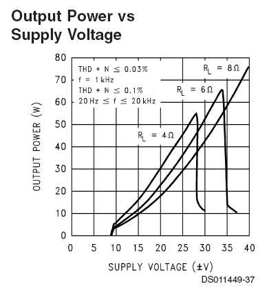

Well, I decided to look into this Bridgeclone thing, since I have a lot of heatsinks sitting around that I have been stocking up for the past 2 years... and I also have a bunch of gainclone pcbs.
Here is my proposed project (just started seriously considering it today at lunch time):
-Bridged-parallel configuration with 3 paralleled LM3875 amplifiers in non-inverted configuration on each side of a Balanced line driver, like the SSM2142 from Analog Devices, for a total of 6xLM3875 per channel.
-1kVA 4x25 (seperate bridge setup for each channel)
-output of each amp tied together via a 0.22ohm resistor (have them left over from the group order for the AlephX). The resistors on the boards will all be matched to < 0.1% No servo is planned.
-As far as the chassis, I am thinking of stacking them as shown in the below picture, with 3 or 6 channels per heatsink (will see how the heat dissipation is with 6 is first, then scale down to 3 if necessary)
I will give this a try in a week or so, after I finish getting the kits shipped out for my current group order.
Any one have any comments/suggestions for this project? I spoke with National, and they said that the LM3875 will work just fine in the BPA200 configuration, but with a bit less power and heat dissipation per chip. They recommend the uninsulated package for this application, as the heat dissipation is the main limiting factor for this design. (TF shown in picture, as I had the boards already assembled, sitting around)

I am guessing that it would put out around 200W+ into my 4 ohm speakers, if my math is correct.
Here is what I figured:
If my speakers are 4 ohm, each side of the bridged configuration sees 2 ohms, of which each one of the parallel amps sees a 6 ohm load, since there are 3 of them in parallel. For a 6 ohm load, and the 34vdc power supply rails that I will provide the channels with, I am guessing that it will provide around 65watts each (based on table below), making a total of 390watts theoretical maximum based on the datasheet and the BPA200 application note. I would expect this to be lower (300watts), based on the heat dissipation limits of the chips, and other considerations, such as power lost to the .22ohm resistor on the output, and the limiting power output of the 1kVa transformer.
The calculations also lean towards around 200watts into an 8ohm speaker.
I am not looking to obtain these high of numbers, as a single 1kVA transformer for 2 channels probably won't be enough for that much power. I certainly do not want to buy anymore transformers.
Calculations are based off the below chart from the LM3875 datasheet along with the information in the BPA200 app note. Please correct me if I made incorrect assumptions, as I only seriously started thinking about this today.
Brian

BrianGT said:-Bridged-parallel configuration with 3 paralleled LM3875 amplifiers in non-inverted configuration on each side of a Balanced line driver, like the SSM2142 from Analog Devices, for a total of 6xLM3875 per channel.
I am planning something similar, a PA100 made of 2 boards/channel. You seem to have adressed all the possible pitfalls I thought of.
About the only thing that comes to mind is to use a DRV134 instead of an SSM2142. They have been reported to sound better.
