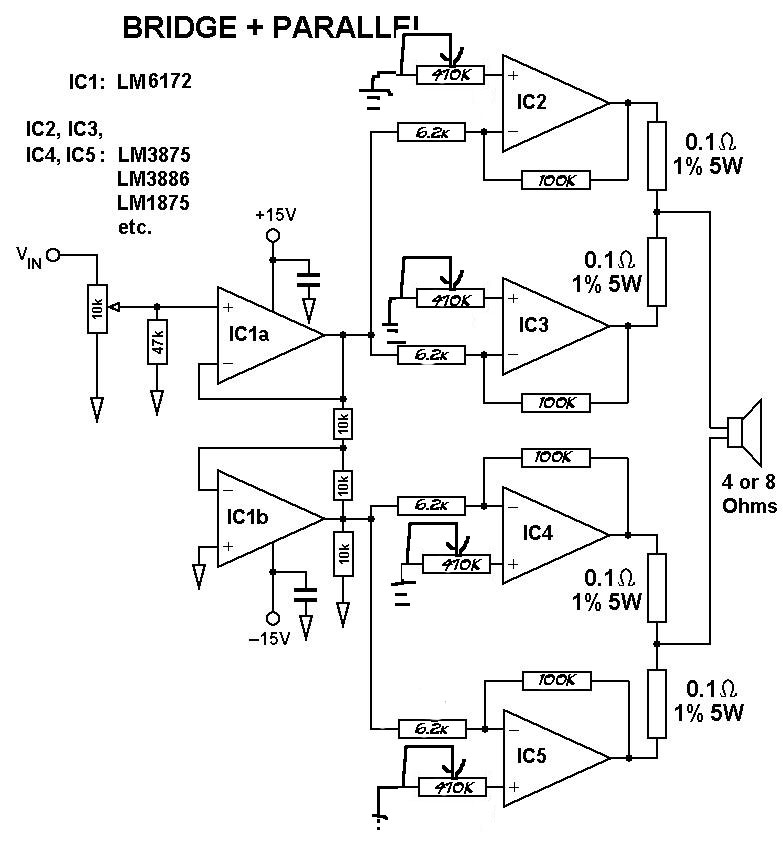

Have tried trim-pots for nulling DC-offset, but something does not add up....
I did de-solder the output-resistor, and null each chip (some variation here), checked and fine-tuned after 30min.
Then re-soldered, and now I have ~20mV ? 😕
It seems that there is a difference when adjusting towards ground and between chips. What gives?
As mentioned...the production-spread among these chips are larger than life...

Koinichiwa,
First, Jeff Rowland uses 0.5R Output Resistors, worth going up to anyway.
Secondly, I suspect there are some interactions between the chips. Try nulling offsets with the chips connected normally and repeat a few times while the Amp settles it's temperature. It is clear that JR does not employ Servos (he seems to share my dislike for their sound) and if he can so shall we DIY'ers.

Re: am I right?
Koinichiwa,
Wrong. In your case use a 470K (18 turn) Pot. in all seriousness, for your schematic a dead short ot 22k will make little difference.
Sayonara

Re: thanks, Kuei Yang Wang
Koinichiwa,
If you like the sound of th OPA's /
YOU will need around a 10K multiturn offset trimmer, as you do not employ a DC blocking capacitor in the input to each chip.

Koinichiwa,
popes said:what do you think about my project?
opa548 3pararel bridge(use 548 6ea for one chanel )
popes said:i will use input R 6.2K ohm
feedback 100K ohm
offset null 470K ohm (multi turn)

dc blocking capacitors
i will use input transformer lundhal 1544A
if use transformer , is the DC block capacitor necessary?
thanks Kuei Yang Wang
Re: dc blocking capacitors
Koinichiwa,
No, but leaving it out means the value of your offset trim resistor changes, that's all.

Re: another question..
Koinichiwa,
Hey, I forgot, the OPA's are FET input I think, so you cannot null the offset the same way as on the LM3875/3886. Simply use 0.47/0.5R output resistors, ground the non-inverting input and hope for the best.
If they are not FET Input your Pot needs to be around twice the value of all the resistors that are not DC blocked on the inverting input in paralell, so in your case 6k2//220k*2 = 12k - NPV is 10k.

Re: Re: another question..
i using opa541, what value should i use to zero the offset?
Kuei Yang Wang said:Koinichiwa,
Sayonara
Mad_K said:547/8/9 have bipolar inputs. opa541 have fet input
Koinichiwa,
Yeah, Sure. But it adds a load of components and potential noise sources. Other than that - it will work for any chip, J-Fet input or not.
