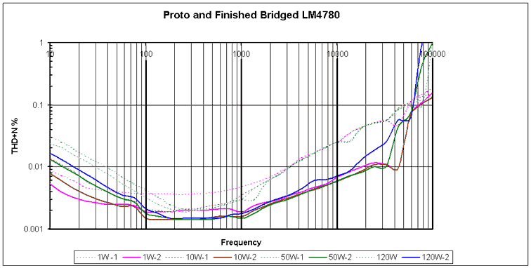

if you are going to build this, don't attempt Vectorboard, you definitely need a PCB (the pins themselves are only 20 mils, the spacing is quite compact):
this is a "fair" idea of what the PCB should look like:
I've had some proto's burned, they just arrived so haven't been tested.
populated board
here's the board -- with humongous PP caps:
New Boards
they just arrived so I wired one up:
here's a graph of the proto-Bridgeclone and the newer version --
changes -- the snubber resistors were changed to 5.6R from 2.7R, the layout is a little cleaner -- the power supply for both test amplifiers were identical. the distortion at 1kHz was 0.0019%, up a tad from the first run.
What is abundantly clear after testing this amplifier at 100 watts is that you can't kid around with the heatsinking of the chip in the bridged version. Machine screws are not sufficient to get the best contact between the chip and heatsink -- you have to use a fixture which compresses the chip against the sink and thermal grease.
