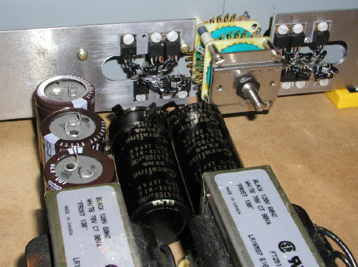

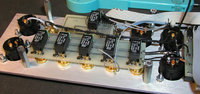

I don't have a schematic, only artwork which I posted earlier. It's pretty easy and you can figure it out. Here is a picture from my other preamp with similar relay switching. I'm switching both ground and signal. Recently I've read on Dynaudio preamp, and they have all the relays active all the time, except for the one which is switching the source. It seems like even better idea.
I pick my relays on sale, and always look for quality ones. Those I've seen in FM Accoustics equipment and since they Swiss made I thought they must be good.😉

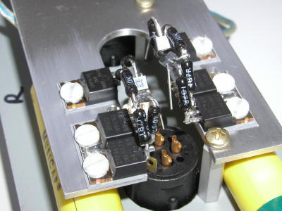

The copper plate was a piece of scrap I had. Since the casing for preamp was done out of 1/16" sheet metal I wanted to reinforce the bottom were the transformer was mounted . It also provides the shielding for equipment which might be located below.

Here is a layout. Just use positive side of power supply http://www.passdiy.com/pdf/balzenpre.pdf BBOZ and P1.7 are using very similar supply.
You preamp will work balanced with RCA input. So how we arrange relays shipping?😉
