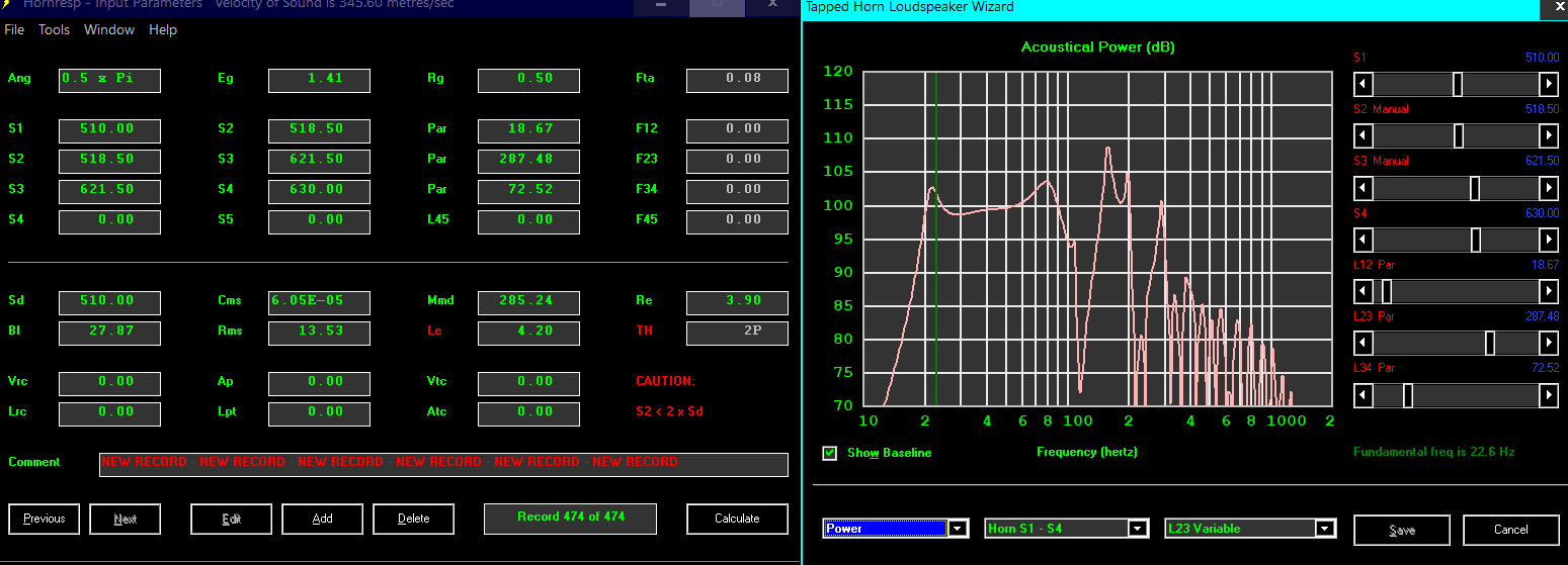

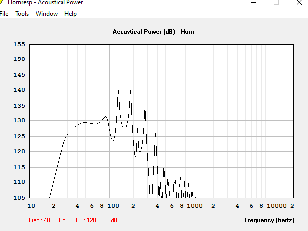

Even more so as HR doesn't take all losses into account, i.e. the measured responses of a typical TH sim's strong high Q peaking tends to be flat to slightly over damped, so if simmed over damped.......I wonder if this somewhat over damped lossless sim might be kind of light on the low notes in reality?
That said, if tuned lower and in a corner can be a fine performer.

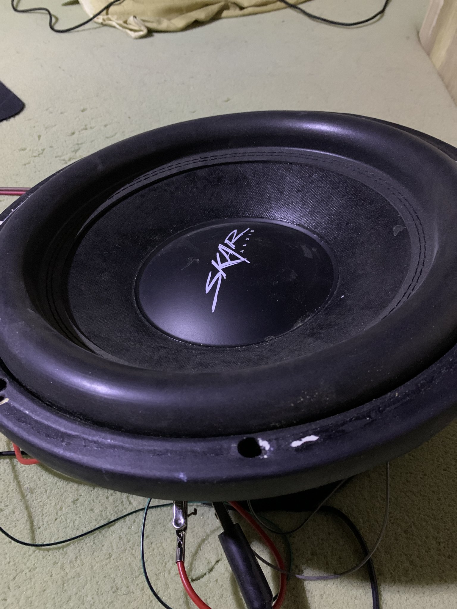

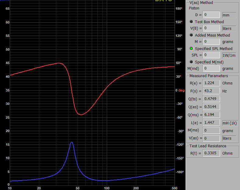

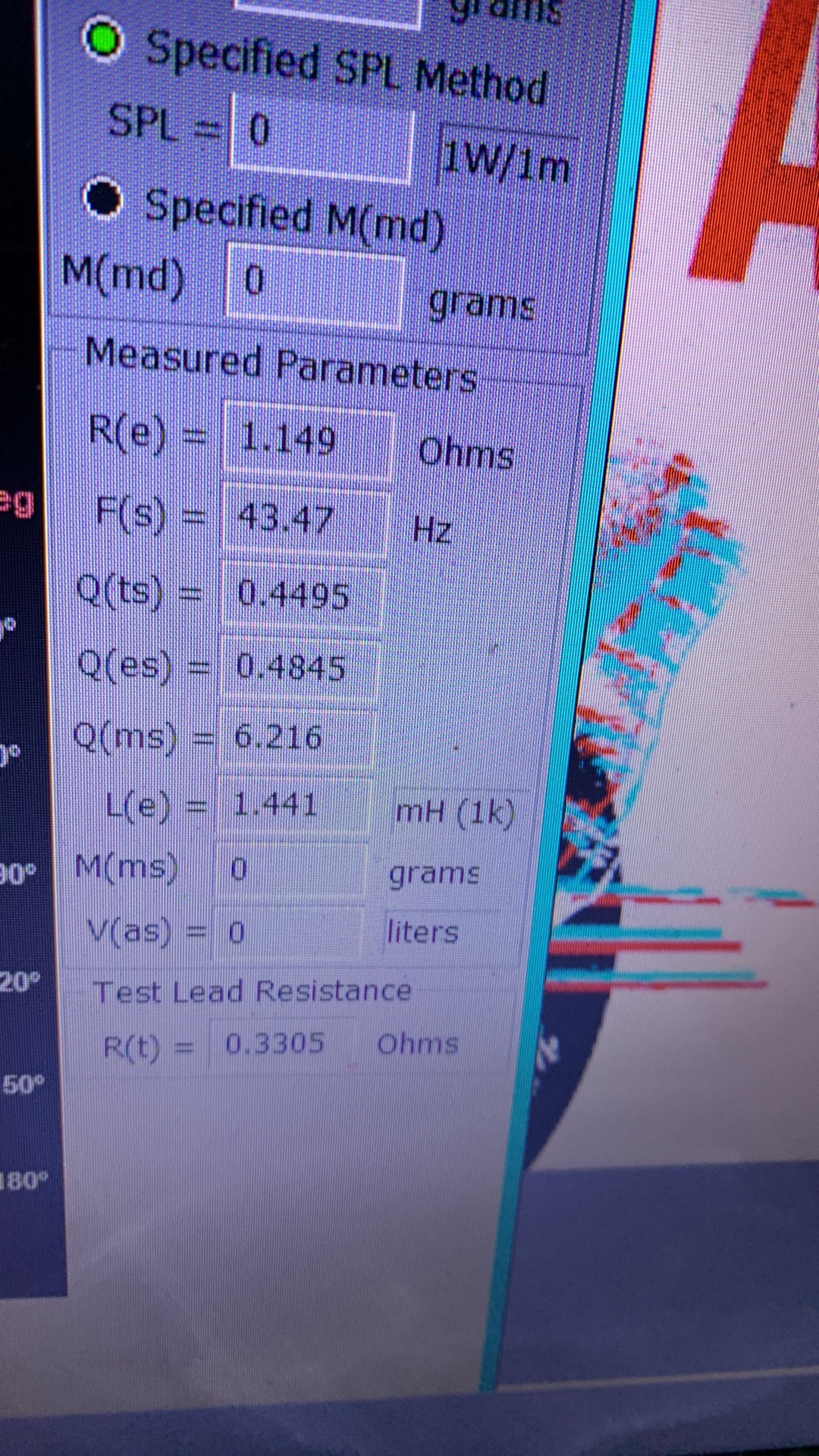

It’s fine, I’m surprised. It got beat pretty hard in that obnoxious high compression (175cm2–> 550cm2) low tuned Resonator paraflex screamer. Really fatiguing to listen to…So that's the real parameters..or you fried the driver 😜
the Fs is 5 hz higher than ASSumed and the Qts is about 0.1 higher. I broke my scale while manufacturing ecStacy pills laced with viagara or I’d measure the Vas to see if it’s still tight 😝

This dual corner loaded DDx12 OTOH using filters to roll off its peaking a bit...........
Understood, it's just a sim graphically showing some info I posted to BW.Well for me corner load is not an option
