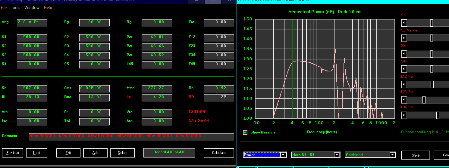

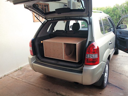

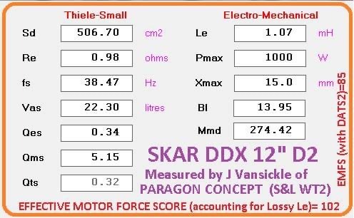

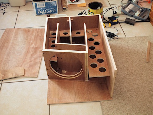

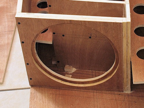

Brian Steele's tapped horn with Skar Audio DDX12

FWIW, one of the things I've noticed is that rather than designing based on the driver's fhm = 2*Fs/Qts' they just seem to fiddle with the sim till they get something that looks good and often don't allow plenty of 'wiggle room' WRT thermal power distortion hence the 'higher resonance funk' due to too short and/or large enough pipe, though of course those folks that make/test a prototype and mods the design based on destruction measurements will wind up with an excellent performing system.
Reactions: Booger weldz
My first ā€˜paraflexā€™ builds sucked, but I ignorantly used ~ 300 cm path connected to ~75cm with totally different end corrections, etc.
Nothing sounded good in that area up top that looks Haggered in horn response, but was at i least as bad to listen to , but this driver(skarddx12) didnā€™t help either it seemsā€¦
later, and with more appropriate drivers, 240cm connected to 80cm in parallel and with a series exit of 40cmā€¦. The paths matched up and the tuning/phase /resonace modes seemed to align and Mother Nature was happy I guess ? šŸ˜ƒ
Reactions: maxolini

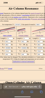

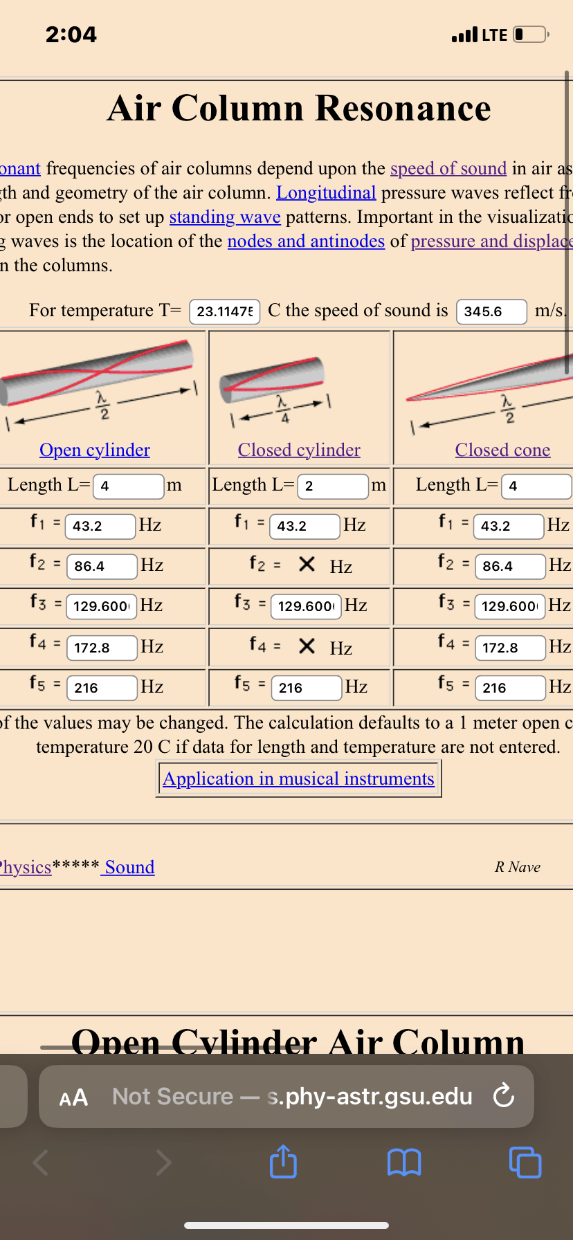

If designing for the drivers upper mass corner should we just sim the 5/4 resonace in an OD TL to that?
In this case , 38hz x 2/ 0.35 as 216 hz (40 cm)
then plug 216 hz into the hyper physics . Com calculator and I find a pipe that length

I haven't in sims nor actually tried beyond refolding a long ago 1/4 scale offset driver BWC other than as an offset 'U' turn when TD gave me some hints in a PM WRT his then new invention (TH).

They certainly stink when driven hard when new, but after that the adhesive smell seems to go away as if it cured or hardened? They donā€™t sound very good regardless, I think the tight suspensions and high order qw designs cone control is an akward combo? Thereā€™s no denying the SPL though?
