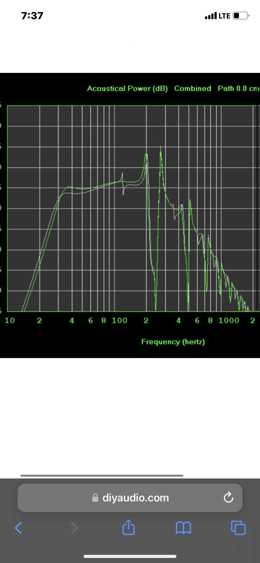

Briefly Simulating both of these kind of points out the similarities between the two . Creating an offset driver is kind of pointless or redundant on the same box volume (?) That extra panel might as well be a brace instead as it changes very little and might even create a little hiccup at that second pipe resonance it creates ?

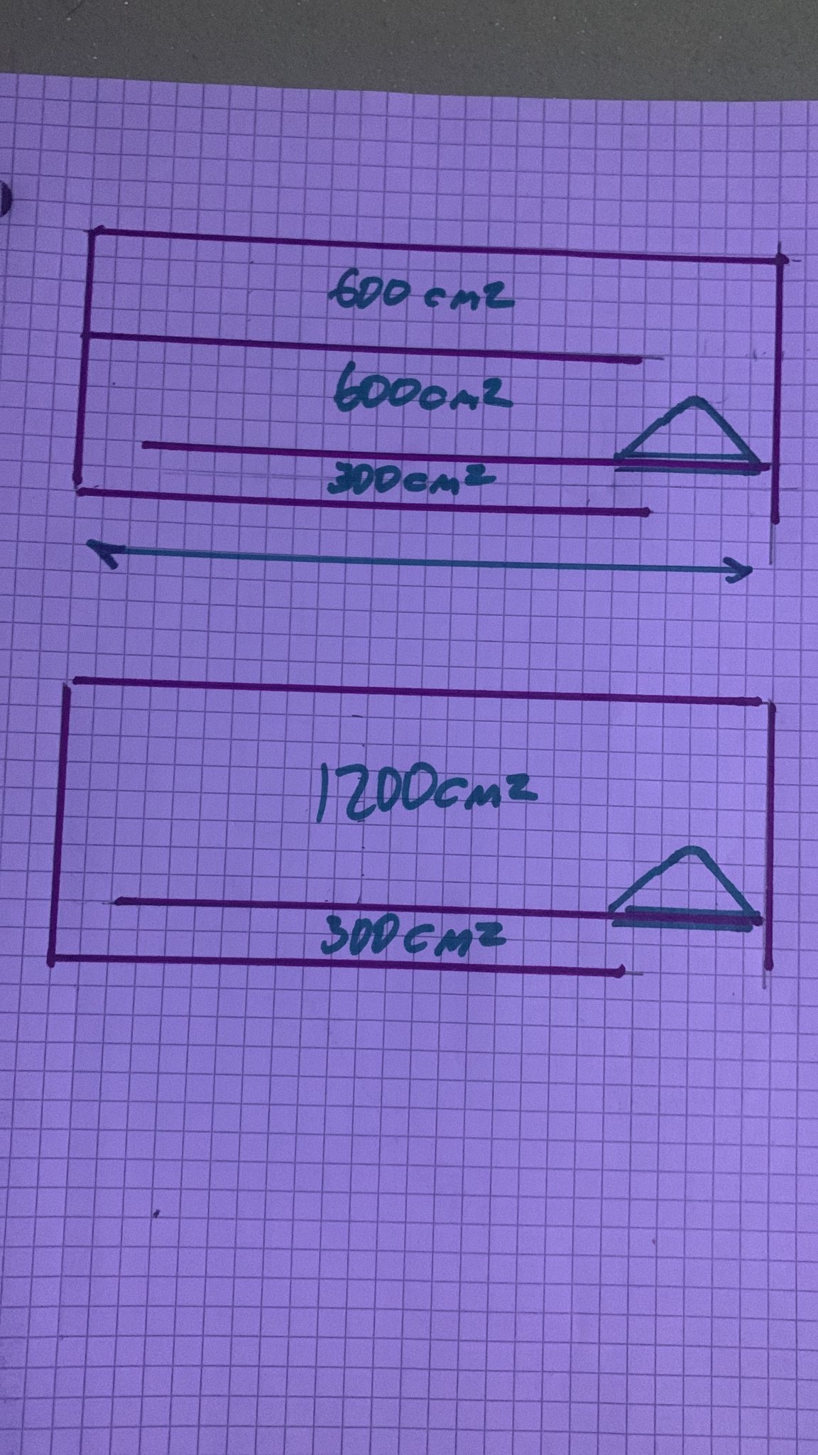

I think the non parallel walls are a good thing. I think it helps to tame the harmonic cancellation in the resulting FRDo you think there might be an advantage to the folded smooth tapered design verses the folded abrupt CSA reduction?

@camplo , I noticed that in the simulation when there’s a taper, the cancellation notch gets partially filled in. I wasn’t sure if that was just a math artifact or something real that we could actually notice by measuring. Everything is pretty spot on and obvious if using straight rectangular geometries it seems

If I follow, then maybe my latest response will be a sufficiently extreme example as to which is best overall. 😉Do you think there might be an advantage to the folded smooth tapered design verses the folded abrupt CSA reduction?

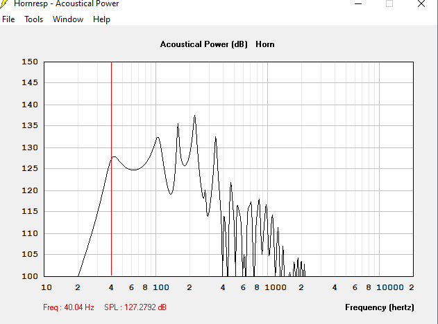

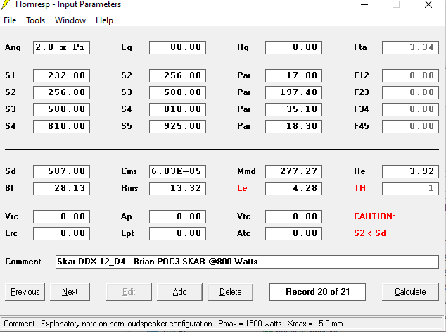

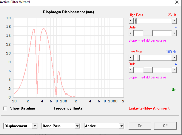

Hey, so i compared the POC3 vs the PAL12 with the same SKAR DDX12
and POC3 is hands down best suited for the DDX12

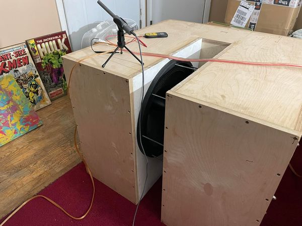

so, i know is a sacrilege to even mention to build one with 15mm ply instead of 18mm ply
but, can it be done ?
is it realistically possible or the extra bracing will ruin the weight drop from 18mm to 15mm ply
in the other hand i want to make one POC3
hope Brian chime in and comment if there is anything that need to be changed like a dimension or 2 on his POC3 plans

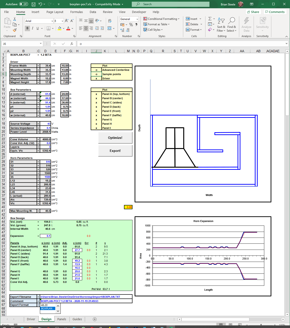

this is what i copied from his webpage for the POC3

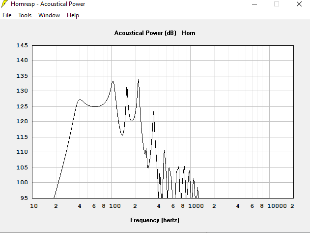

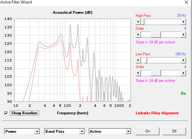

and i simmed a skars DDX12

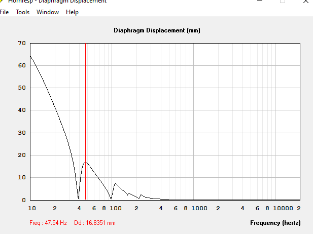

And tweaking the Horn Length to 334cm we get 30hz response

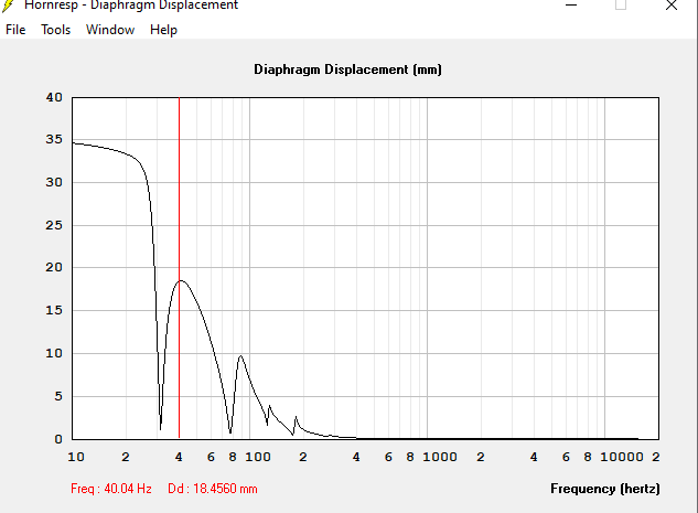

even we hit 18mm xmax on the driver but somebody here pointed that you can go +/- 20% of xmax ?
Altough with the filters engaged we are within limits for 800watts

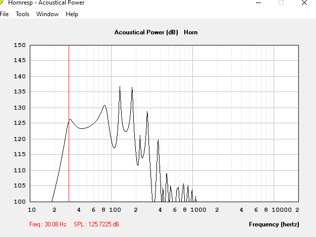

make one out of scrap wood/mdf to test?
Dont try to tune it below the mid 30s, it sucks, fs 38-40hz, Qes in the 0.35 ish range … It had no deep extension/low note authority in the ‘paraflex’ designs we built, maybe this tapped horn will be more ‘underdamped’ at Fb And liven it up?

What you Think Brian, do i dare to tune the thing at 30Hz or leave it untouched for the DDX12 ?
With the Ciare 12.00SW-8 @1250watts we have the below
it is rated at 14mm XMAX so 16.8 qualify within the +/- range ?

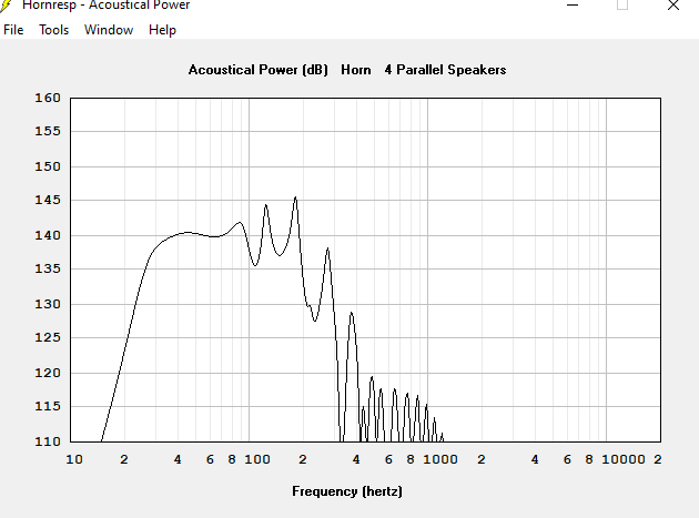

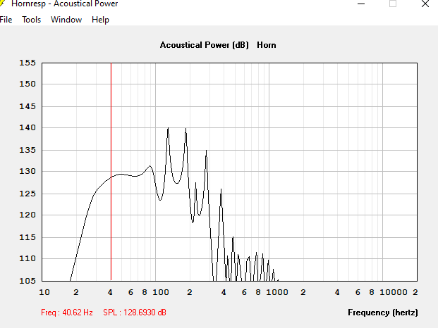

well... not that much !!! so with 4 DUAL loaded POC3's with DDX12's we have... lets see.....
Not Bad!! at All !!!! Weeeee !!!!
https://www.skaraudio.com/products/ddx-12-inch-car-subwoofer?variant=DDX-12 D4
right now they are at 157 so 314 per cabinet... times 4 ? 1256 !! not bad a QSC KS118 is 1999
and will not hit 140db ( yeah 1256 plus the amps and processing and the plywood )
but you get the idea.

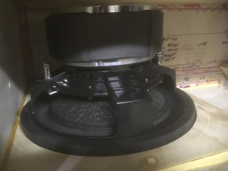

a friend replaced the ddx12 with those in a 4 x 12 parallel resonator design and it sounded much ‘WarMer’
