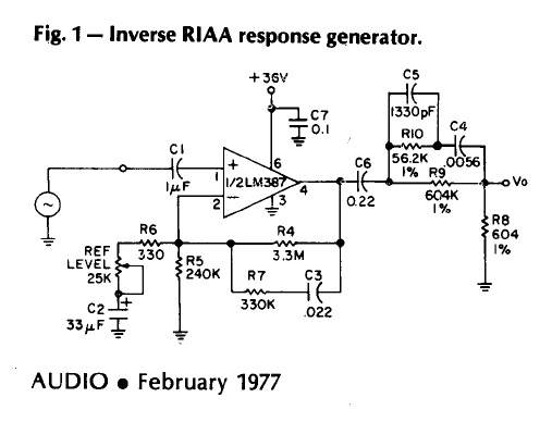

That would mostly be bass input to the phono preamp. You have to inverse RIAA a line signal
to get a proper spectral balance for a phono preamp burn-in.
I recommend to write a CD with white noise signal. Its spectrum will resemble to a RIAA pre-emhasized pink noise, which in turn closely resembles to a general real music content. Then play it in repeat mode through a 100:1 resistive divider.

Since capacitors used for this sort of circuit don't need breaking in, yes, play the records.
However you can run some tests on a preamp via an inverse RIAA, such as distortion and frequency response measurements, before adding in the extra complication of vinyl and its imperfections.
There's also the very valid reason that you can check for thermal issues running the amp for prolonged periods while measuring/listening.

I think I've posted the '77 image somewhere else on diyaudio.
Refer to posts above.
