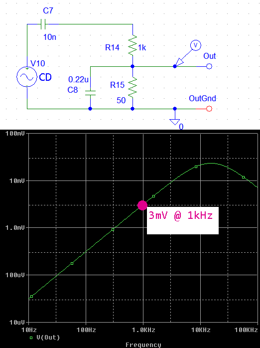

I have a Diy MM phono preamp that I want to use a cd player to break it in. .....
If you want to listen to it: build an inverse RIAA, that's what it is for.
If you do NOT want to listen to it, and just want a "needle-like" signal to vibrate any loose bits inside your caps, you do not need great precision but you do need a major slope (so- not just "a resistor on the cable"). A single C-R would do, but with huge supersonic signal which _I_ don't like to do to my audio gear. A couple more parts (LOW tolerance is fine) makes an iRIAA-like slope of appropriate level.
Thanks for all help.
I will build the inverse RIIA, and also inklude a volumpot in front of it so I can use my ear to check if the signal in to the phonoamp is correct.
Frode
