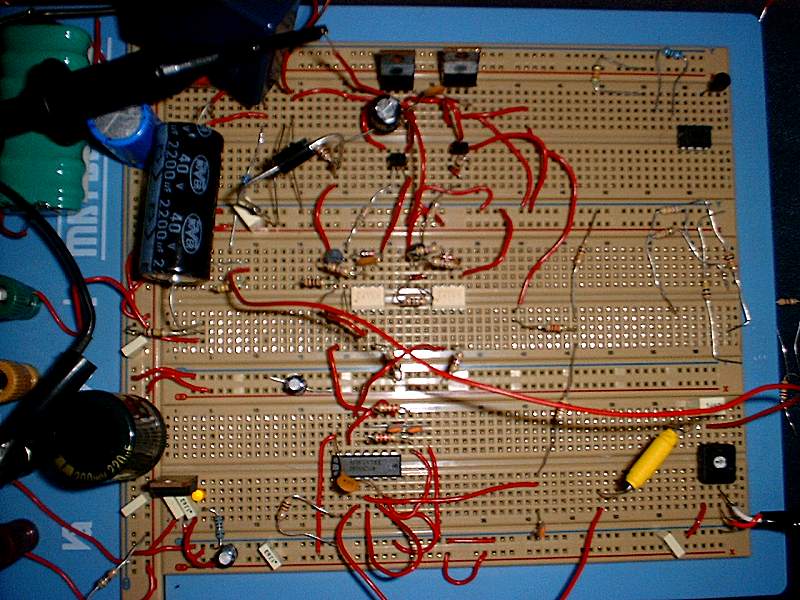

I've prepared the schematics for the new oscillating amp, also got some piccys of it for your amusment. Take a look and let me know what you think:cannotbe:
The amp is still in test configuration using a single rail 12V supply. You will notice the 6n137 opto couplers in there. I now have my hands on some high speed magnetic couplers. These will be in by the end of the week and i will also convert to split rail when the drivers are proved to be reliable. The sound as it sounds is fantastic, it can only get better!

This is a general view of the whole amp. The rats nest of wiring does not seem to cause any trouble with RF interfering with the sound. It does tend to knock out my DAB reciever just out of view in the first photo though 😀

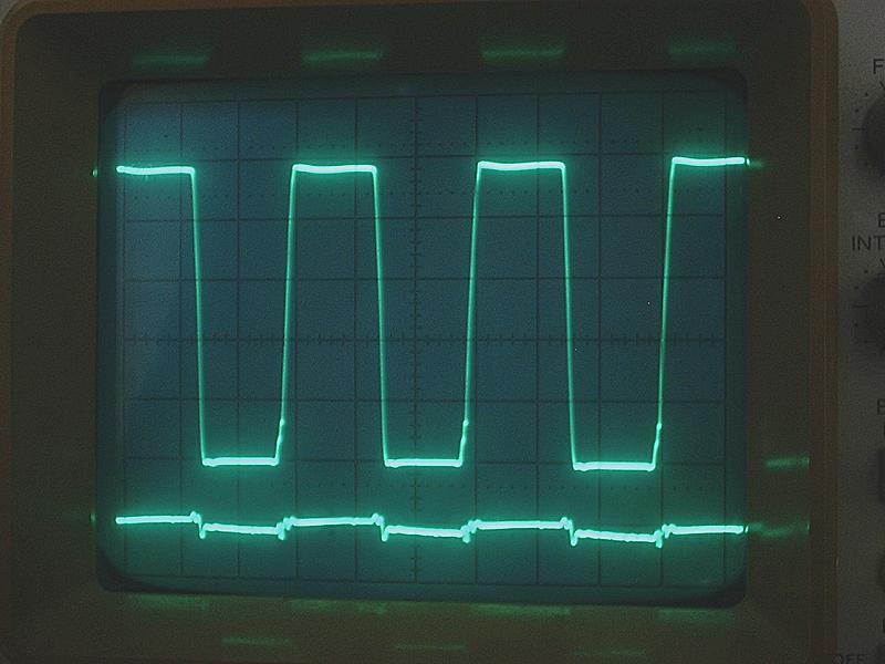

Here you have a view of the high side fet's gate wavform along with post filter bridge output ripple below it. The scopes timebase is set to 500ns per division and 5V per division for the switching waveform, 1 volt per division for the ripple. The bridge waveform is identical to that of the high side gate drive. The scope is referenced to ground so befor any of you tell me i'm ramming 24 volts into the gate remember that the whole of the high side fet is bouncing up and down along with its bootstrap riding on the bridge output wavform.

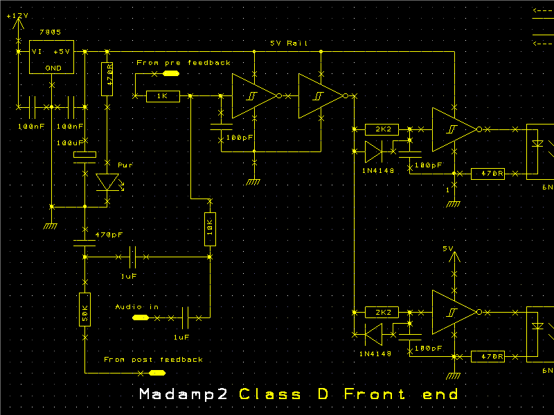

Here i present the schematic of the front end of the amplifier. If you look at the circuit you will notice a very large dead time has been programmed. I have done this to eliminate shoot-through on the fets caused by a massive 100n/s delay in the optos. The programmed time will be reduced considerabley when i exchange the optos for magnetic couplers😀

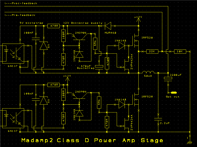

And finally the buisness part of the amp. Not much to say here, it seems perfectly stable at the mo, i've been using the amp in this state over the past few days now without any problems. The sound quality is crystal with surprising helpings of bass for the size of the supply. The noise floor is so low that there is virtually no noticable hiss when operated in open loop mode. Distortion has yet to be determined but i cant detect any at all just by listening with my ears. The comparater and pre-amp or lack of them will be inserted later when i split the supply. I have some high speed comparaters from maxim waiting.. also some new op-amps from the same source. I think that the amp will be a mighty warrior after all this is done........ Let me know of your thoughts....

There's several anti saturation techniques which can be used, but the one known as "baker clamp" employs a schottky. If you want to use sic diodes at least two are required.
I'd expect more noise and heating when you go beyond 12V, or +-6V, but this is an excellent start.

The schematic i posted for the amps front end has an error,
I forgot to include an inverter in the lower fet drive. This is one of the spare logic inverters and must be used in between the lower fet drive inverter as drawn and the opto it is wired to. As it stands now the fets will both be on at the same time LOL:dead:
